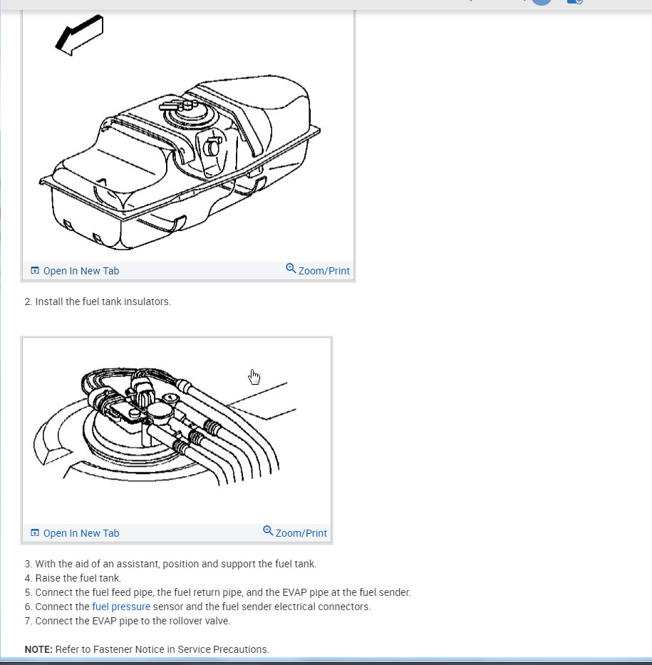

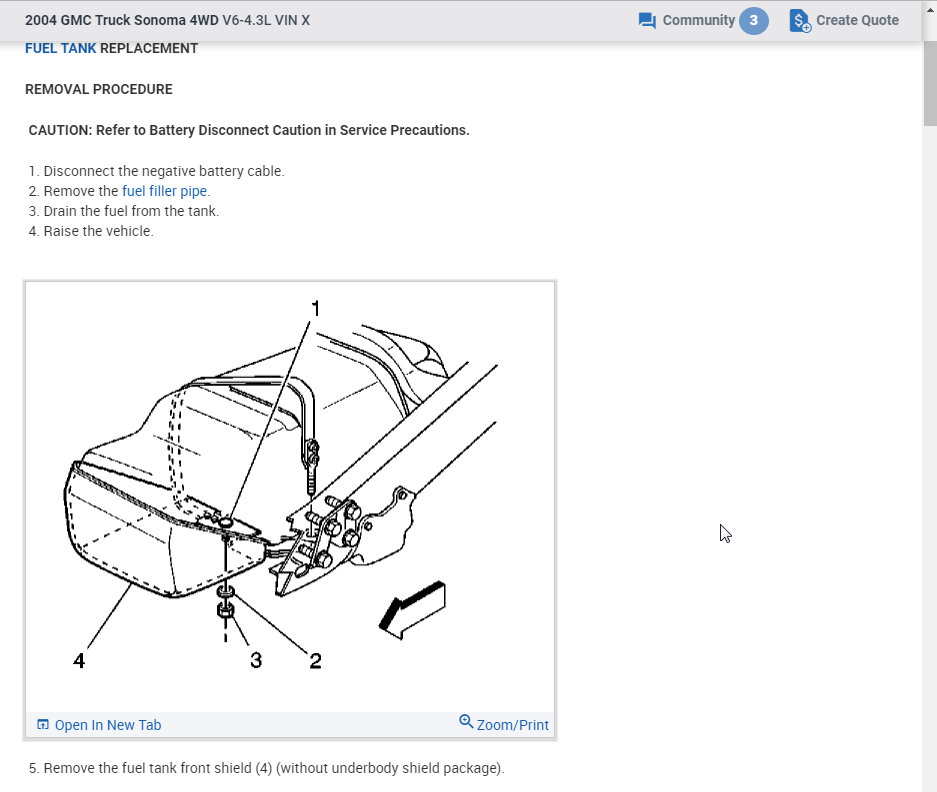

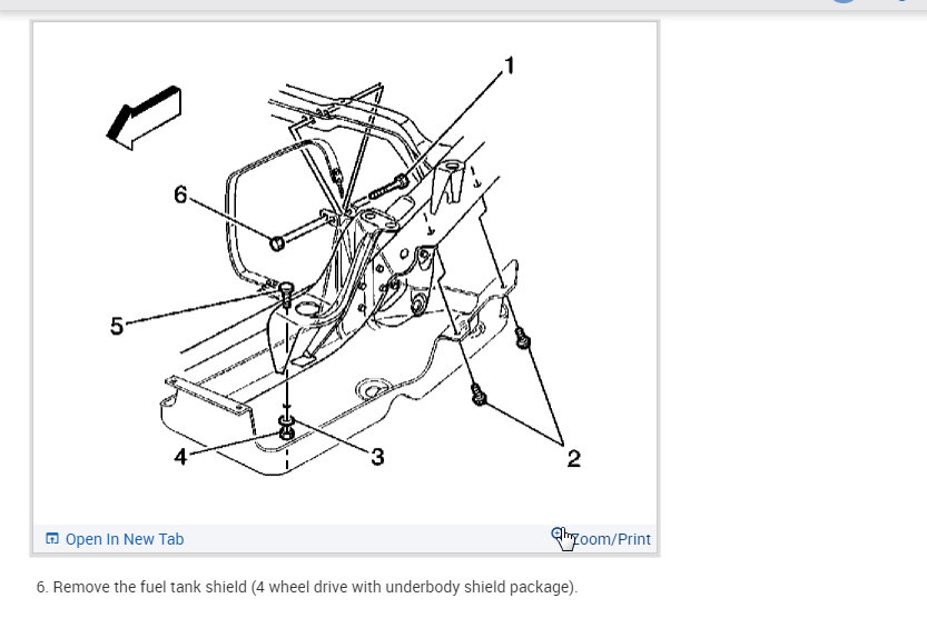

Truck listed above is a crew cab. I am trying to remove the fuel tank, I have the straps undone and there is a support that still holds it up. I'm worried the bolts will snap and wont be able to use support any more. Any ideas if I have to remove that to remove tank?
Dec 9, 2019 at 7:49 AM
Here is the process on how to remove the tank for your vehicle. Let me know if you still have questions. Thanks
Dec 9, 2019 at 11:39 AM
JUSTIN DUNN

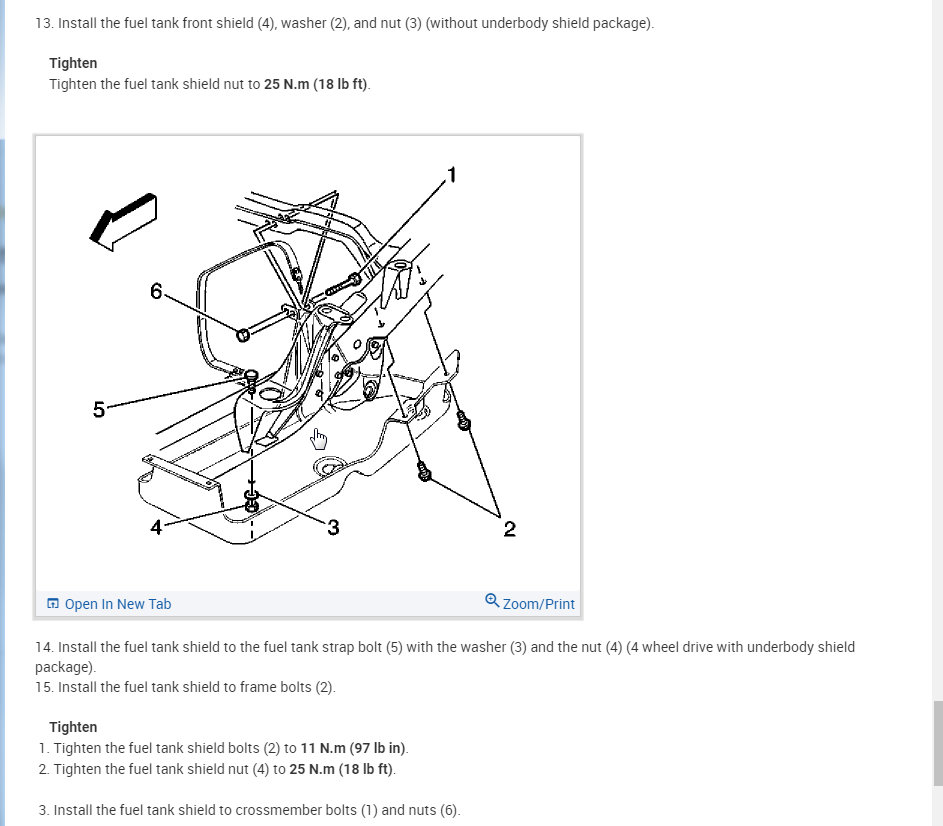

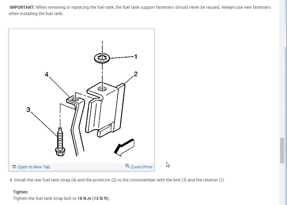

I have the straps all undone now its seems like crossmember has to come off or is there another way it's what you guys show as front strap
Dec 11, 2019 at 2:37 AM
JUSTIN DUNN
I got the same answer how do you remove cross member
Dec 12, 2019 at 3:04 AM

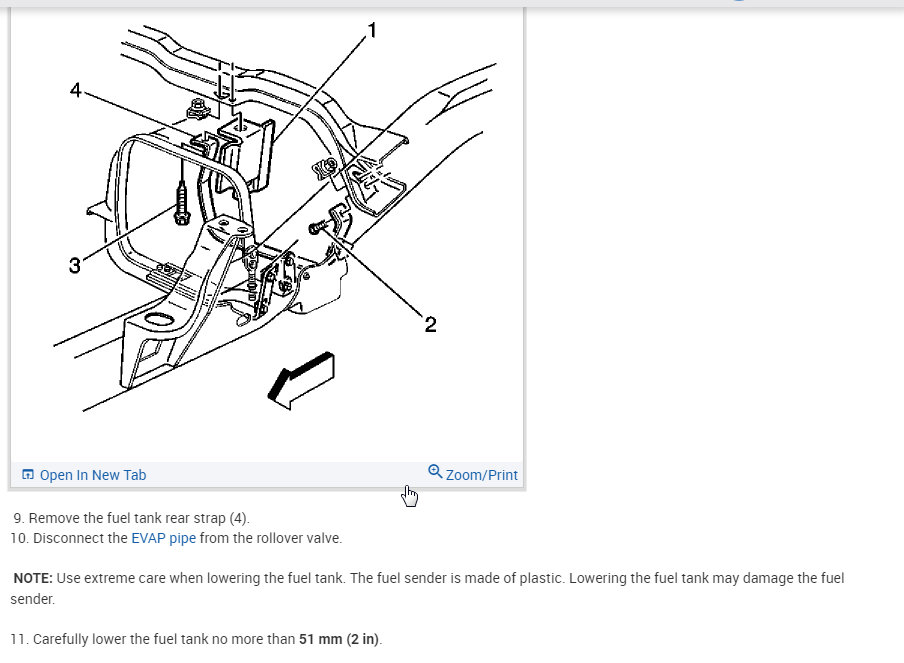

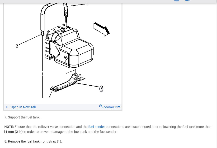

I think the bolts you are looking for on are the frame adjacent to the tank.
Dec 16, 2019 at 3:42 AM

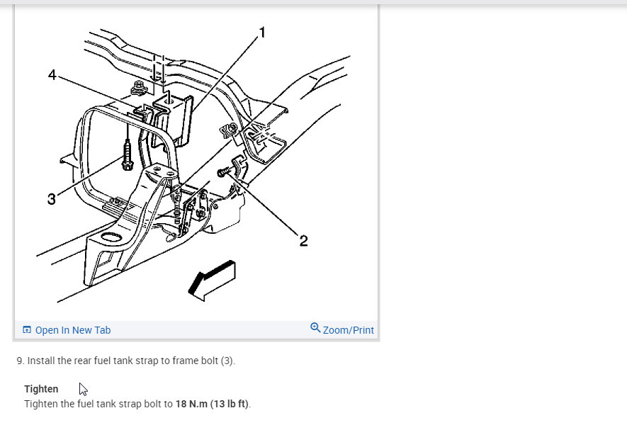

JUSTIN DUNN

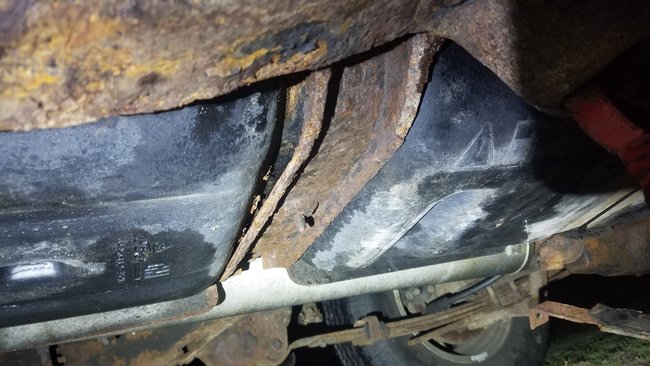

yea is there 3 or 4 because the one goes to the shackles and don't want leaf spring to fall.also i am doing it on the ground so not much room.
Dec 16, 2019 at 11:06 PM
  • 55,112 POSTS
The guides danny uploaded look very complete the tank came down no problem today so I'm not sure what doing on for you. Can you take more picture to help us see what's going on or a video? Upload both in your response.
