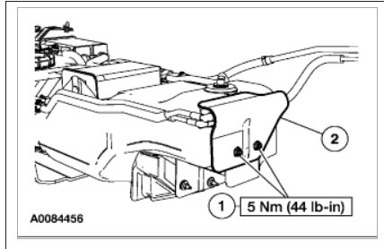

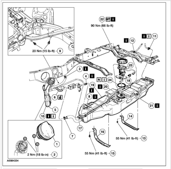

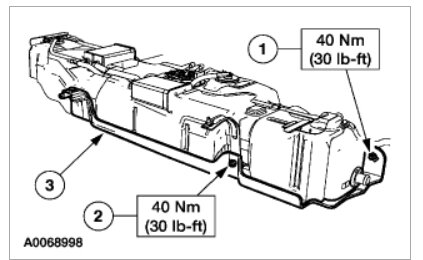

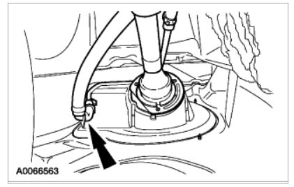

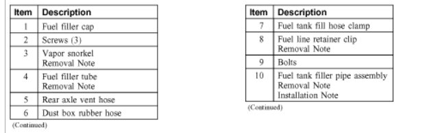

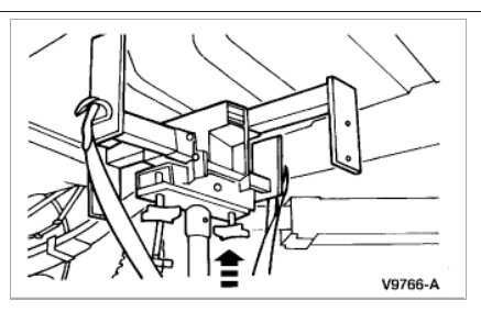

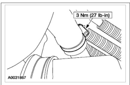

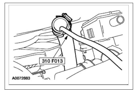

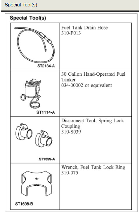

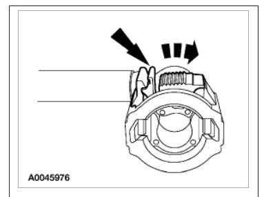

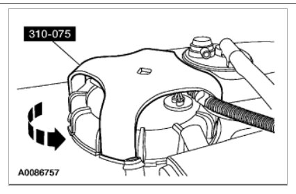

Yep, the fuel pump is to blame and is the only thing I have heard of that could cause such a problem. Here is a guide to help you change it out or see what needs to be done when doing the job. Here is how the job is done so you know how to do it or what you are paying for.
Fuel Pump, R&R 3.0 hours@ shop rate plus the fuel pump.

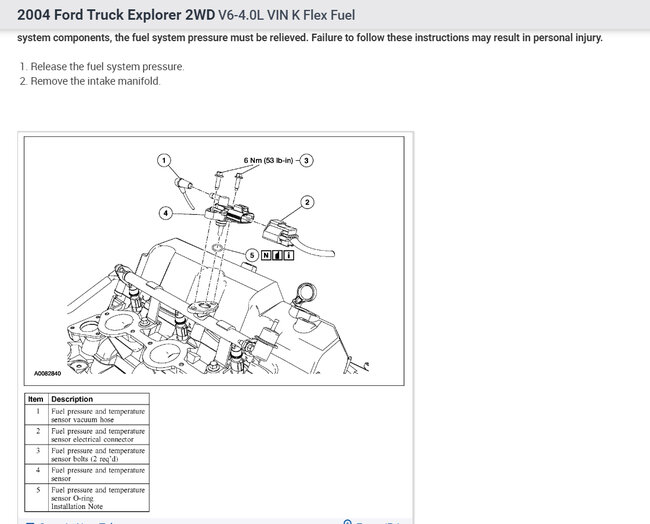

One more question related to this issue, i sometimes get a code P0193 "FRP sensor high pressure" after filling the gas tank and the engine stops but restarts and i drive off. What's this about?
Jan 31, 2023 at 8:48 PM
  • 55,782 POSTS

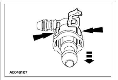

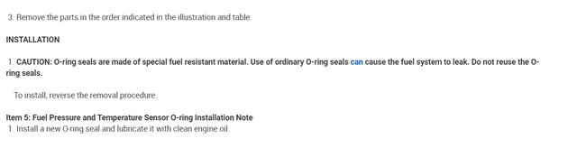

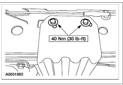

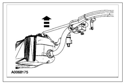

P0193 Fuel Rail Pressure Sensor Circuit High Input. This may cause the problem because it is related to the fuel system here is the location of the sensor so you can replace it to see if that makes a difference. Check out the images (below). Please let us know what happens.
Feb 2, 2023 at 5:20 AM
BROKENEXPLORER
  • 13 POSTS
I needed both a new fuel pump and a pressure sensor. Everything is working fine now, no warning lights. costed about $800.00 for the repairs.
