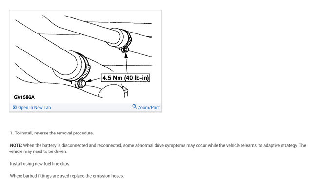

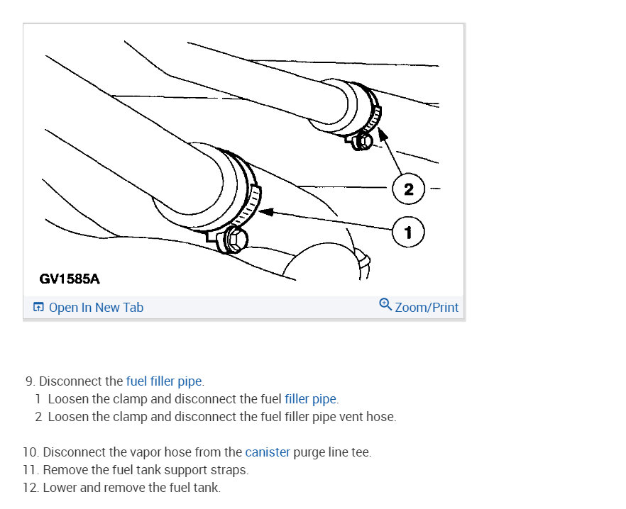

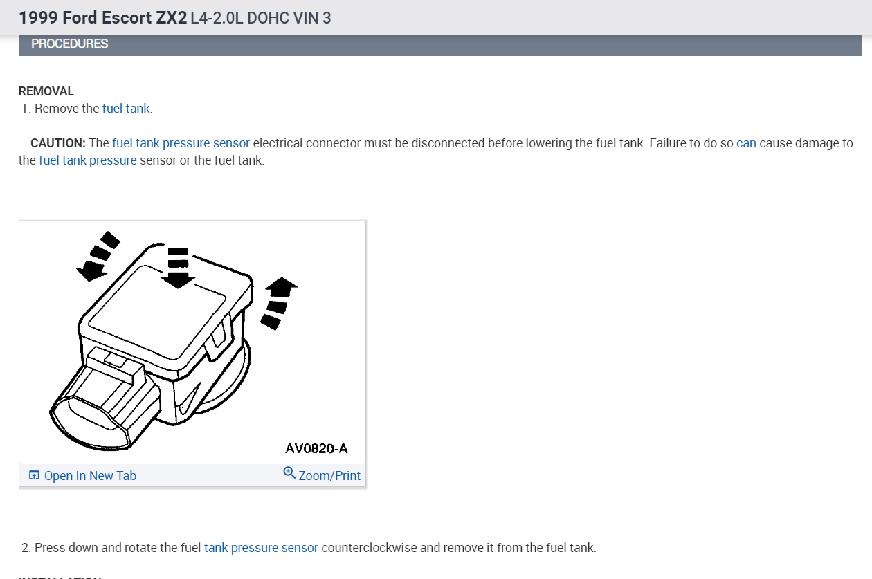

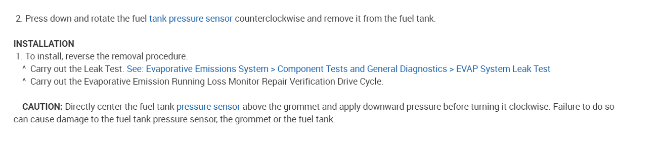

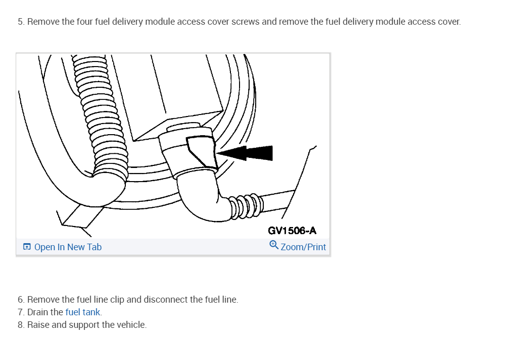

Where is the fuel tank pressure sensor located?
1999 FORD ESCORT
140,000 MILES • 2.0L • 4 CYL • 2WD • MANUAL
LDVE

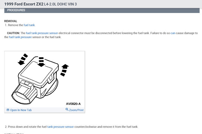

Where is the fuel tank pressure sensor on the car listed above zx2?
Oct 11, 2022 at 12:25 AM
  • 55,423 POSTS

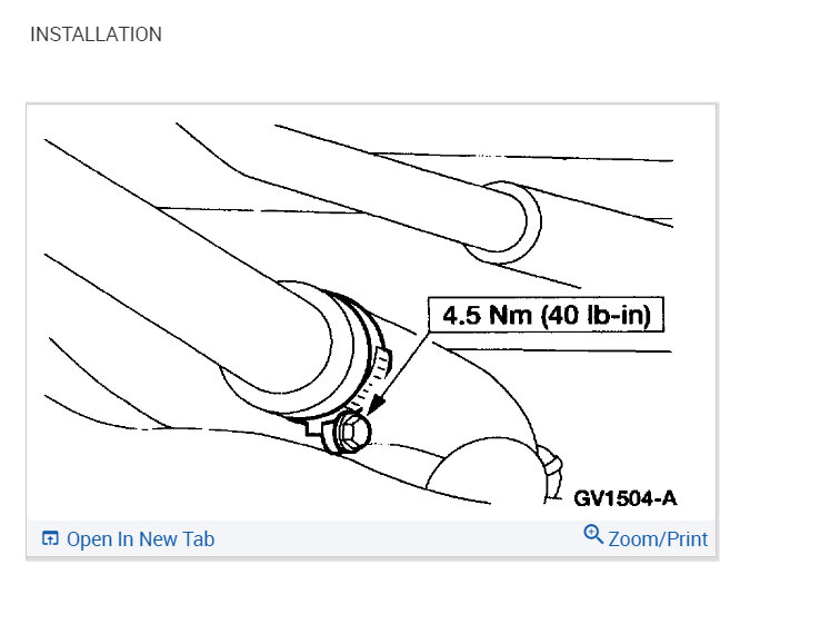

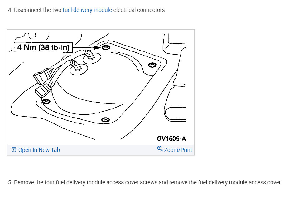

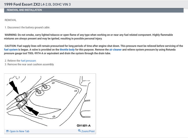

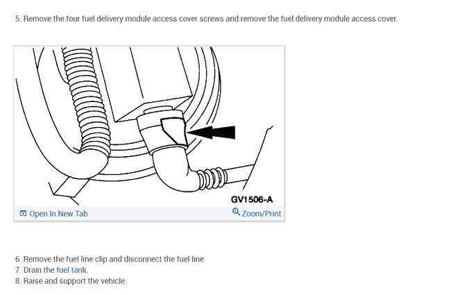

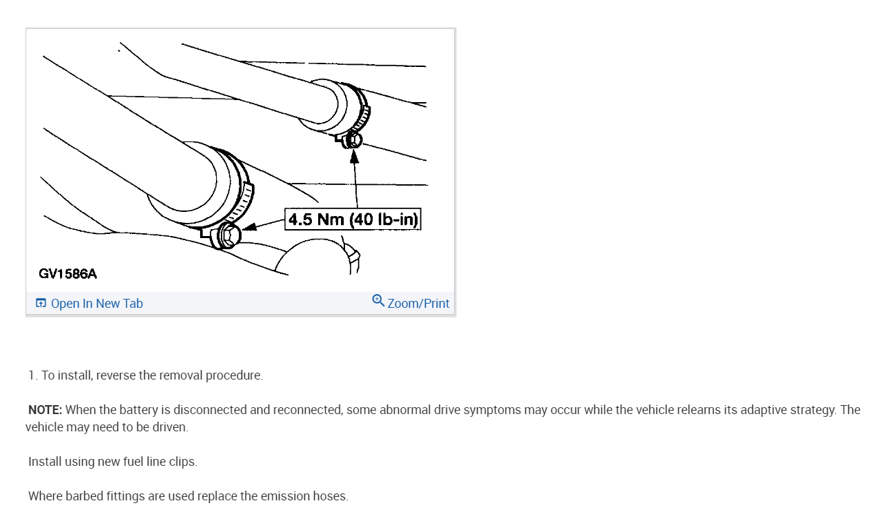

The fuel tank pressure sensor is on the top of the fuel tank. here is a video of the fuel pump being removed in a similar car which has the fuel tank pressure sensor in it so you can see how the job is done. Also, I have included the instructions from the manual on how to change the sensor out.
https://youtu.be/D1AyqeftAmA
Check out the images (below). Please let us know if you need anything else to get the problem fixed.
