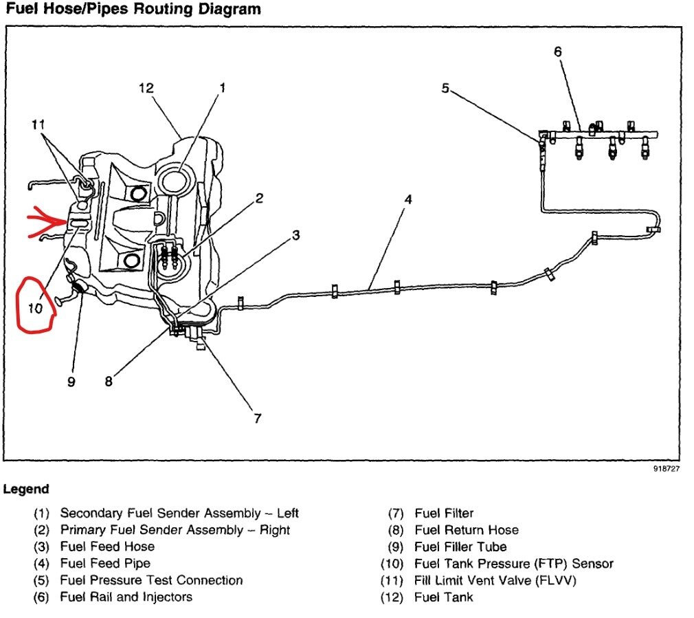

I was wondering where is the exact location of the fuel tank pressure sensor for my 04 SRX. I've checked the the fuel pump and it's not on there or near it. Please help.
Mar 29, 2026 at 8:56 AM
STEVE W.
  • 15,200 POSTS

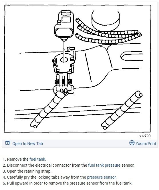

It is in the top rear area of the fuel tank between it and the body of the truck. It has a locking tab that retains it in the top of the tank.
