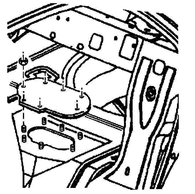

Getting a code PO446 says I need to replace fuel tank pressure sensor. Can you please tell me where this is located in this make and model and level of difficulty in replacing?

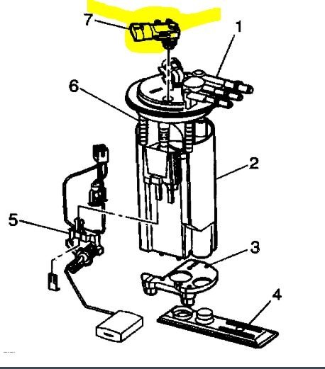

On a scale of 1 to 10, I give it a 3. If you look at picture 1, I highlighted the sensor you need to replace. It is mounted to the fuel pump assembly.
Here are the directions for replacement. Not included in the directions is disconnecting the negative battery terminal before starting. I recommend doing that. You don't want anything that can spark when you are working in this area.

1. Remove the trunk liner. Refer to Compartment Trim Panel Replacement - Rear (One Piece) or Compartment Trim Panel Replacement - Rear (Two Piece) in Trunk/Liftgate.
2. Remove the fuel sender access panel.

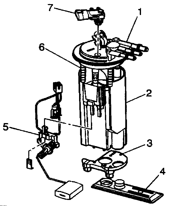

3. Disconnect the electrical connector from the fuel tank pressure sensor.
4. Remove the fuel tank pressure sensor (7) from the fuel sender assembly.

1. Install a new seal provided with the fuel tank pressure sensor.
2. Install the new fuel tank pressure sensor (7) to the fuel sender.
3. Connect the electrical connector to fuel tank pressure sensor

4. Install the fuel sender access panel.
NOTE: Refer to Fastener Notice in Caution and Notices.
5. Install the nuts retaining the fuel sender access panel.
Tighten
Tighten the fuel sender access panel nuts to 10 N.m (89 lb in).
6. Install the trunk liner. Refer to Compartment Trim Panel Replacement - Rear (One Piece) or Compartment Trim Panel Replacement - Rear (Two Piece) in Trunk/Liftgate.
