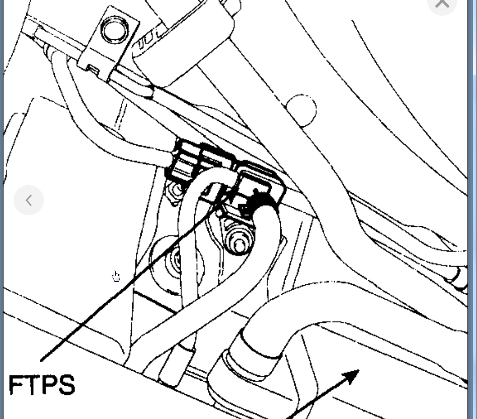

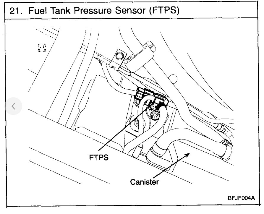

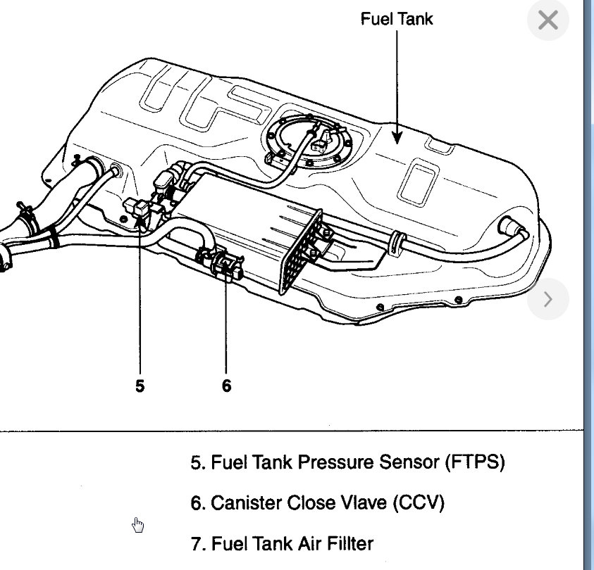

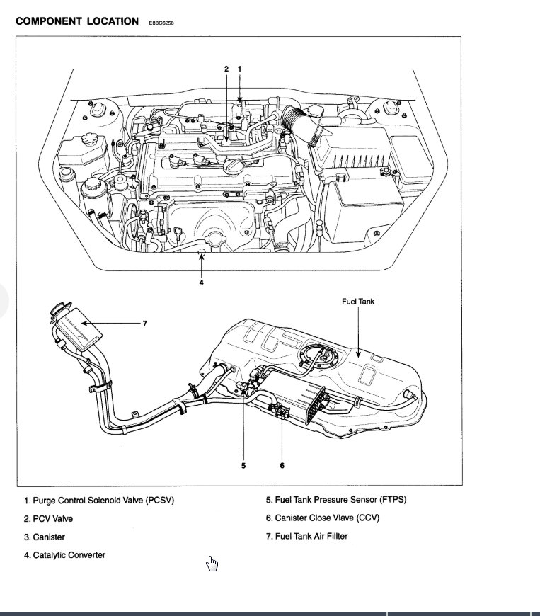

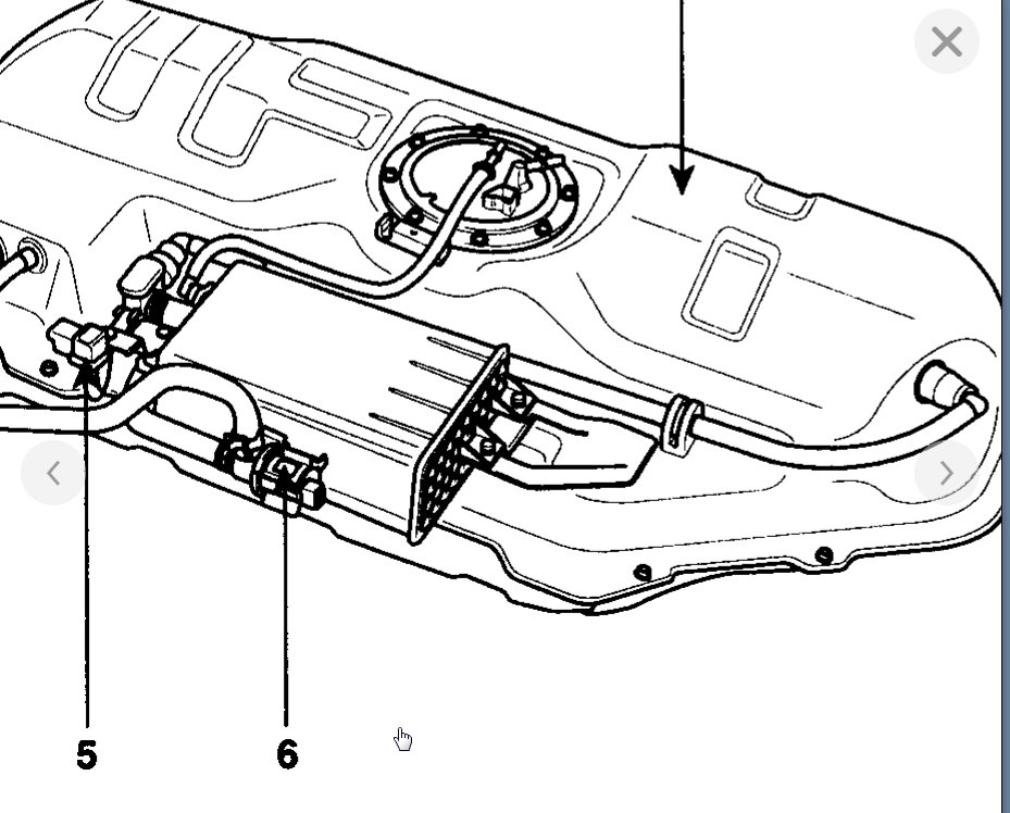

Replaced FTP - there are 2 hoses on the the sensor but one appears to attach to nothing - is this correct?
Nov 9, 2019 at 4:31 PM
Normally they do not remain open to the atmosphere. There is a vent line that runs to the canister close valve but again, they should not just be open to the atmosphere because this is a closed system.
I attached different diagrams of this system. I zoomed into it so you can see each line a little better.
