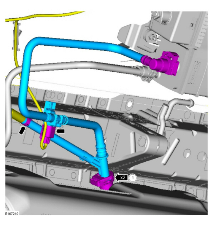

Where is the Fuel tank pressure sensor located?
2018 FORD FIESTA
102,000 MILES • 4 CYL • 2WD • AUTOMATIC
CATINA BARRETT
I'm trying to figure out where to locate and how to change the fuel tank pressure sensor on my car listed above. Any help would be greatly appreciated.

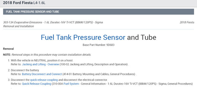

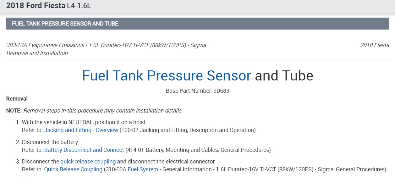

Sure, here is the fuel tank pressure sensor. Check out the images (below). Please let us know if you need anything else to get the problem fixed.
