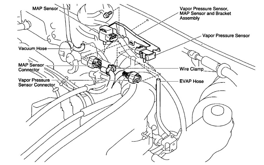

My car is coming up with a P0441 Code. Stating it needs a new Fuel Tank Pressure Sensor. I have the part but can’t seem to locate where it goes. Need help with the location of it. Thank you

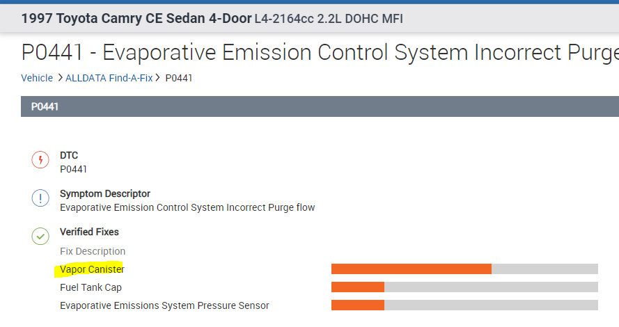

The pressure sensor may be bad, but it is more likely an EVAP leak. The most common repair for this code is the vapor charcoal canister. (See pic 1 below)
As far as the part location, see pic 2 below.
