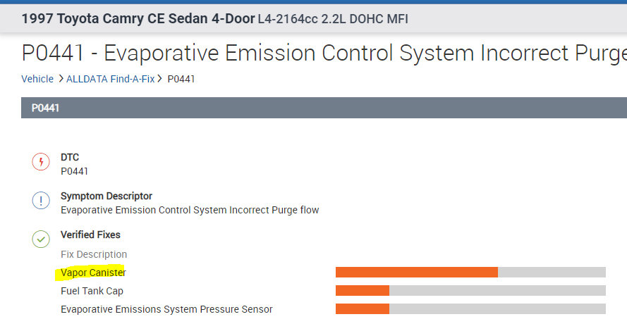

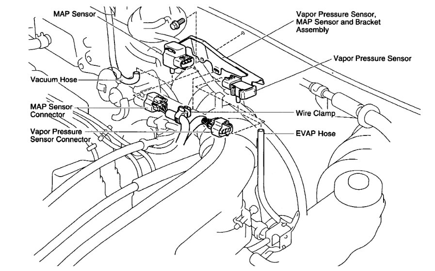

My car is coming up with a P0441 Code. Stating it needs a new Fuel Tank Pressure Sensor. I have the part but can’t seem to locate where it goes. Need help with the location of it. Thank you
Jun 5, 2023 at 4:45 AM
  • 110,244 POSTS
The pressure sensor may be bad, but it is more likely an EVAP leak. The most common repair for this code is the vapor charcoal canister. (See pic 1 below)
As far as the part location, see pic 2 below.
Let me know if you have questions or if I can help in any way.
