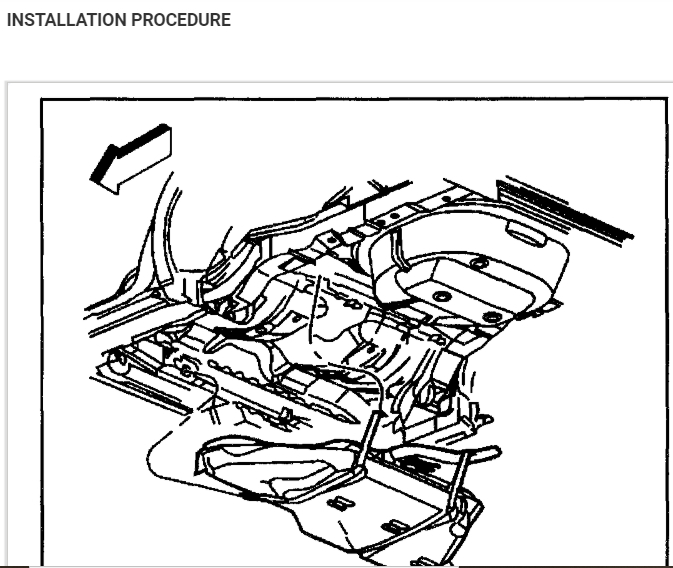

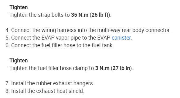

How do you replace the fuel tank pressure sensor on my listed car?
Thank you
May 23, 2020 at 3:08 AM
DANNY L
  • 5,648 POSTS
Hello, I'm Danny.

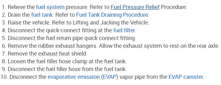

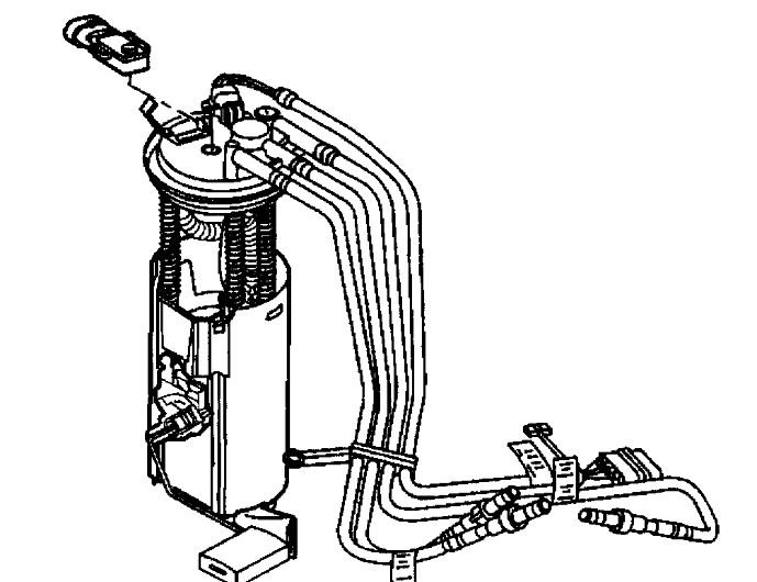

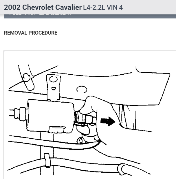

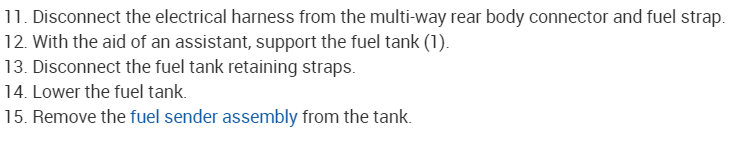

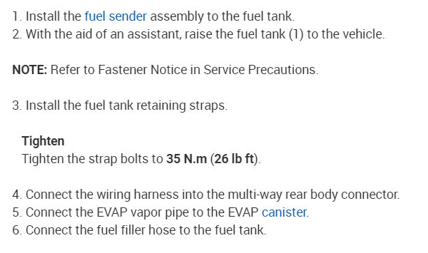

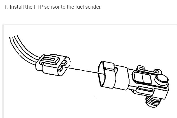

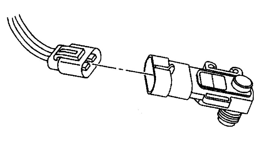

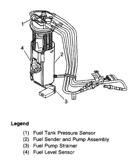

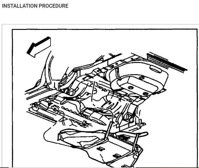

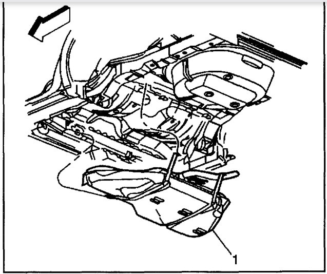

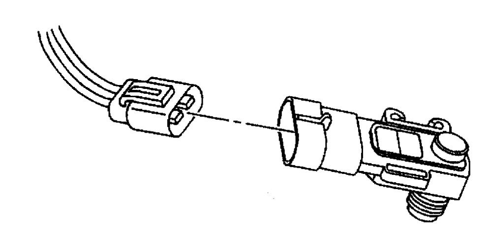

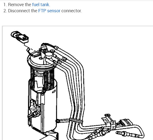

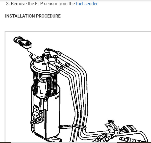

That will require removing the fuel tank. I've attached picture instructions below on how to replace the sensor as well as how to remove the fuel tank for your Cavalier.Hope this helps and thanks for using 2CarPros.
May 23, 2020 at 4:05 AM
Good afternoon,
I attached pictures and the procedure for you below.
Why are you replacing this?
REMOVAL PROCEDURE
1. Remove the fuel tank.
2. Disconnect the FTP sensor connector.
3. Remove the FTP sensor from the fuel sender.
