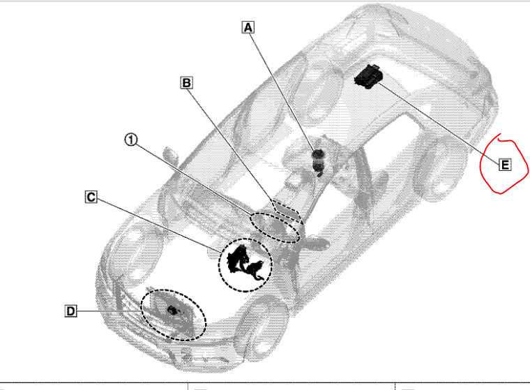

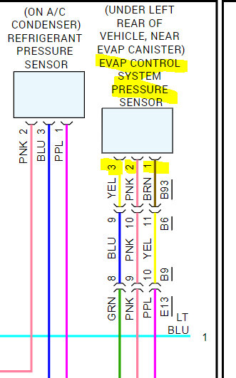

My fuel tank pressure sensor was pulled off after I had a blow out on the rear passenger side. I bought a new sensor and a connector but I'm not sure how to wire it back. I need to know the what wire goes where.
Jul 25, 2024 at 4:11 AM
  • 110,193 POSTS
My manual shows me the wiring at the connector and numbers the connector. However, I can't find a picture of the pin-out.

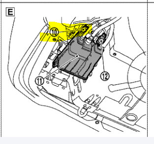

Take a look at the pics I attached. The first two are to confirm I have the right part. I think you meant an evaporative control system pressure sensor. I'm not finding a fuel tank pressure sensor. See the pics and let me know.

Yes, it’s on the Evap canister l. So, this picture of the pin out would be top view right. I’ve searched everywhere looking for a pin out on this sensor and I just can’t find it anywhere, but this is helpful. thanks
