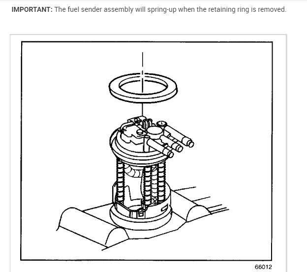

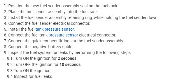

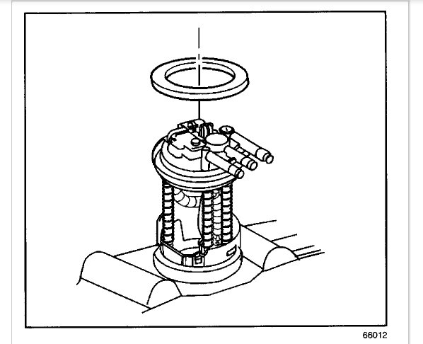

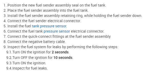

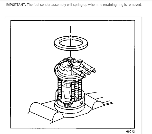

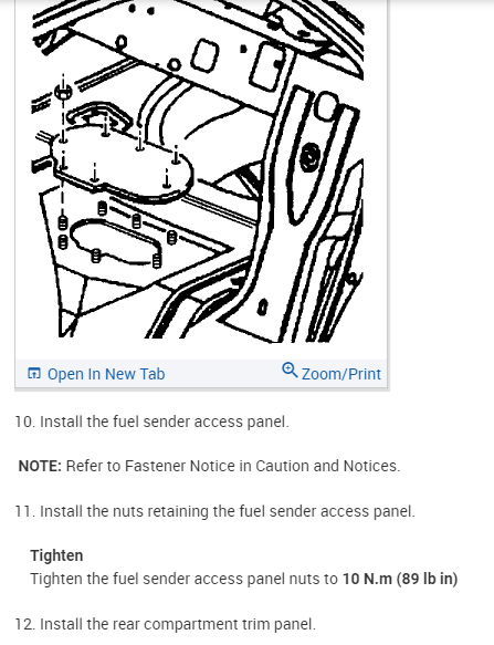

If I had to guess, either the tank is rusted through, or the top of the fuel pump module is bad. I also bet the check engine light is related to the evaporative emissions system (EVAP) due to the leak.

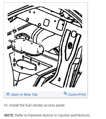

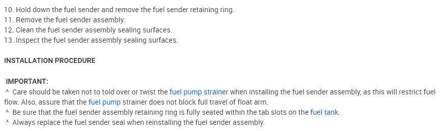

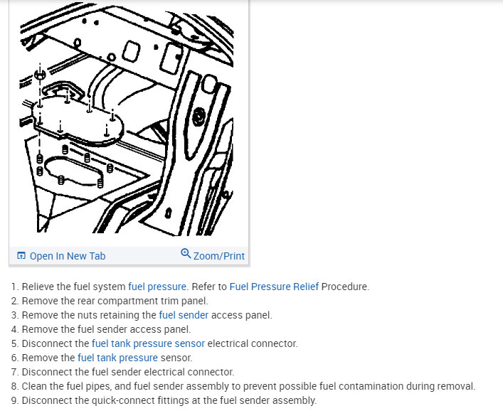

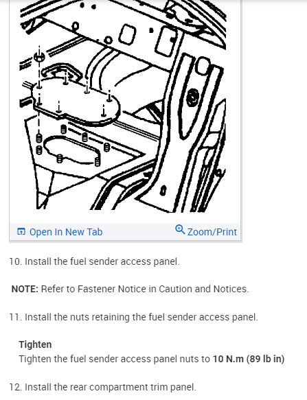

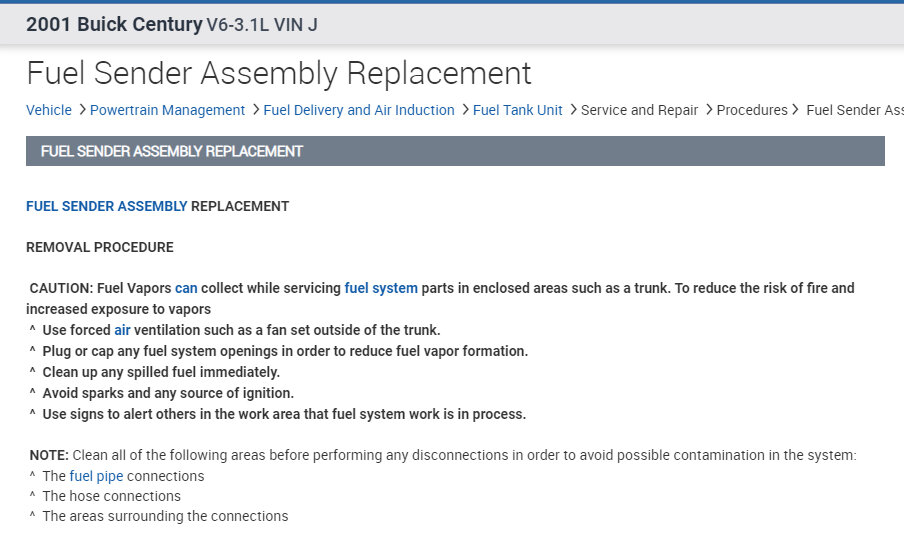

At this point, which needs to be inspected. There is an access port under the rear of the vehicle (trunk area). We need to remove that so you can see down inside and determine where the leak is coming from. There is also a rubber gasket that is used to prevent leakage where the pump assembly meets the tank. That could be faulty as well.
I attached the directions below for removing the fuel pump assembly. You need to at minimum access it so it can be checked.
I attached the directions below. Let me know if this is something you feel comfortable performing.
Take care and let me know.
See pics below. Note: the directions are for the replacement of the assembly. You may not need to do that, but that is the only way I have the directions to access it.
Mar 10, 2023 at 1:41 PM

Hi Joe. Well, Mr. Eleventh Hour is on the job. He says it's the fuel pump seal. He has taken out my back seat to access the pump. After looking at it, the pump is a little "shifted" and not centered to pull out and replace the seal. I can see the separation of the seal and the shift of the pump. I told him that's probably why you suggested getting to it from underneath and he didn't take to kindly to my suggestion. Now he is talking about having to cut part of the plate out to get to the pump. I walked away, hence, the update note to you. Suggestions?
Mar 23, 2023 at 6:15 AM
  • 110,236 POSTS
This is interesting. The access port is designed to replace the pump. When the retainer is removed, the pump will spring upwards. Is it possible that it is going up at an angle?
