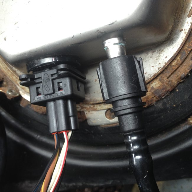

I recently replaced my fuel pump in my car.
I smelled gas and pulled a P0442 code. After filling it up, I found the tank leaked at the fuel pump mount. I put a new Motorcraft seal in, but it did not fix the leak. I took it out and ensured all surfaces and o-ring were clean. I ensured the pump plate laid flat before tightening down the lock ring. It still leaked. I have a new Motorcraft locking ring coming tomorrow, hoping that will solve the leak. Am I missing anything? Is there a sealant to use? I have done this several times before, but not on anything this new and have never had this issue.
Another question regarding the fuel line. I cannot find any definitive information on how to remove this line from the pump. I am assuming pinch the tabs and pull. Is this correct?

The line.

auto supply sells tool to remove those fittings

Thanks for the suggestion Johnny, but I finished it yesterday. I hope to never have to see this vehicles pump again so I'll just make a mental note of the tool.
After a new seal and locking ring, I did a closer inspection of the tank mounting surface. Lots and lots of rust, built up gunk, etc. I cleaned off the rust with a screw driver and brush. It was surprising to see how many flakes came off.
What I figure is that there was enough rust to cause the fuel pump and locking ring to sit barely above the seal and not make 100% contact.
P0442 code no longer shows up.
