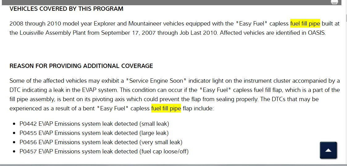

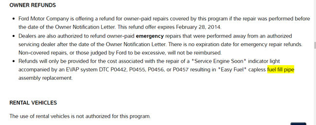

Seal crack oil leaking.
Apr 5, 2019 at 1:06 AM
SCGRANTURISMO
  • 4,897 POSTS

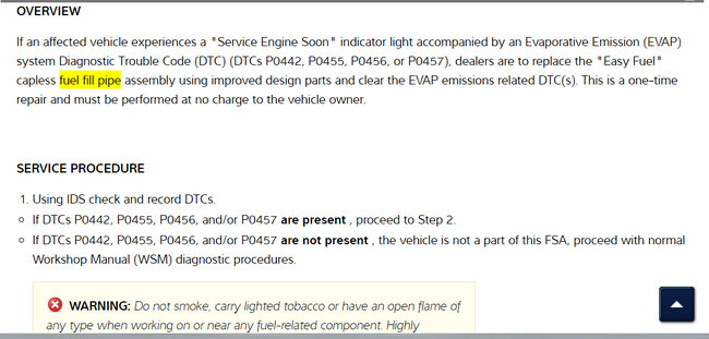

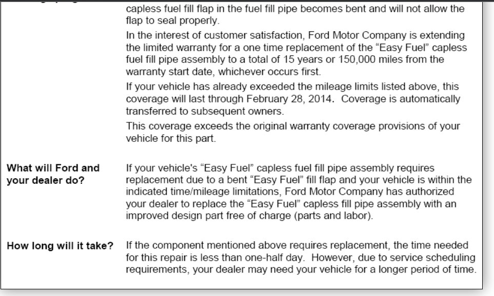

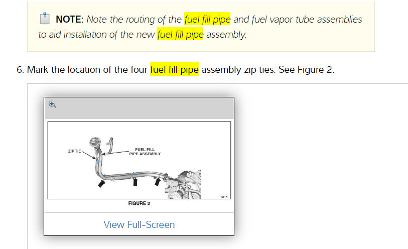

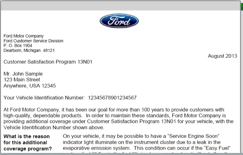

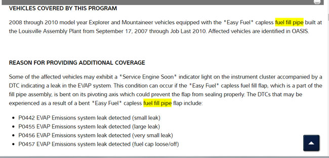

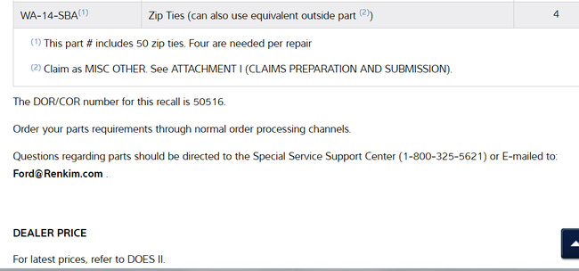

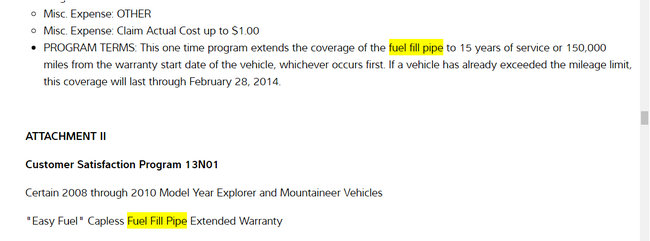

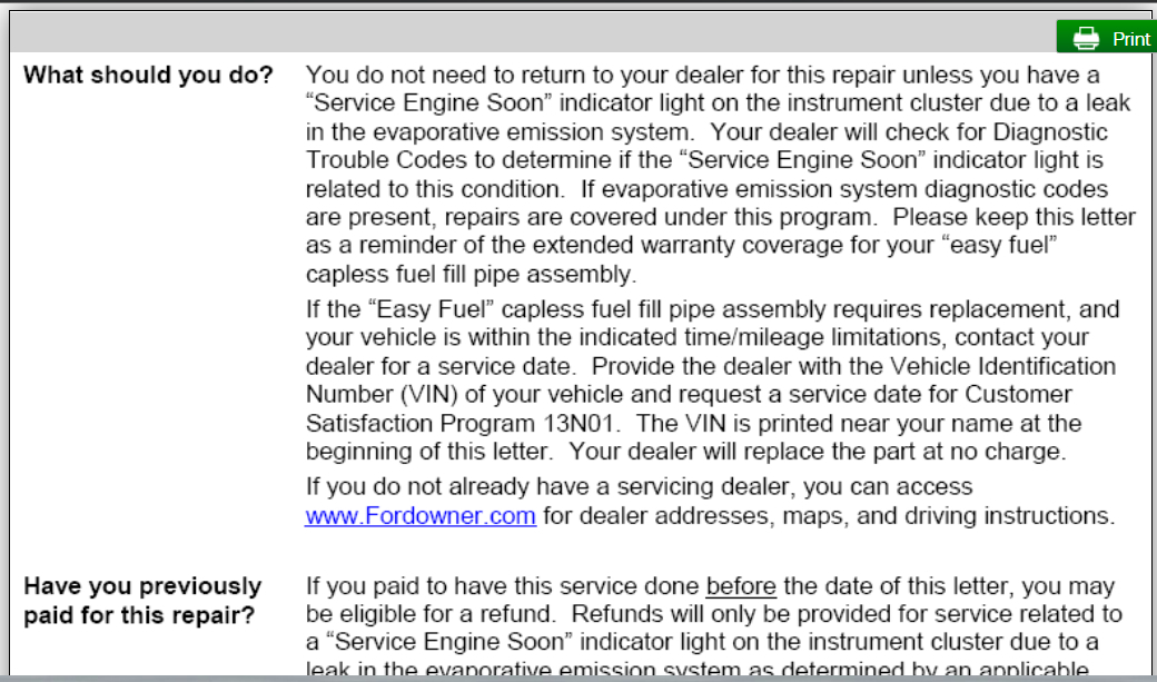

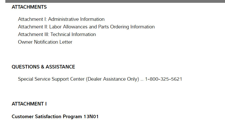

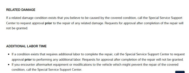

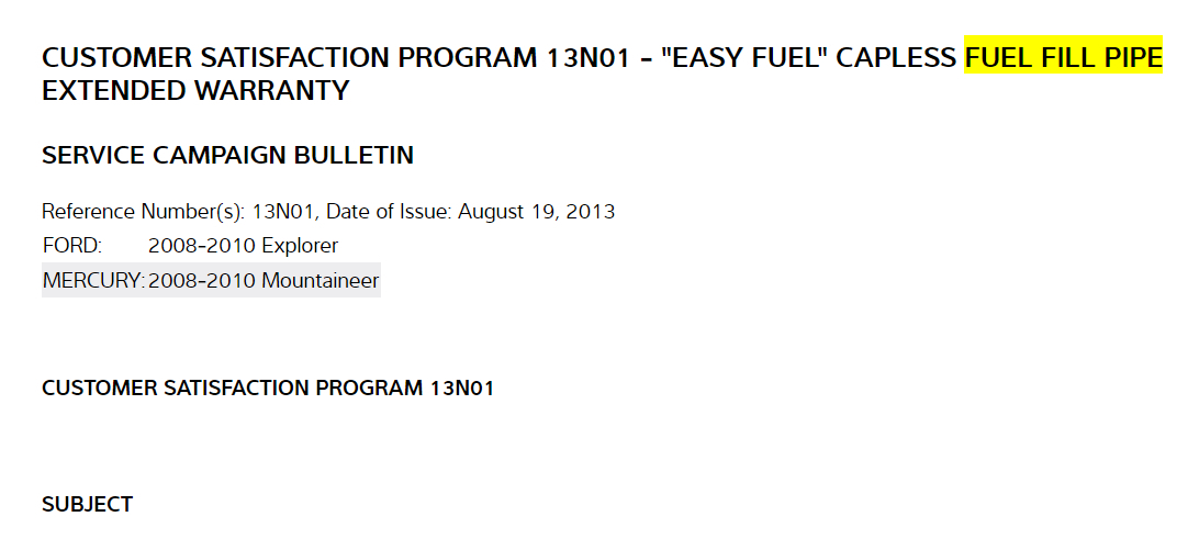

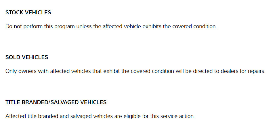

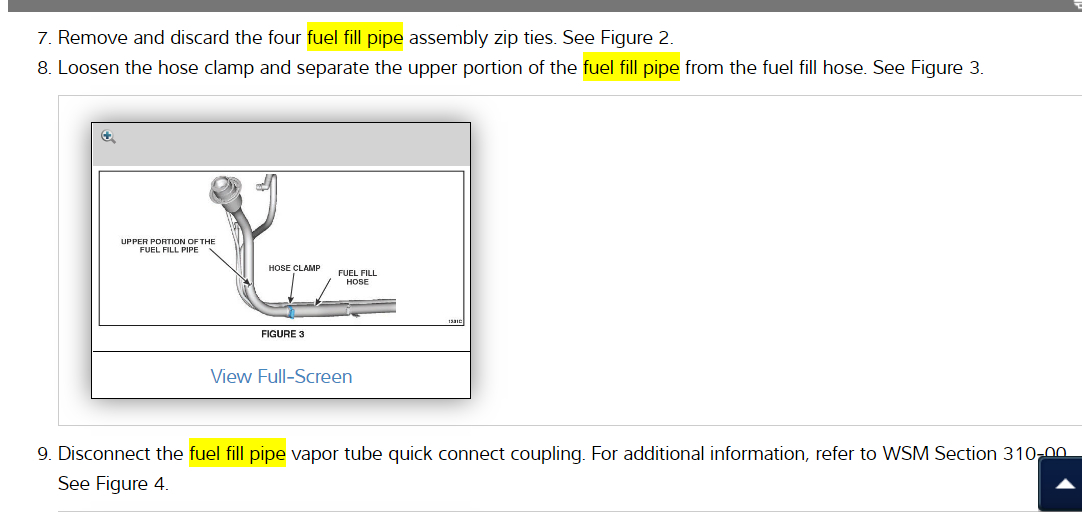

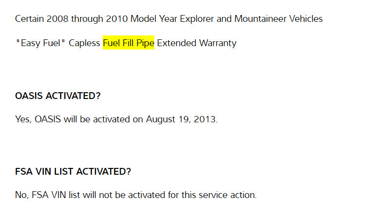

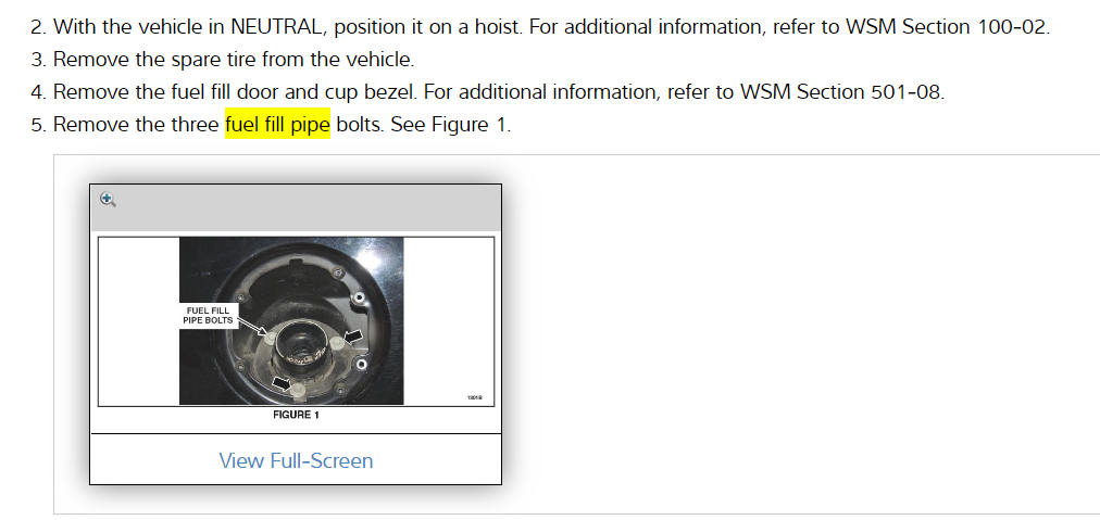

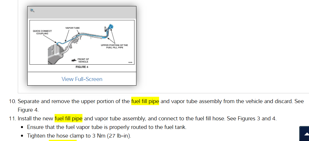

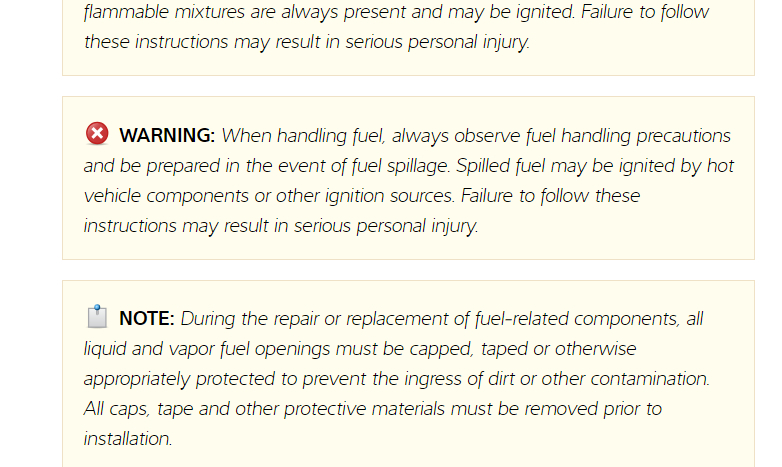

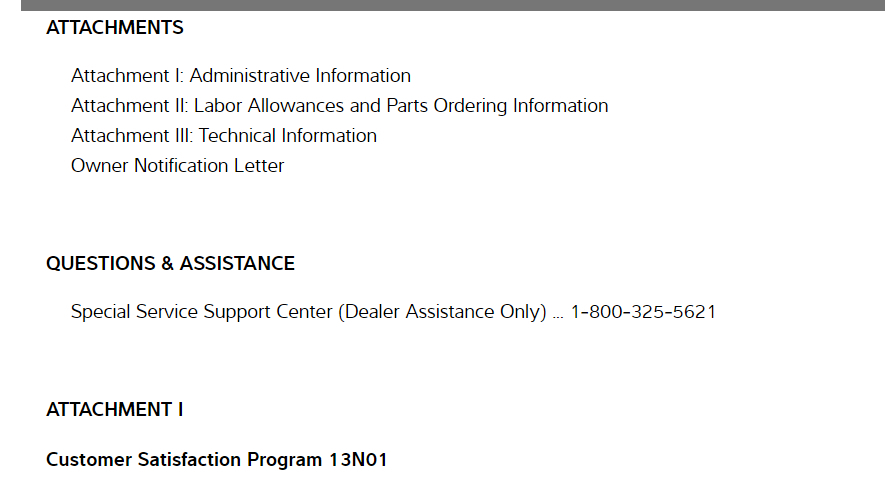

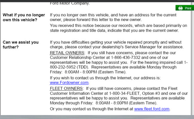

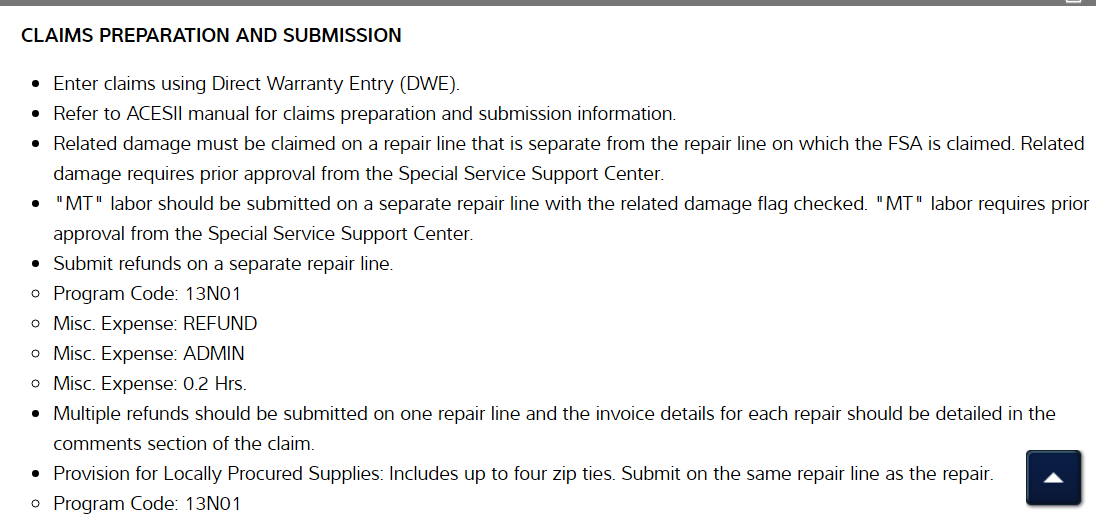

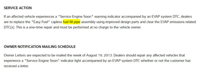

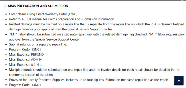

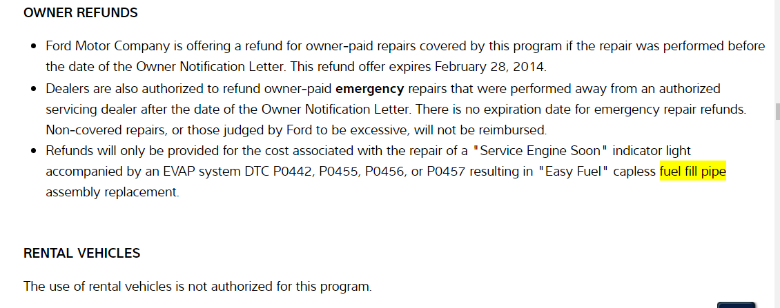

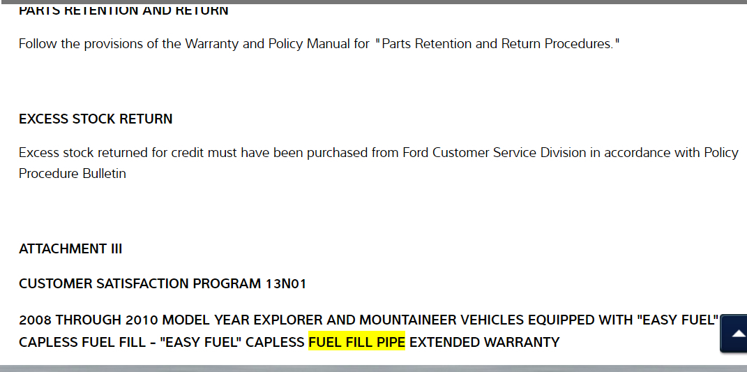

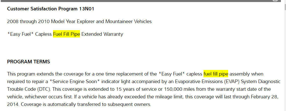

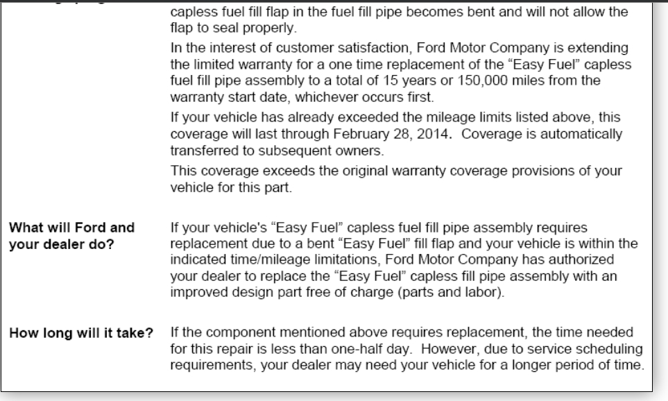

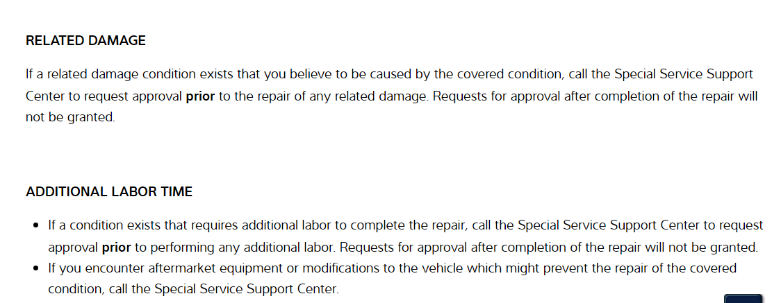

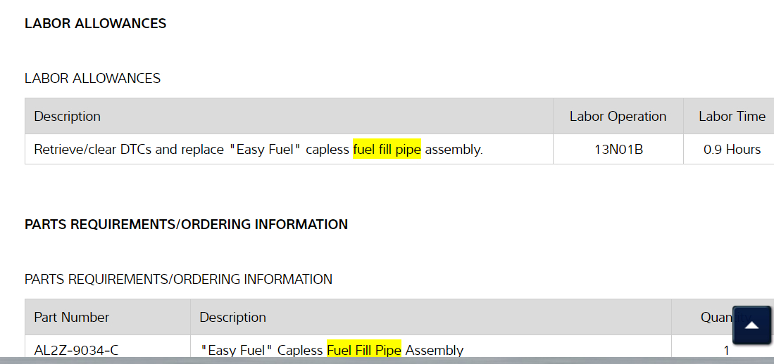

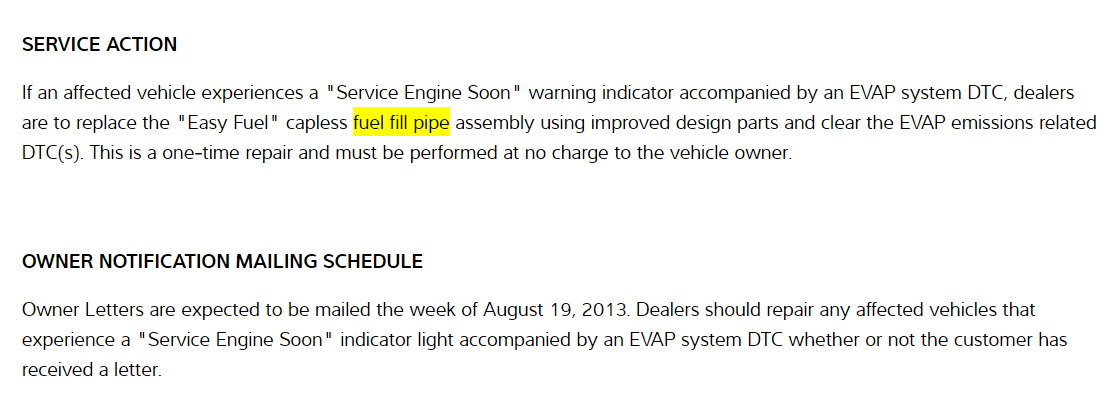

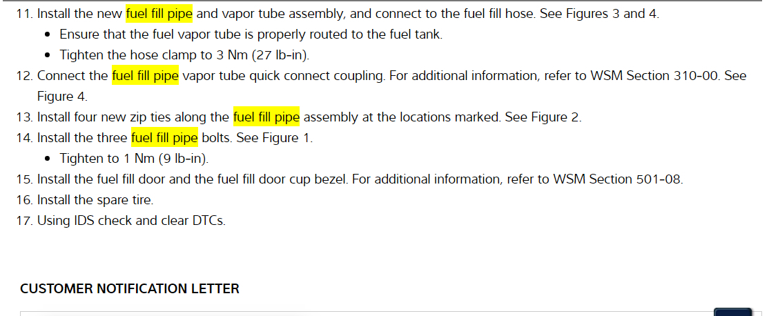

I have included for you in the diagrams down below a Technical Service Bulletin (TSB) i came across while doing some research for your vehicle. It is a recall notice to have your fuel filler neck replaced free of charge by The Ford Motor Company. All you need to do is call your local dealership, give them your particulars, and go have it fixed. Please let us know how it goes, we are interested to hear about it.
Thanks,
Alex
2CarPros

Dear sir
Leak in my car is at fuel tank side connection not from filling hose. it is part of tank. in attached picture yellow seal crack.
Apr 8, 2019 at 3:28 AM
SCGRANTURISMO
  • 4,897 POSTS
Yes. The filler neck goes into the tank. It is like a tube that the gas goes down to get into the tank. There is usually a foam rubber grommet that fits around the hole in the gas tank and the neck goes through that acts as a gasket. If your vehicle is included in this recall, the dealership will replace it for free. The only way to find out is to call your local dealership and tell them what is going on and give them your vehicle's Vehicle Identification Number (VIN).
Thanks,
Alex
