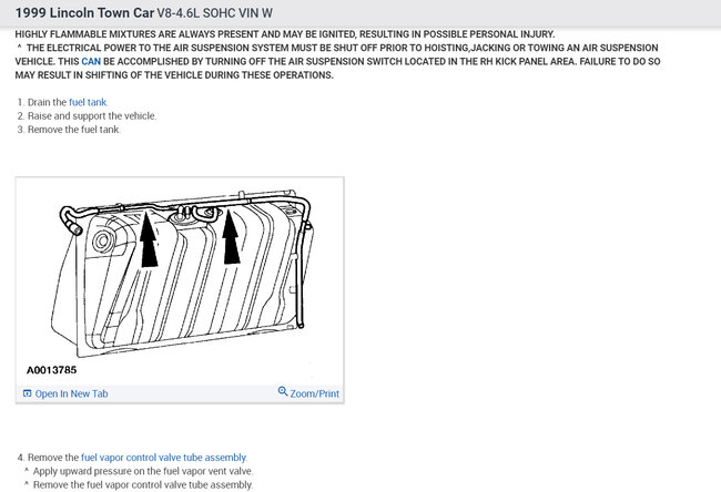

The car listed above is the Signature Series. Specs say fuel tank capacity is 19 gals. But when I fill the tank from empty, it only takes in 15 gals. Why?
May 25, 2023 at 12:29 AM
  • 55,732 POSTS

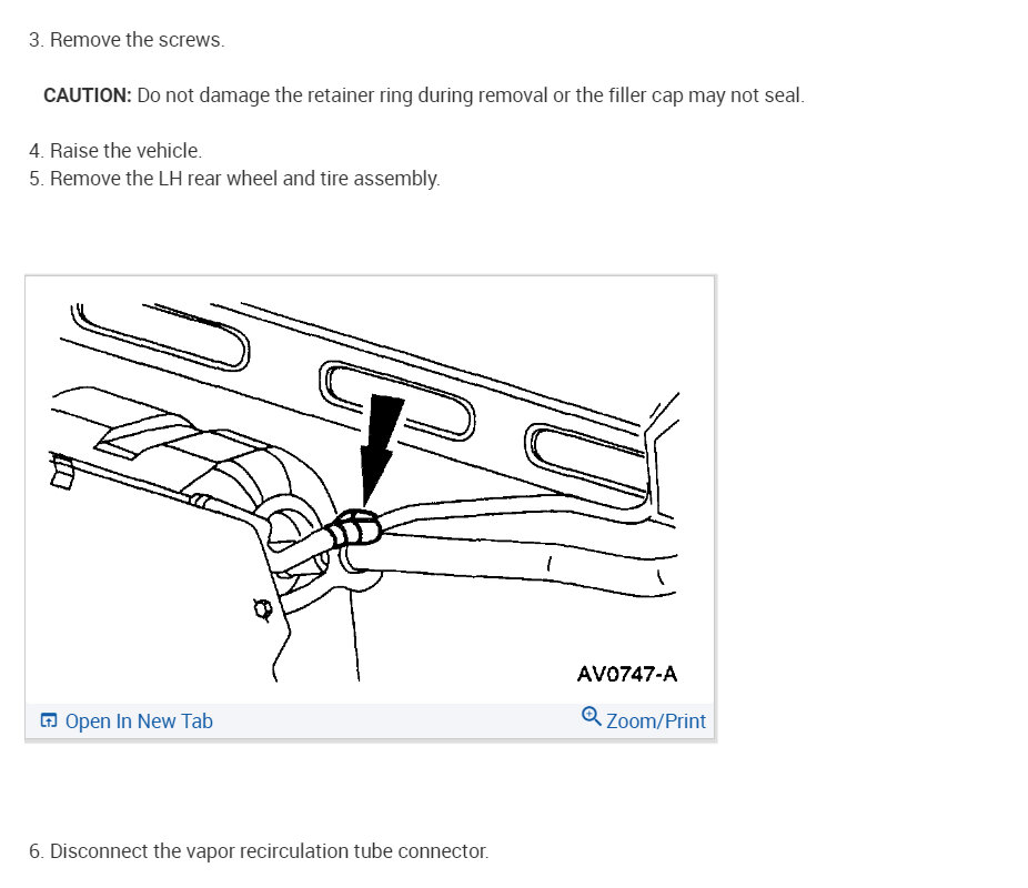

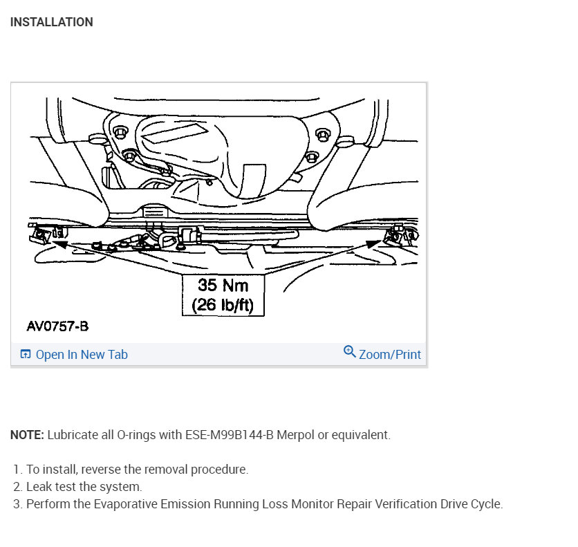

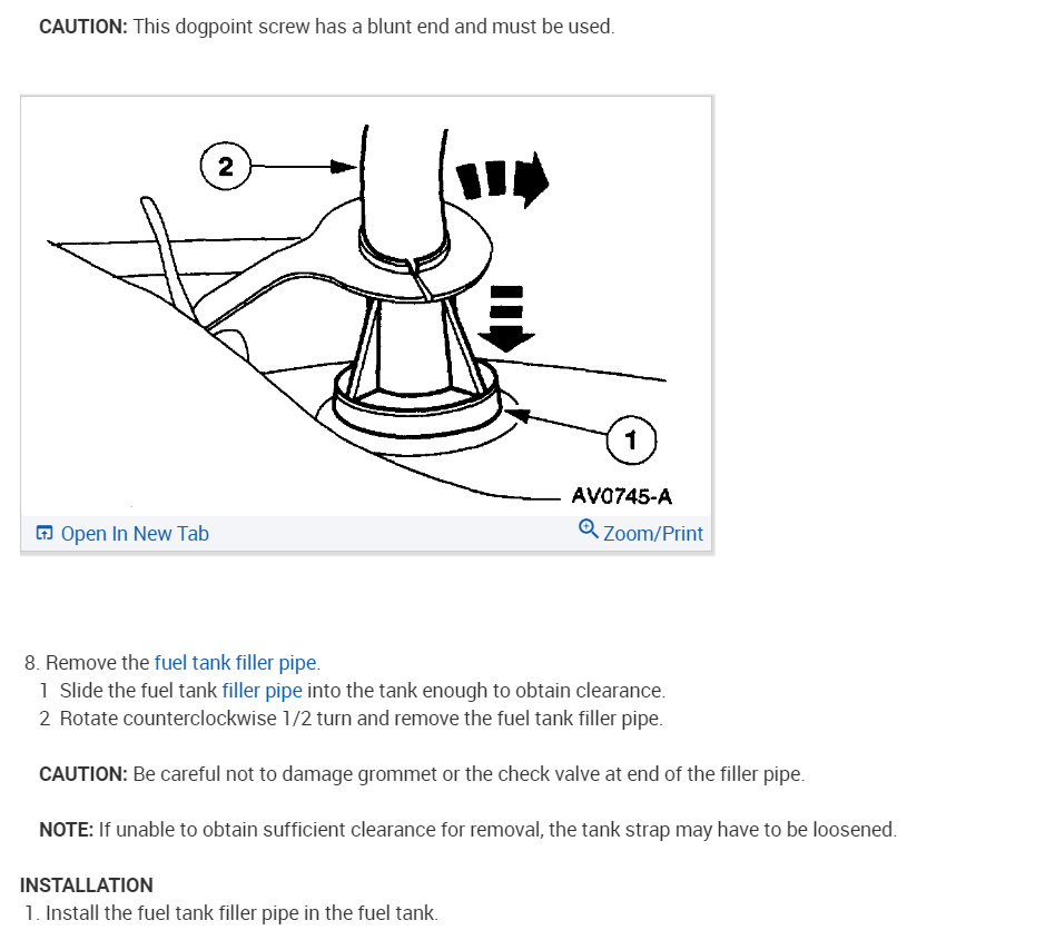

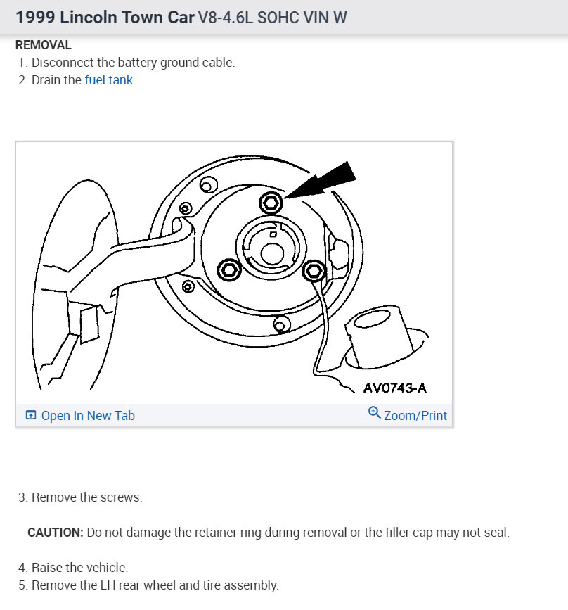

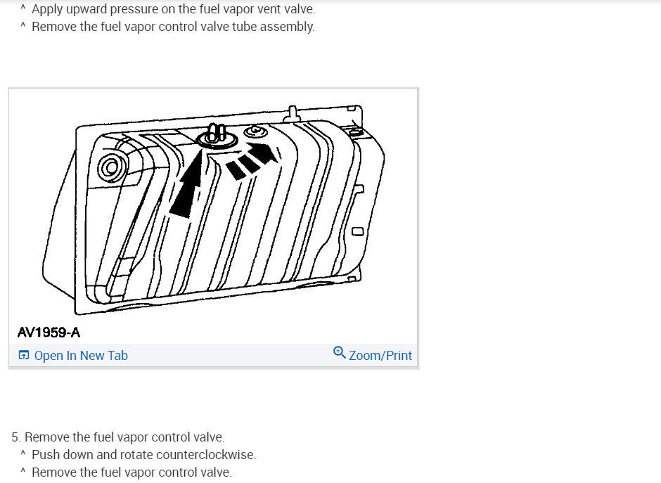

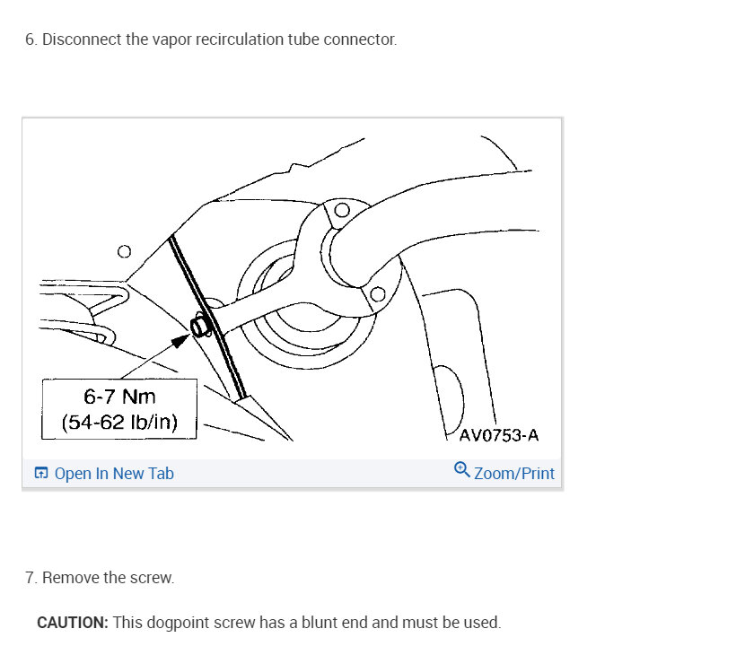

The fuel tank capacity of a 1999 Lincoln Town Car is approximately 20.0 gallons. It sounds like you have a problem with the filler neck vent which is external to the filler.
Here is how to replace it to help fix the problem and a guide as well:
https://www.2carpros.com/articles/troubleshooting-incomplete-gas-tank-filling-causes-solutions
