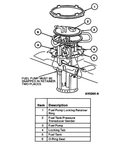

Is the fuel pump in the side or top of tank? Also I cannot find a picture of a tank that would be helpful.

The fuel pump is inside the tank. The fuel tank needs to be removed to gain access to the pump.
REMOVAL
1. Place vehicle on hoist; do not raise.
2. Install Multiport Fuel Injection (MFI) Fuel Pressure Gauge T80L-9974-B and perform the fuel pressure release procedure.
3. Drain fuel from fuel tank.
4. Raise vehicle on hoist.
5. Remove fuel tank.
6. Remove any dirt that has accumulated around the fuel pump module retaining flange so that it will not enter fuel tank during removal and installation.
7. Turn fuel pump locking retainer ring counterclockwise using Fuel Tank Sender Wrench T74P-9275-A and remove fuel pump locking retainer ring.
8. Remove fuel pump module. Reach in sender opening and, using thumb and index finger, depress two latching tabs toward each other to release reservoir from retainer in tank. Remove reservoir from tank, being careful not to damage filter or float rod assembly.
9. Remove fuel pump mounting gasket and discard.

3. Install the fuel pump carefully into the fuel tank to make sure that the filter, hoses and float rod are not damaged or binding. Align the fuel pump and the fuel tank retainer which is located on bottom of tank. Push the fuel pump into the fuel tank retainer. When the fuel pump is engaged, a definite click will be heard and the two outside tabs on the fuel pump will be engaged on the outside of the fuel tank retainer. The fuel pump must be snapped in the retainer with both tabs. Pull on the fuel pump to make sure it is fully engaged. Install sender plate to fuel tank being careful that locating keys are in keyways and O-ring seal remains in place.
4. Hold fuel pump module in place and install fuel pump locking retainer ring finger-tight. Make sure that all locking tabs are under fuel pump module locking retaining ring tabs.
5. Secure fuel pump module with fuel pump locking retainer ring by rotating fuel pump locking retainer ring clockwise using Fuel Tank Sender Wrench T74P-9275-A until fuel pump locking retainer ring contacts stops.

I want to cut access door for fuel pump. Need to know if on side or top or tank?
