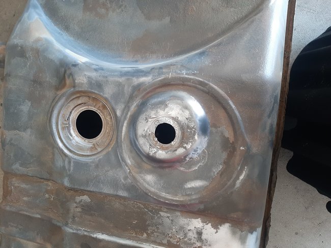

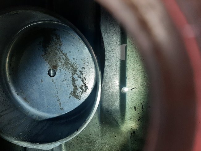

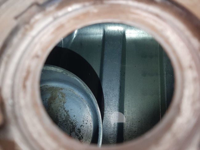

I am restoring the car listed above and the fuel gauge isn't working. so I dropped the tank to check sending unit. And as I am emptying the gas from tank I realized there is a lot of large loose objects moving around. I can see a large metal ring that looks like it was attached around where the pressure release valve is. Does it need to be rewelded in place and if so how should I go about it?

I do not recommend welding anything on the fuel tank. As far as the part you found loose, is it possible for you to take a pic of it and upload it for me to see?
Because of the model year, there is very limited information in the manuals, so hopefully, I will be able to identify the part to determine how to fix it.

I'm 99% sure it's supposed to be attached to the underside of the top of the tank. As a pressure release chamber.

I have to be honest. I've never seen one like that in a tank before. I asked the site owner to take a look and see if he recognizes it.

Sorry, I have never seen this in a tank before, left over part from manufacturing maybe?
