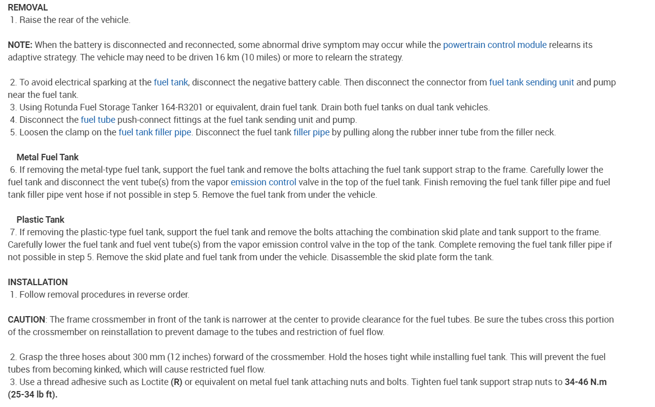

Hi, have a quick question. i have the truck listed above XL model. i dropped the rear tank to rebuild the fuel pump all fixed. My question is, I'm having a lot of trouble trying to put the fuel filler hose back in/on, i have no idea. i tried for hours to figure it out. I'm so unsure I'm honestly stumped thought maybe i ask here you guys are usually great with any help, advice, or tips. Thanks, take care.

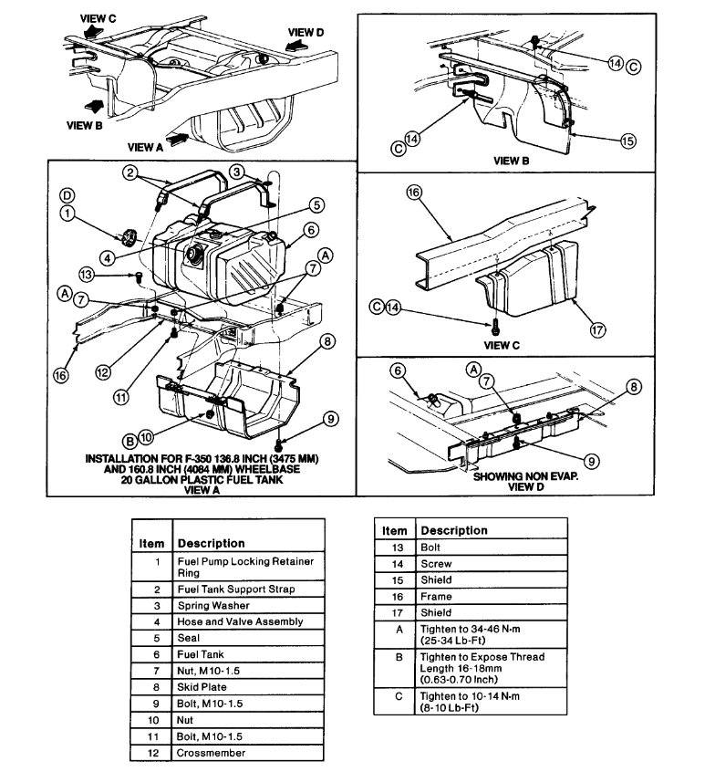

Can you upload pics or a short video of what you are trying to do? You can upload it with your response. Here is what the manual says about doing the job. Check out the diagrams (below). Please let us know what happens.
