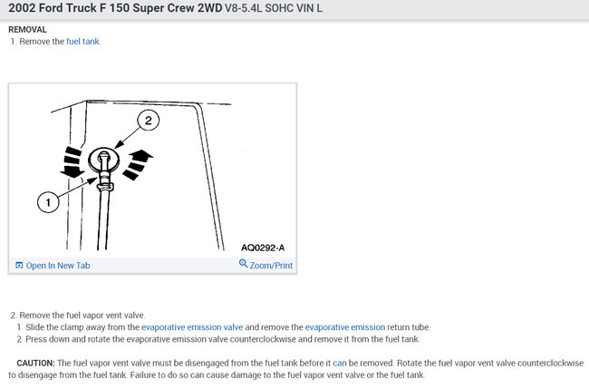

Can't remove fuel tank vent valves
Feb 6, 2016 at 10:59 PM
HMAC300
Experienced Mechanic
48,601 POSTS

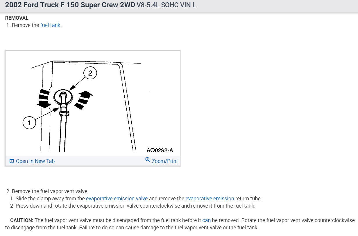

Hello, Try pushing down and twisting. Here is a diagrams and instructions below. Check out the diagrams (Below). Please let us know if you need anything else to get the problem fixed.
