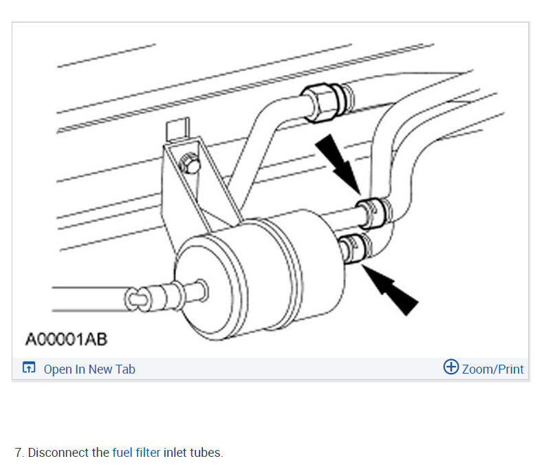

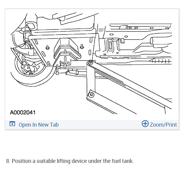

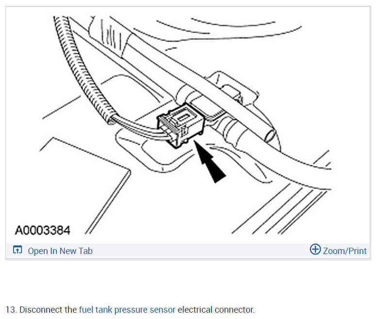

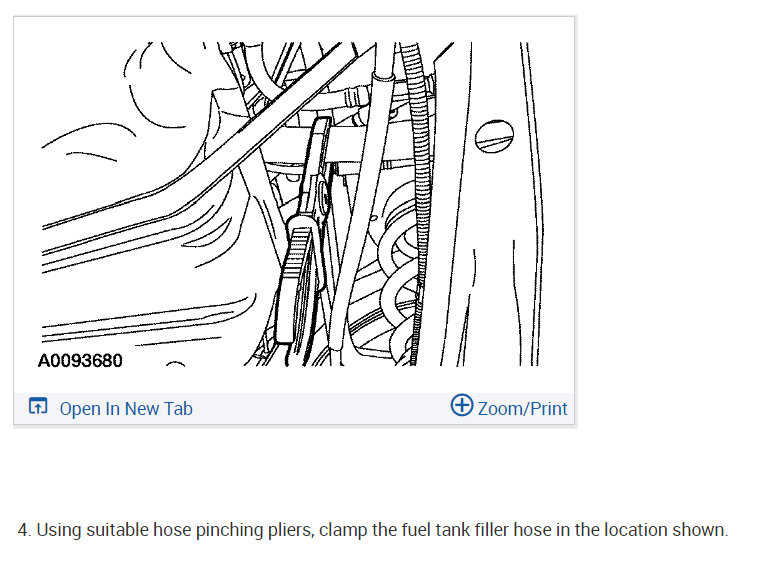

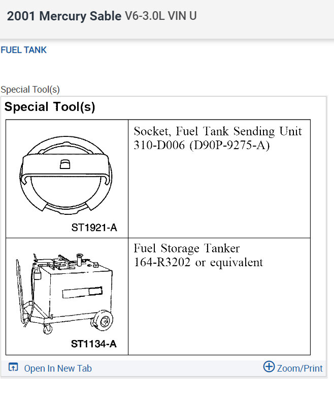

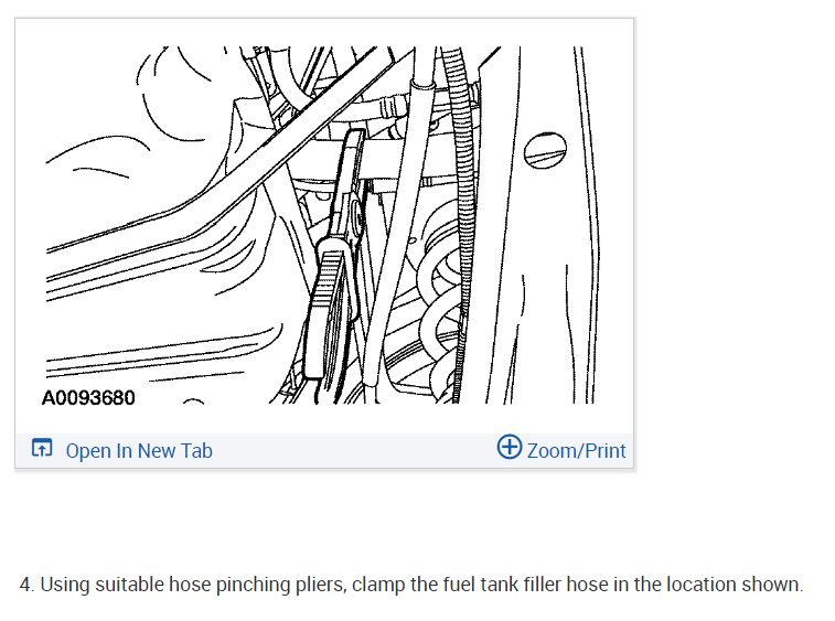

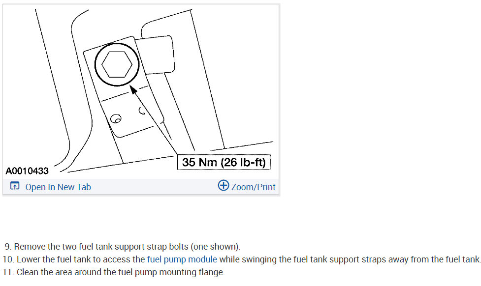

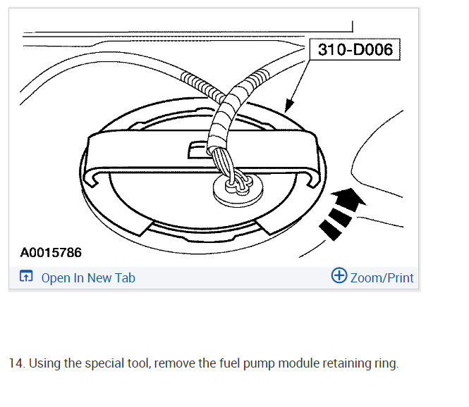

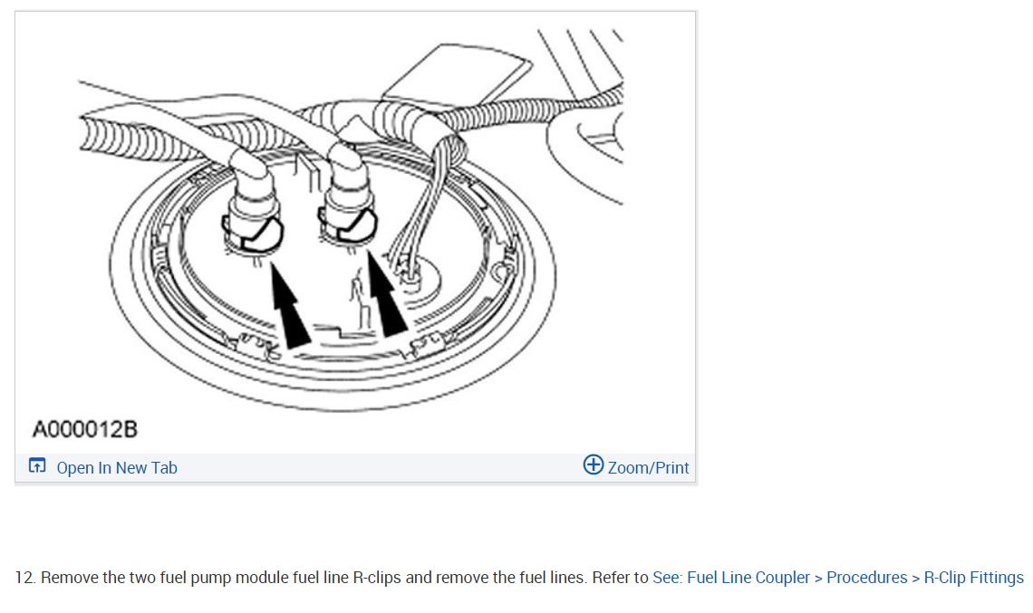

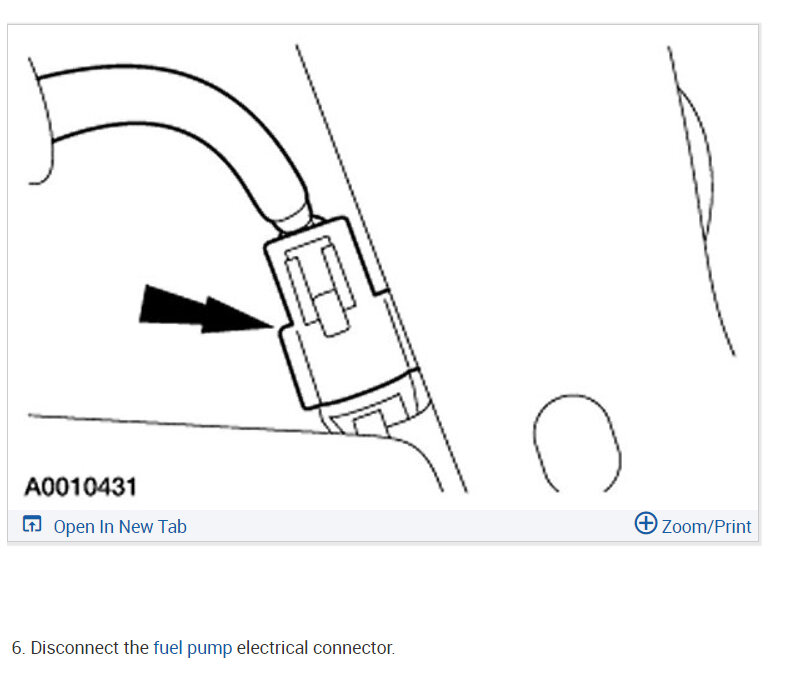

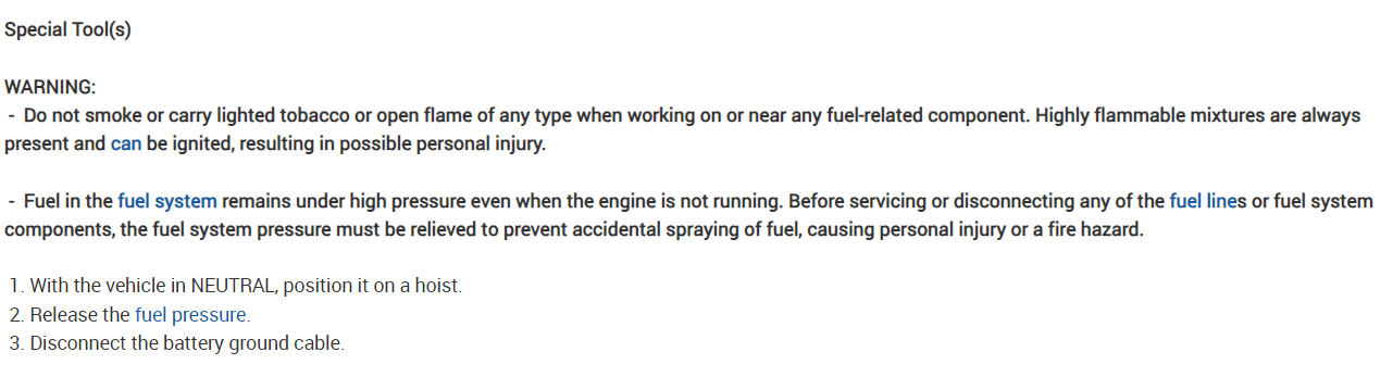

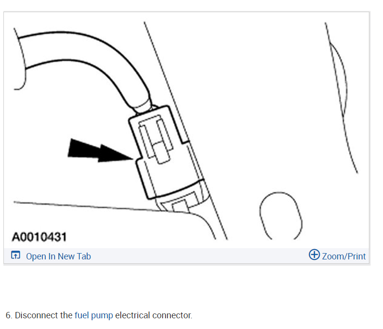

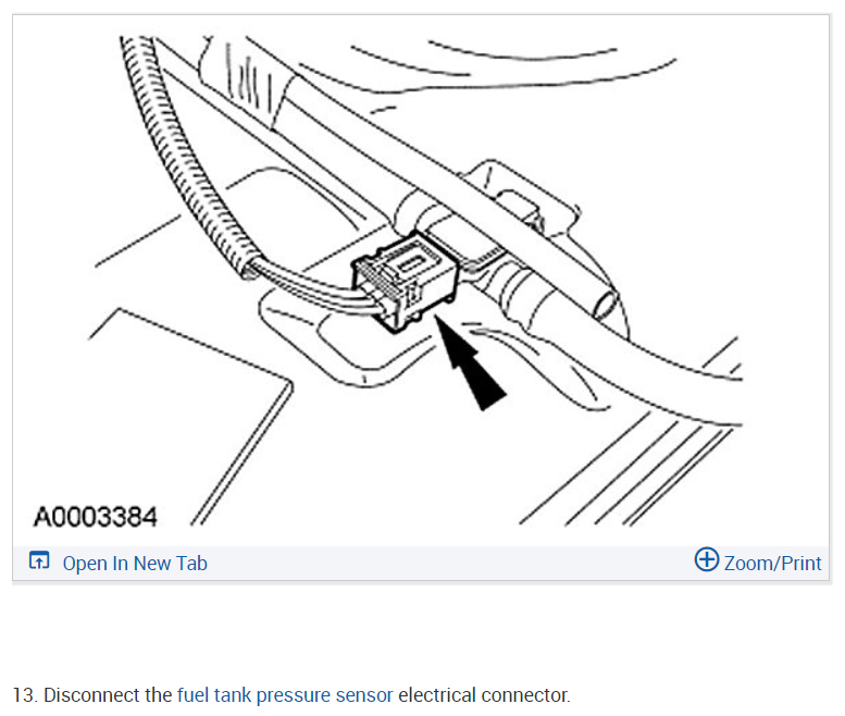

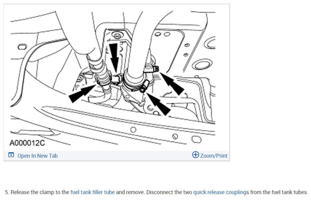

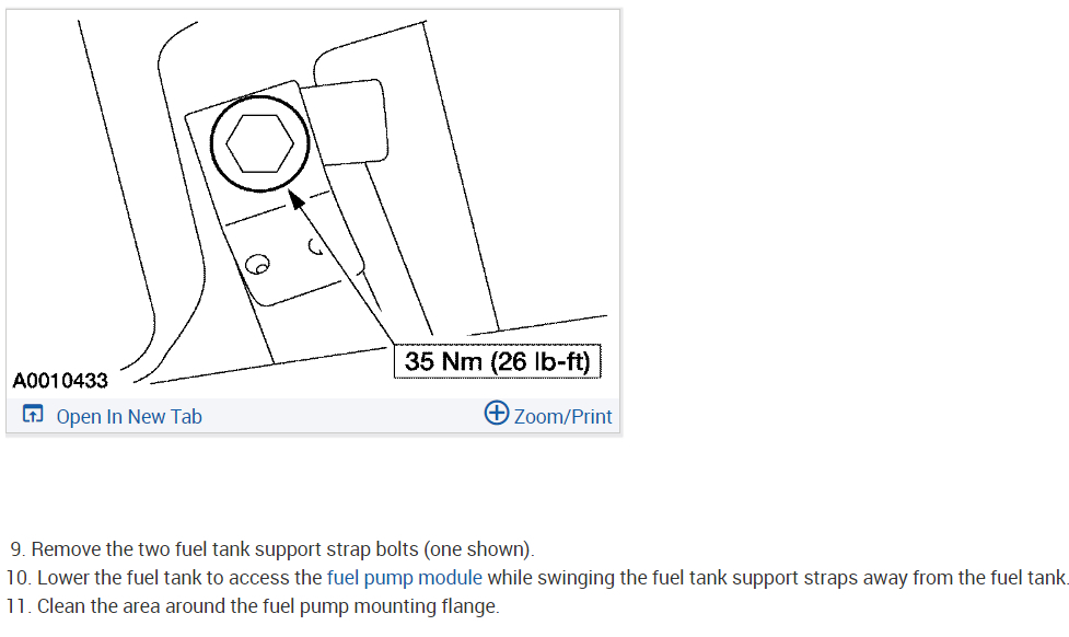

Failed fuel pump Fuel system need to replace the fuel pump?
Oct 14, 2024 at 3:43 PM
  • 55,395 POSTS
Sure, here is how to replace the fuel pump with the video of the job being done on a similar car to help you with the steps, I included instructions for your car in the images below.
https://www.youtube.com/watch?v=SOmd3BoE4YU
You will need to drain the fuel out first this video will help:
https://www.youtube.com/watch?v=Q5MH2gnyFH0&t=37s
Check out the images (below). Let us know if you need anything else.
