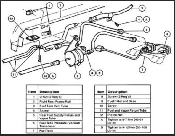

I need to know how the fuel pump, inline fuel filter and the fuel tank are properly connected. because someone else had the wrong pump and wrong filter and I'm trying to install the proper ones.

Just a quick question first. Are looking for the wiring diagram or the metal lines diagram? Thanks for using 2CarPros.

I am looking for the fuel lines diagram. I'm not sure if they are metal because the ones on the car are rubber and hard plastic, but I don't know if they are the proper ones.

I pretty much need to know where the two fuel lines from the pump go to and the two lines that go into the inline filter go to.

I've attached a picture below with line description... Hope this helps and thanks again for using 2CarPros.
