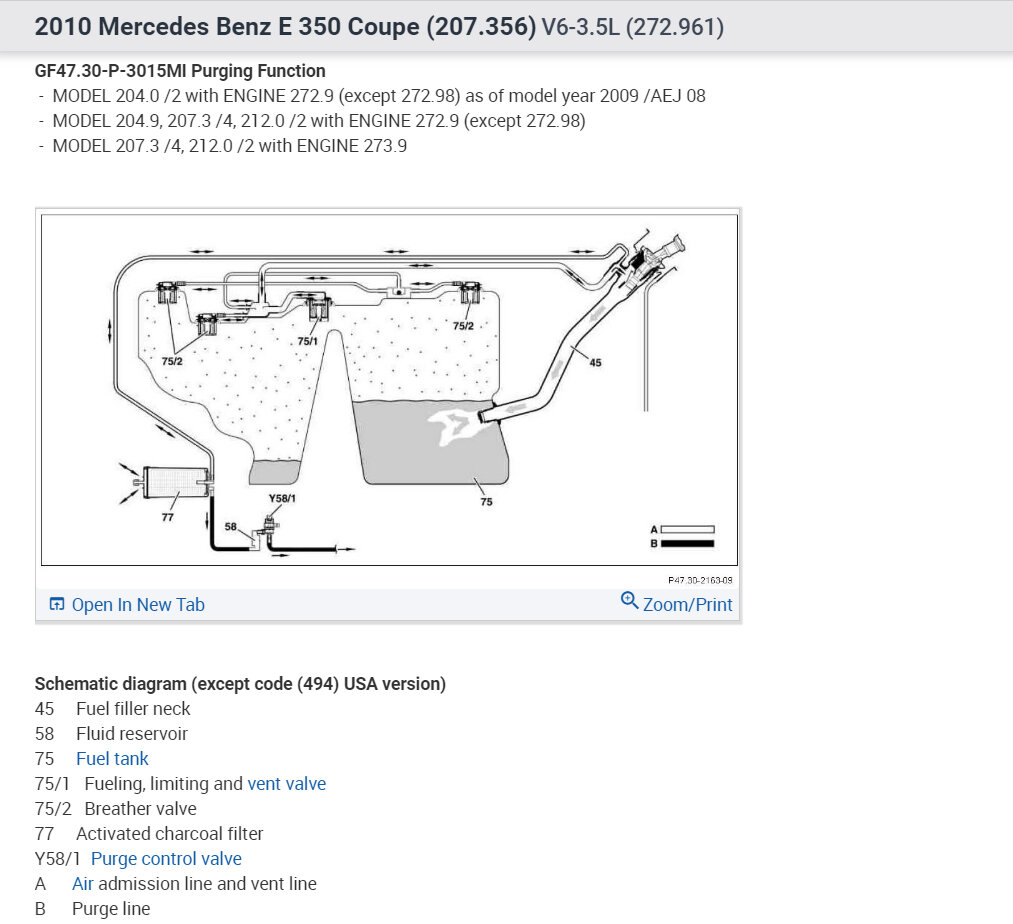

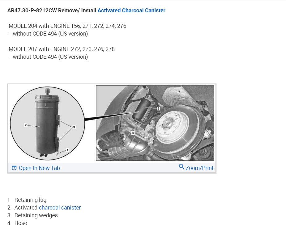

I'm trying to identify the main components of the fuel and vapor recovery system specifically around the rear seat area (above the tank). Any help would be great.
Apr 7, 2023 at 7:43 AM
  • 55,746 POSTS
Sure, here is a description of the fuel and EVAP system in the images below. Check out the images (below). Please let us know if you need anything else to get the problem fixed.

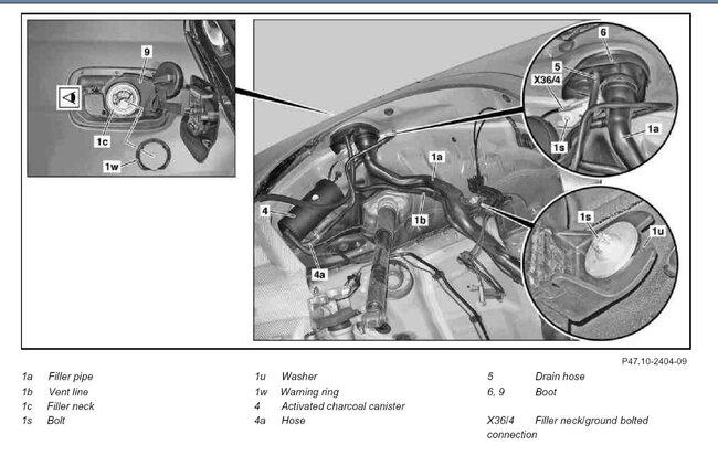

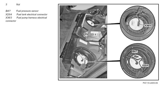

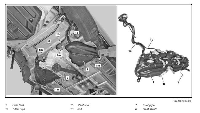

Thank you so much for the diagrams listed. How about a diagram showing the 2 fuel tank ports accessible under the rear seats? Their functions?
Apr 8, 2023 at 6:14 AM
  • 55,746 POSTS
Sure, here is the information you have requested. Check out the images (below). Please let us know what happens.
