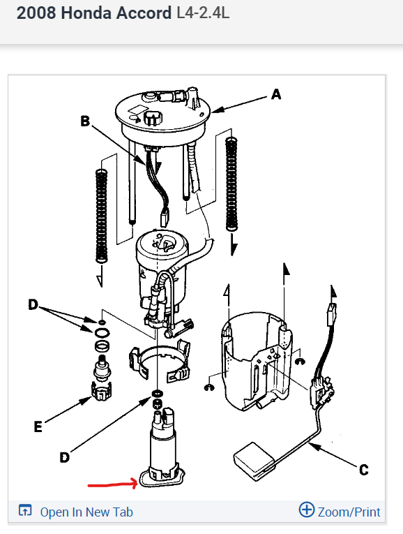

Location of the fuel filter?
Sep 21, 2024 at 8:59 AM
Experienced Mechanic
55,614 POSTS

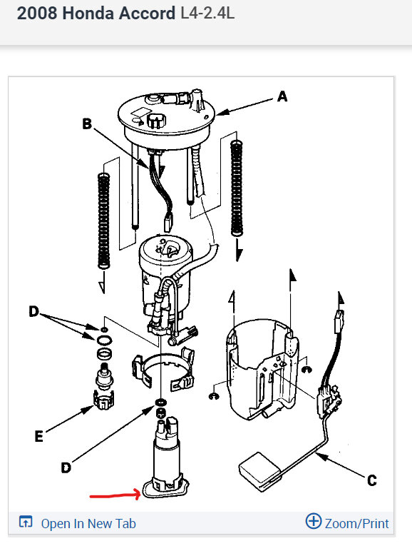

The fuel filter is inside the fuel tank at the end of the fuel pump, they now refer to it as a strainer. Check out the images (below). Let us know if you need anything else.
