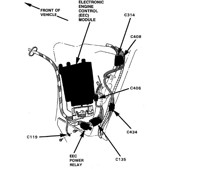

I recently installed a new 3/8” fuel line in the back behind my bbk intake I had to remove the upper intake to do so . Since I was already back there I just went a head and replaced both 3/8” lines, put it back together started it ran for a second then flooded itself out. Had gas coming out the bbk throttle body. I replaced the fuel pressure regulator but problem is still there. Help!
Jul 19, 2020 at 3:32 AM
Good afternoon,
I would disconnect the injector wires and turn the key to on and see if they still flood the engine. If it does, then the injectors are bad.
https://www.2carpros.com/articles/how-to-test-a-fuel-injector
If it does not then either the wiring to the ECM has shorted or the ECM itself is bad.
I attached the wiring diagram of the injectors wires to the ECM and the location of the ECM.
