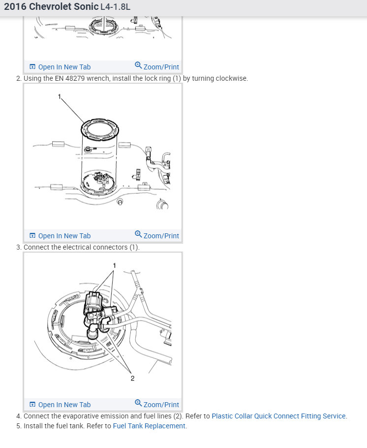

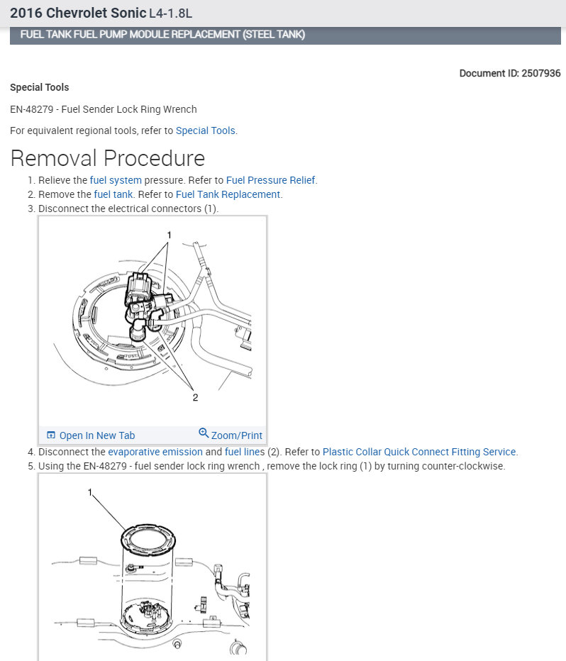

I've been looking for the fuel filter on this car all day. I have decided it doesn't have one. I'm just checking but I now believe I have to drop the fuel tank to even get to the fuel filter. There isn't access in the trunk or below the back seat. Sometimes I don't understand what the engineers were thinking when they design these things.
Jun 26, 2022 at 5:40 AM
SQM
  • 6,383 POSTS

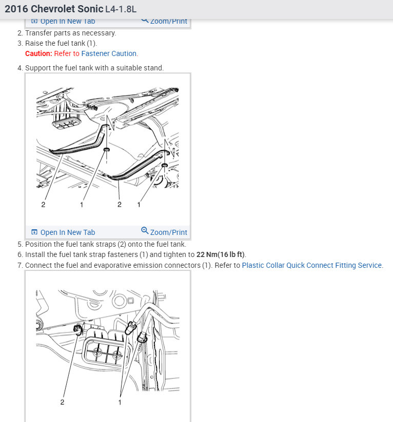

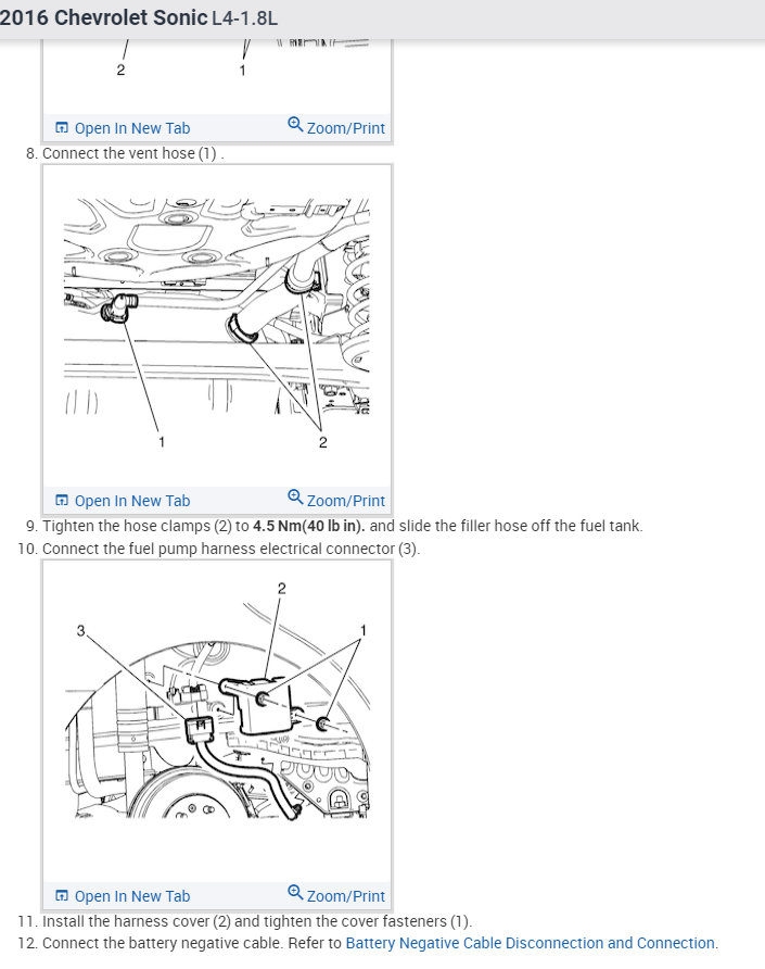

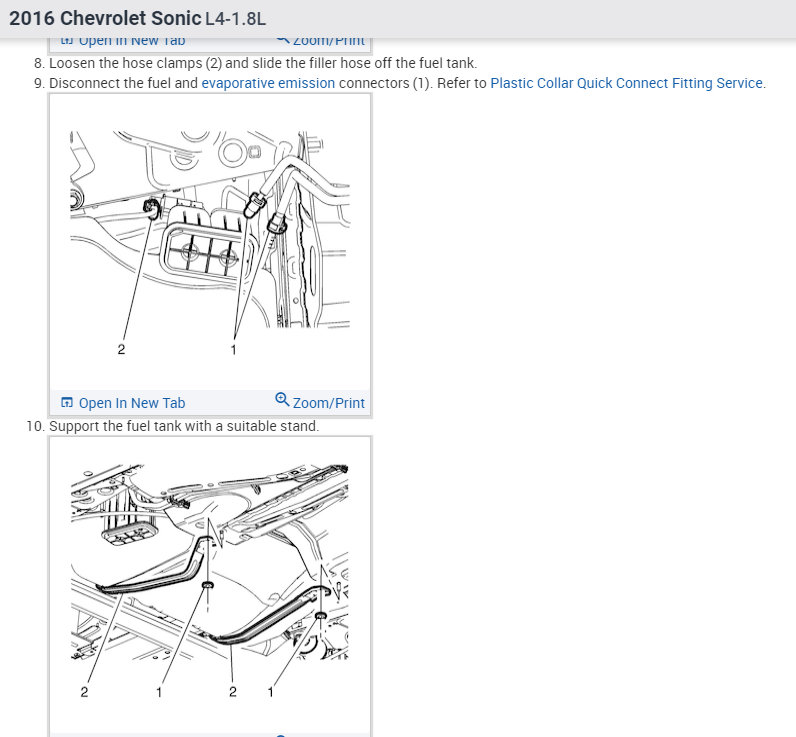

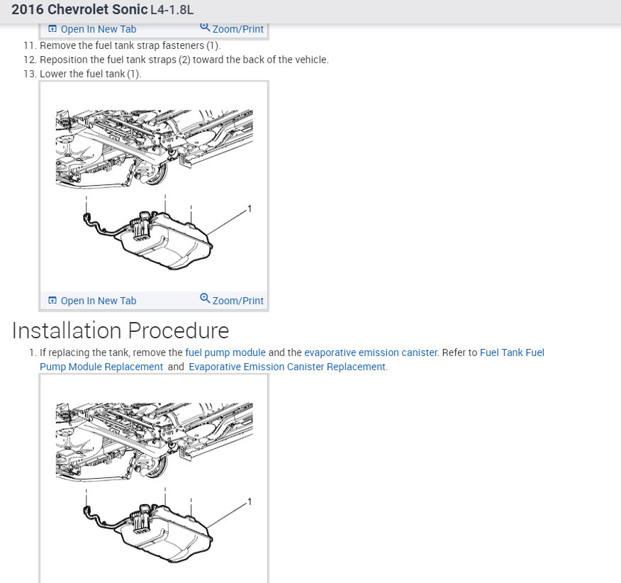

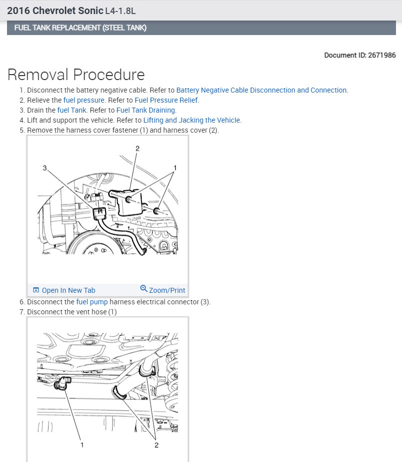

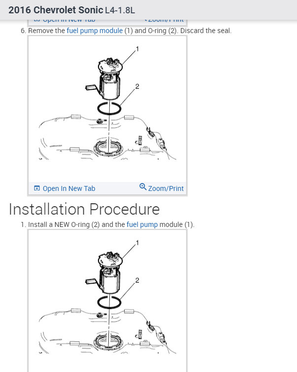

As you suspected, this vehicle does not have an inline fuel filter. It is part of the fuel pump in the tank.
Also, this is not a regular maintenance item on this vehicle.
And yes, you will have to remove the fuel tank to access the fuel pump.
https://www.2carpros.com/articles/how-to-replace-an-electric-fuel-pump
Let me know of any questions.
