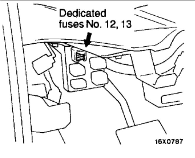

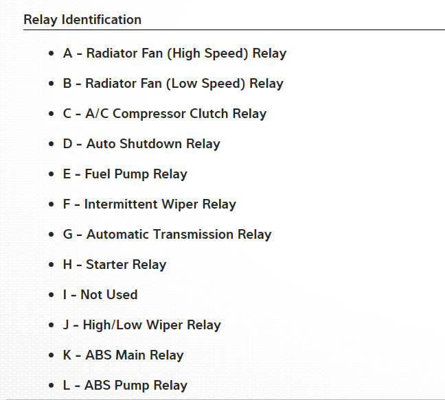

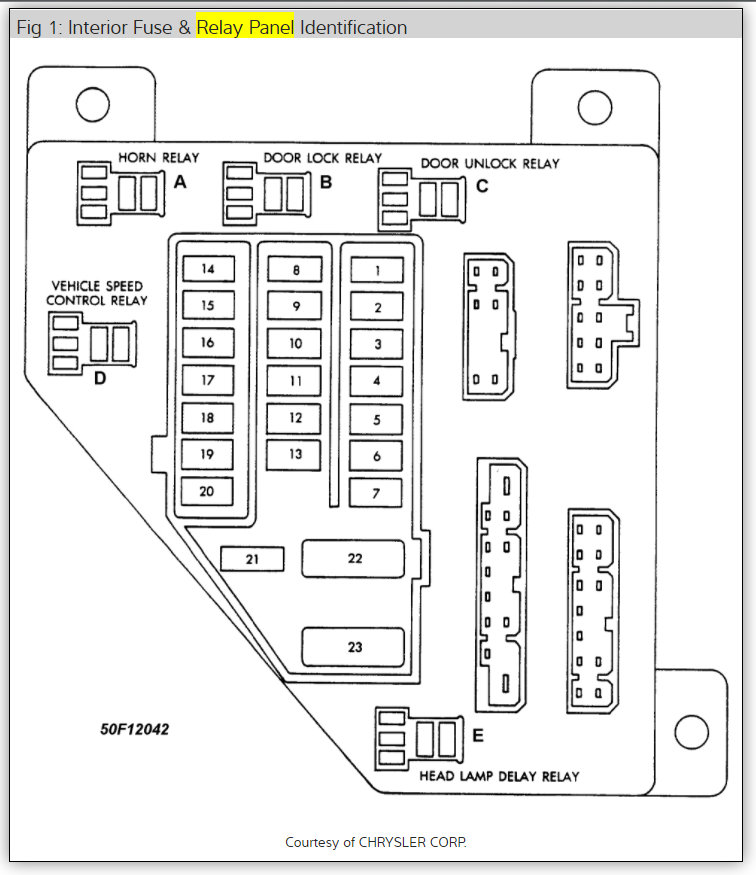

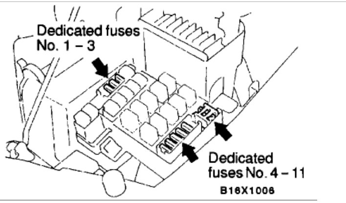

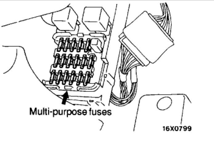

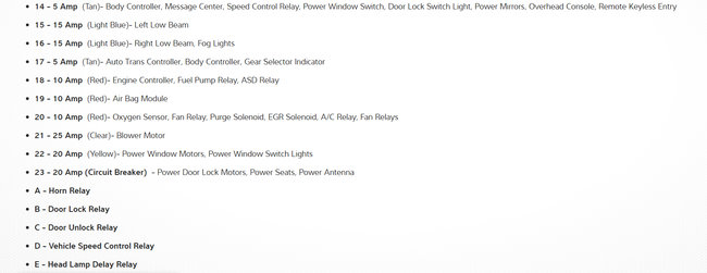

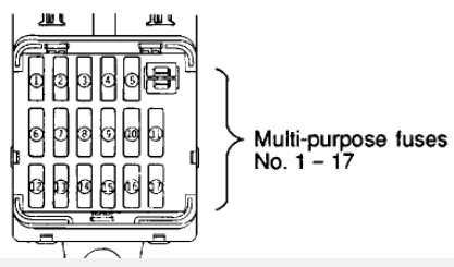

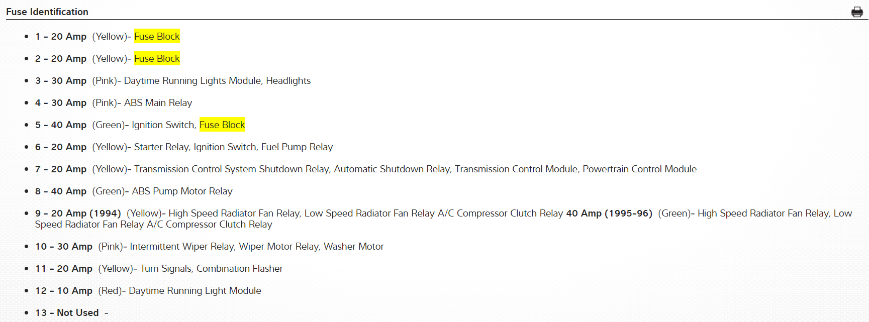

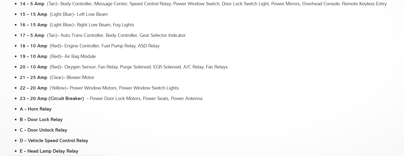

Where is the fuel pump relay located? it is a LXI, and it says Mitsubishi Motor Company under the hood. Mine is a coupe two door not a convertible.
Feb 22, 2018 at 8:12 AM
Experienced Mechanic
55,658 POSTS

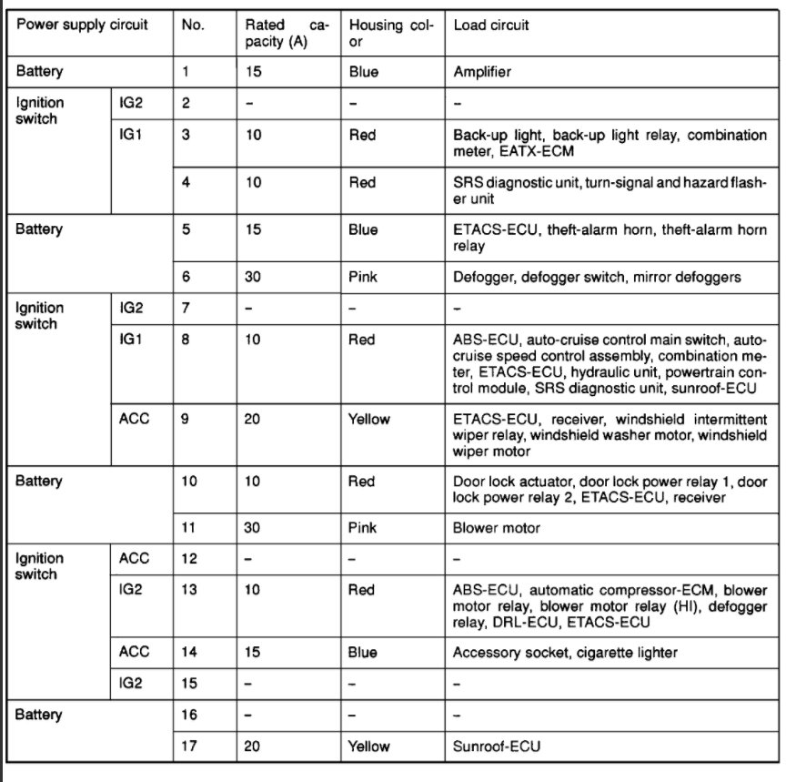

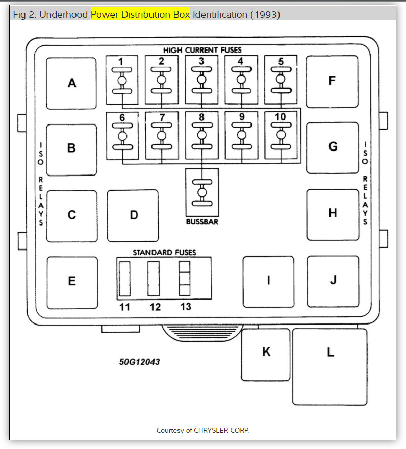

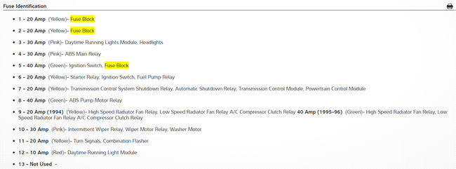

Depends on the model. Here is the layout for the under-hood fuse box for the convertible and non convertible.
This guide will help you do fuse testing.
