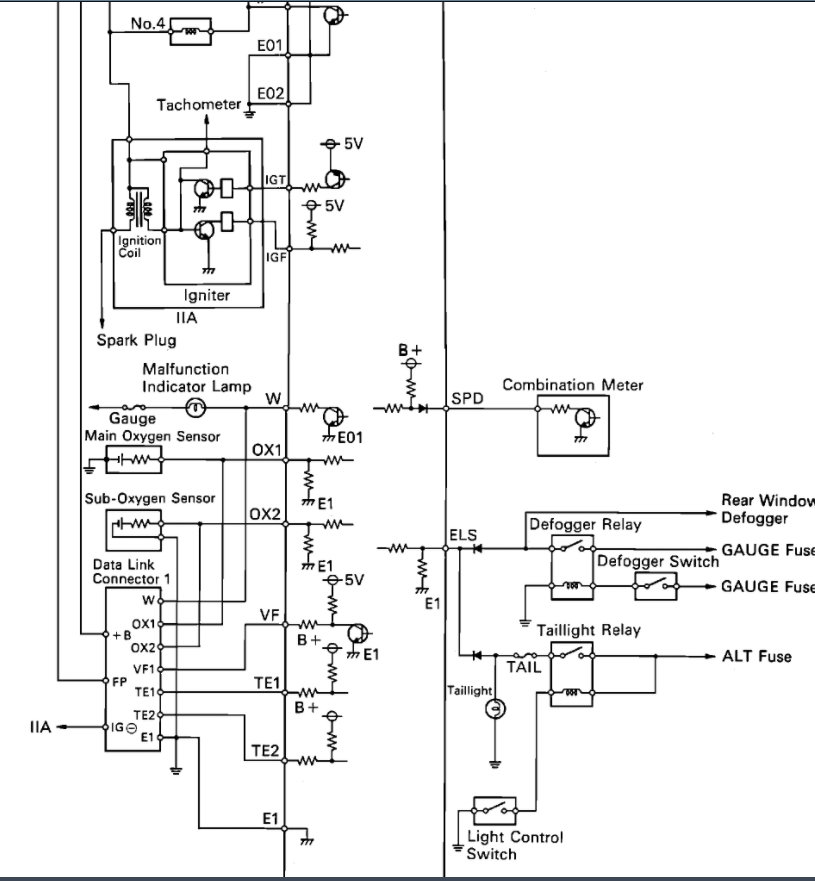

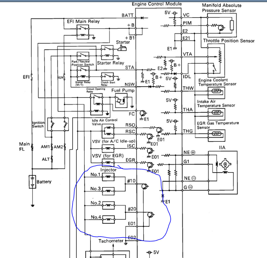

Two injectors not firing on my 4afe
320,000 MILES • 1.6L • 4 CYL • 2WD • MANUAL
SIYABULELA NTSOKO
  • 5 POSTS
I recently sent them for testing and cleaned.but the vehicle still have the same issue.what might be the problem?
Jul 24, 2021 at 4:15 PM
Good morning,

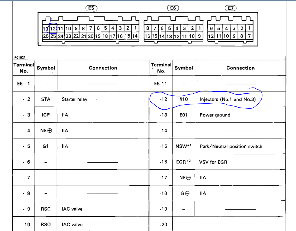

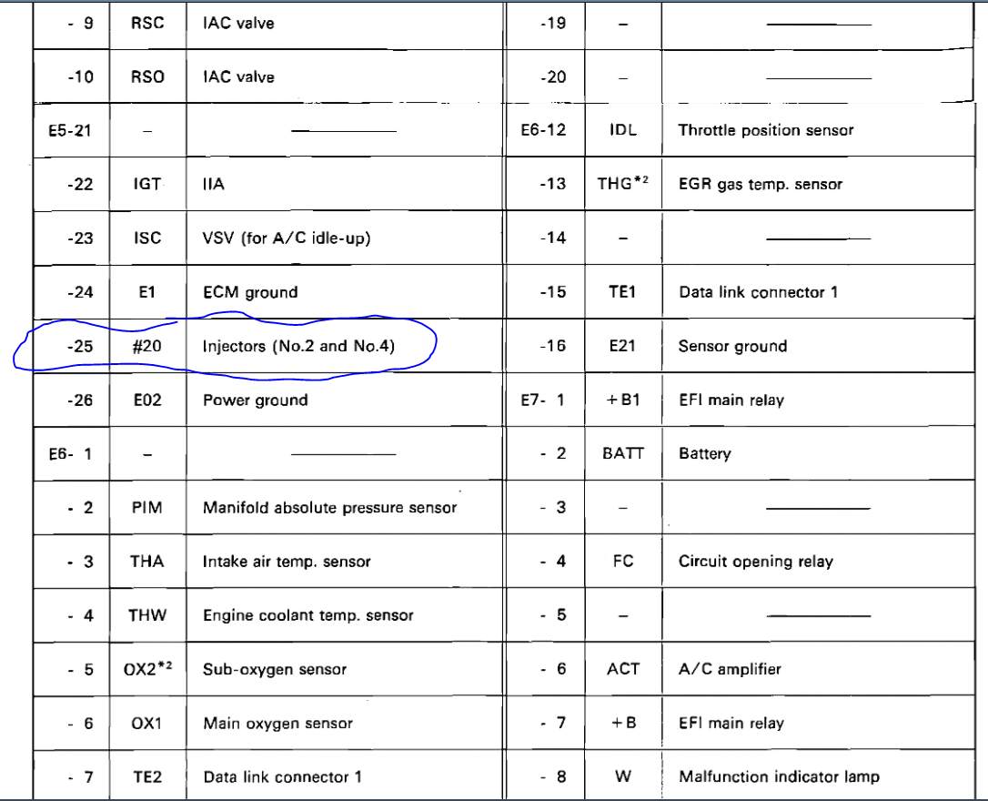

The ECM controls the injectors. The ECM controls 2 at a time. You should have power with the key on to the injectors on 1 terminal. The other terminal goes to the ECM for grounding. When it grounds the injector, it opens up and passes fuel.
https://www.2carpros.com/articles/how-to-test-a-fuel-injector

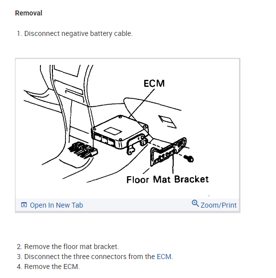

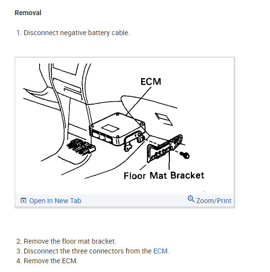

I attached a wiring diagram for you to view. If there is the power to the injector then it is a good chance the ECM is the issue.
