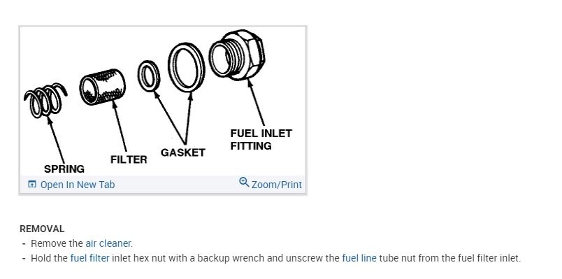

Good morning,
The filter is at the inlet of the carburetor. The line that screws into the carburetor must be removed. After that is done remove the fitting. The filter will be there.

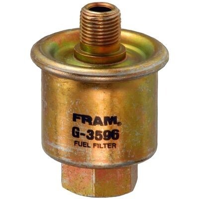

Thanks. I had this image from Alldata site. When I put the VIN in it came back with the type filter I bought at Napa. It is not the fabric type as in you photo. It is about two inches long and is a solid brass filter with inner and outer threads. It says remove air cover and then disconnect fuel line then filter. But I cannot see a part that looks like what I bought.
Sunday, December 8th, 2019 AT 5:51 AM
Can you post a picture of what you have? I want to see the part.
Sunday, December 8th, 2019 AT 5:55 AM
2103WALKER
  • 13 POSTS
Sure.
Sunday, December 8th, 2019 AT 5:58 AM
Okay, that is for a 2 barrel carburetor. The 5.8 had a 4 barrel which has the style I posted.
They gave you the wrong filter.

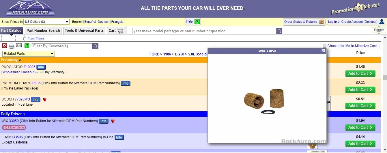

I looked and there is no sender listed for the mid tank anymore. I would consider replacing the rear tank and make it right. Rock auto has the tank in stock for under $100.00 and it has the lock ring as well.
