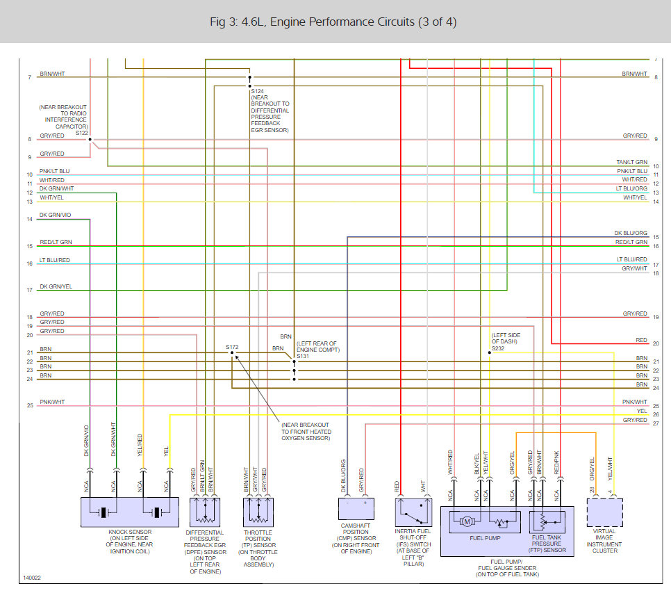

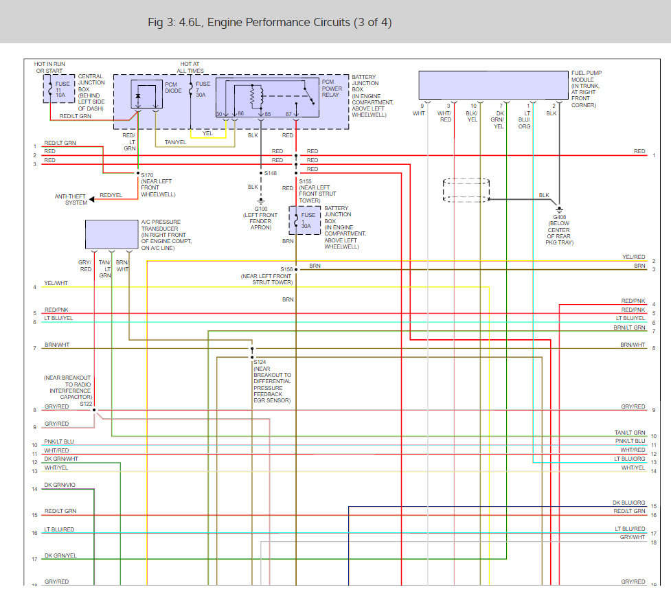

I had a weak battery so changed it and now I am getting no power to fuel pump. Everything else works normal. I checked inertia shut off switch and it seems okay. Went through fuses, but find no dedicated fuse to fuel pump.

I found the wiring diagram for the fuel pump and a guide to help you do check quick tests to see where you are loosing the power at.
and
