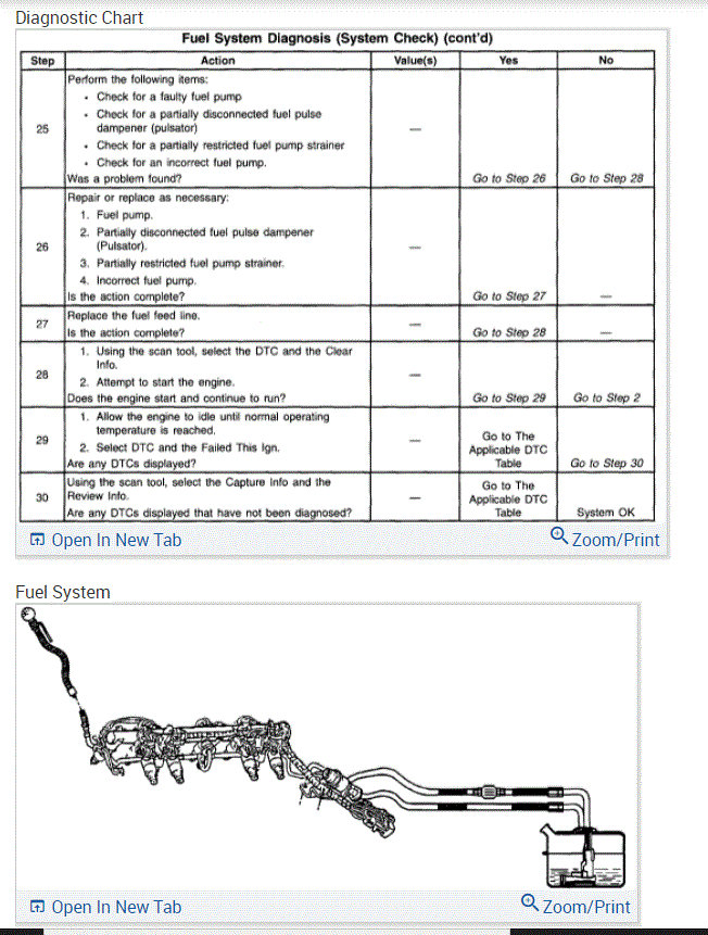

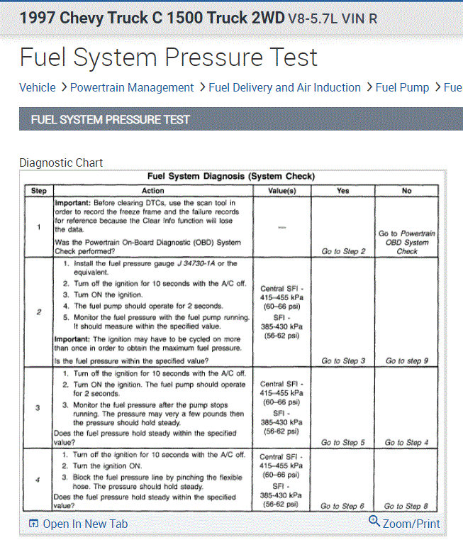

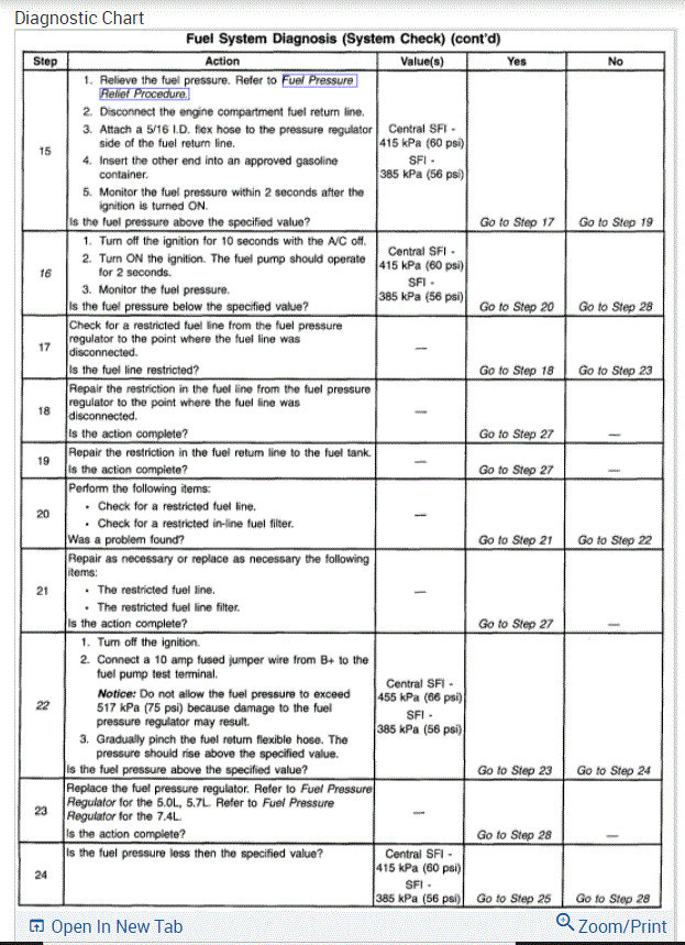

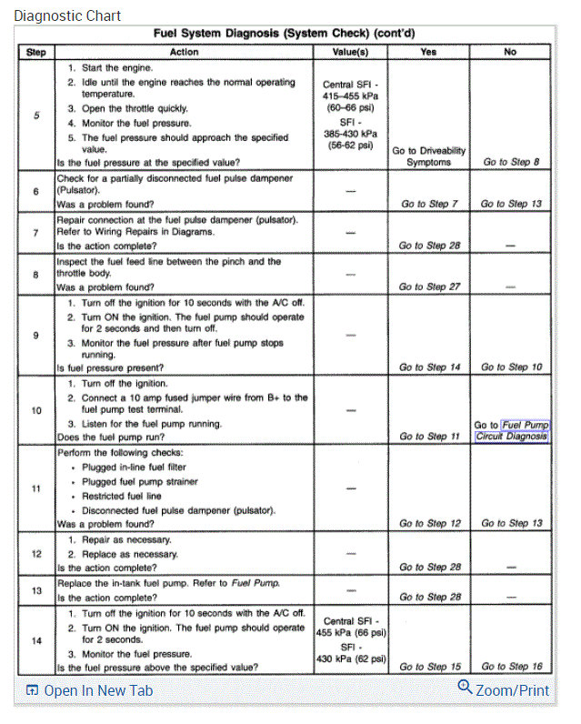

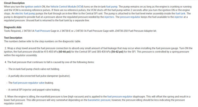

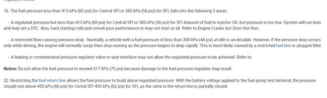

This could be a couple of different things. The first thing I would do is check the fuel pump pressure to confirm it's within the manufacturer's specs. Here is a link that shows in general how to test pressure:
Additionally, I provided diagnostics for the fuel system below. The diagnostics also includes the manufacturer's fuel specifications.
