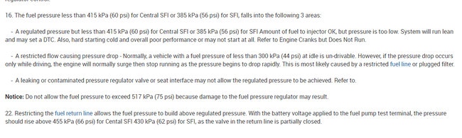

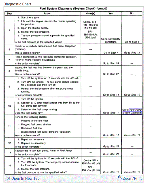

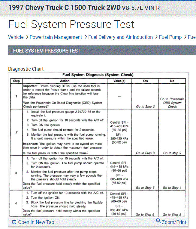

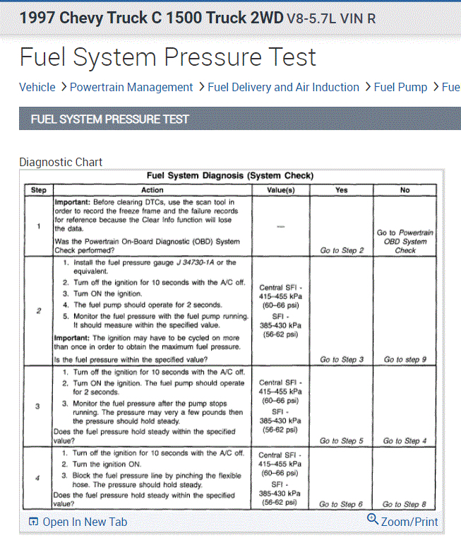

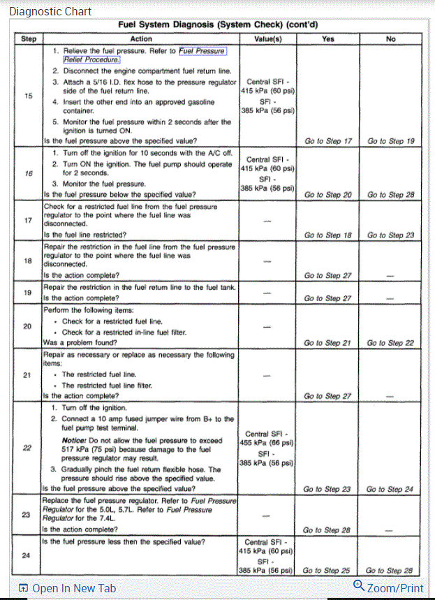

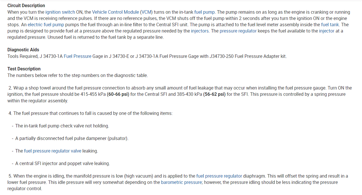

This could be a couple of different things. The first thing I would do is check the fuel pump pressure to confirm it's within the manufacturer's specs. Here is a link that shows in general how to test pressure:
Additionally, I provided diagnostics for the fuel system below. The diagnostics also includes the manufacturer's fuel specifications.
Before going to all the trouble of testing fuel pressure, try this. If it won't start, see if it will if you use starting fluid. If it starts and then stalls after a couple of seconds, then we will know if it is a fuel-related issue. If it doesn't start with starting fluid, I need you to check to see if there is spark to the plugs. Here is a link that shows how to check:
Let me know what you find, if you have questions, or if I can help in any way.

It would still be a good idea to check fuel pressure. Although it still is working, it could be too low to run the engine. Also, try the starting fluid test or check for spark to the plugs. This will help us limit the number of possible causes.
