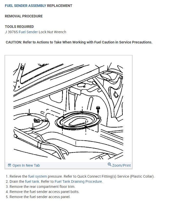

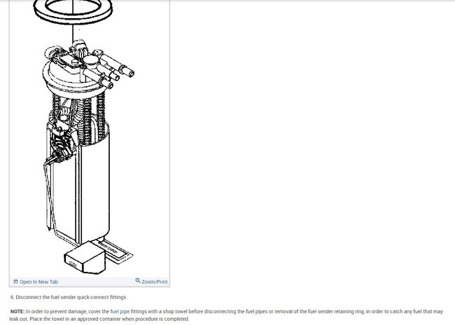

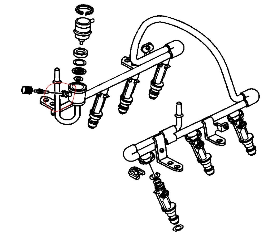

I recently changed the fuel pressure regulator and it started right after I changed it. The next day I went to start it and the car wouldn't turn over. You can also smell gas outside of the car. What could the problem could I be having?
Apr 5, 2021 at 1:15 AM
Good morning,
This sounds like you have an external leak. You need to check the lines from the rail back to the tank.
I would also check the actual fuel pressure to be sure the pump is working correctly.
Fuel Pressure (Key ON Engine OFF) .................... 364-405 kPa (53-59 psi)
