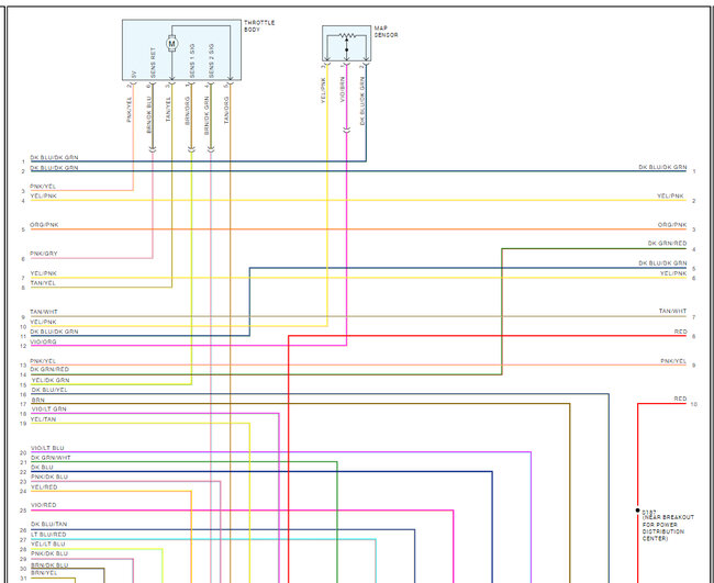

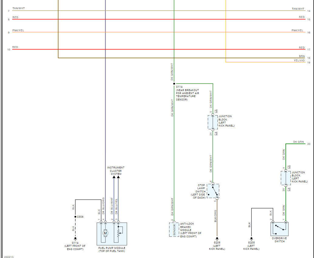

Where is the fuel pressure regulator or sensor located?
250,000 MILES • 5.7L • V8 • 4WD • AUTOMATIC
AEATON80
  • 6 POSTS
The vehicle listed above is a HEMI edition.
Sep 14, 2024 at 12:22 AM
  • 55,710 POSTS

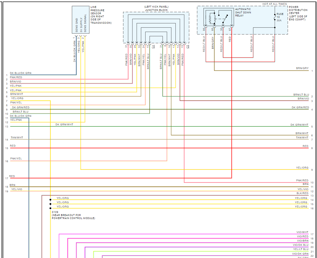

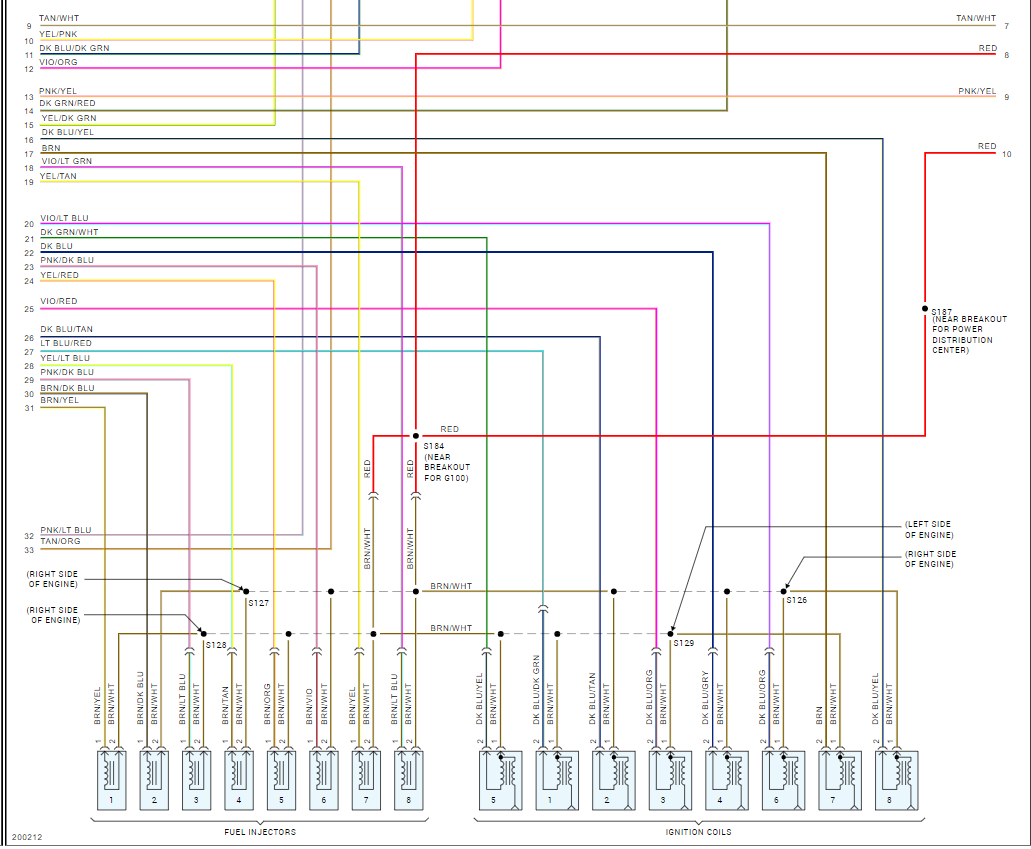

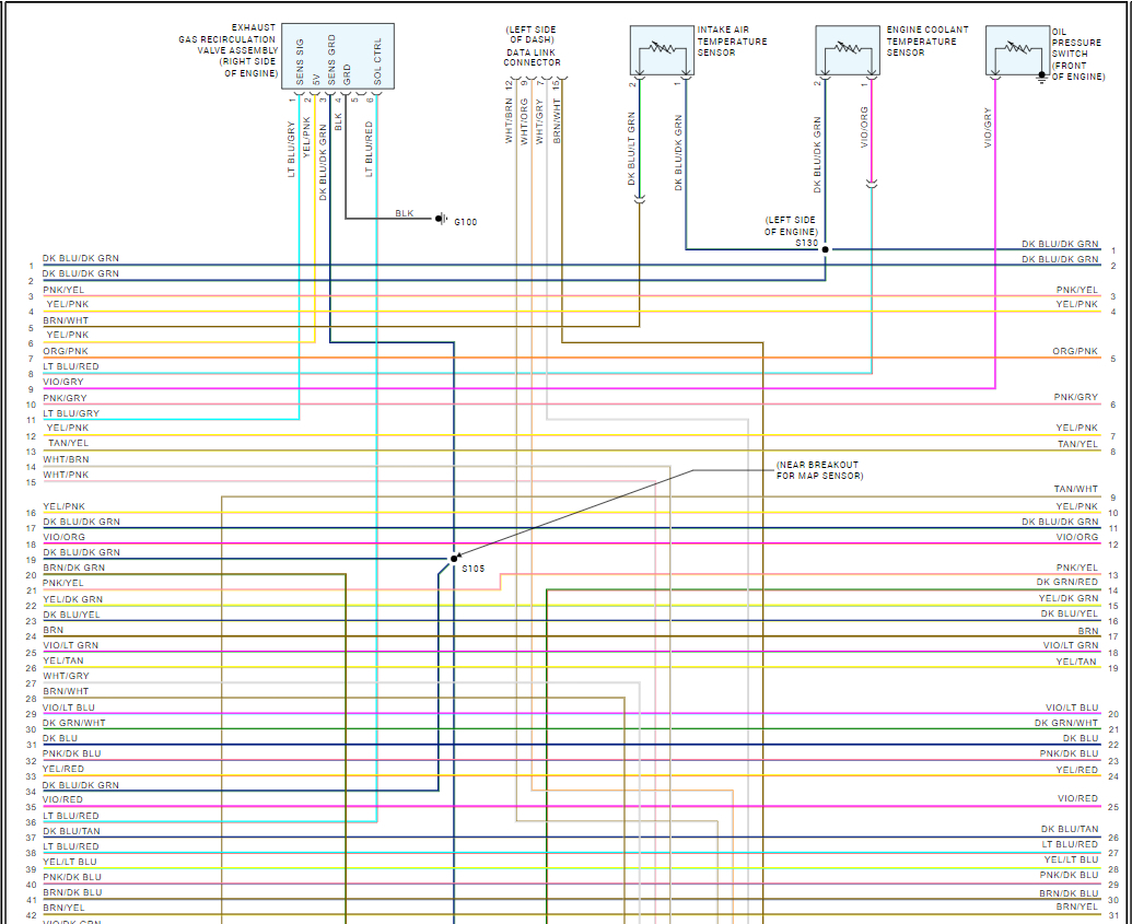

This engine /car does not seem to have a fuel pressure sensor.
Sep 14, 2024 at 12:10 PM
AEATON80
  • 6 POSTS
Your telling me the 05 Dodge 5.7 L HEMI does not have a fuel pressure sensor? That seems odd Ken.
Sep 15, 2024 at 12:50 AM
  • 55,710 POSTS

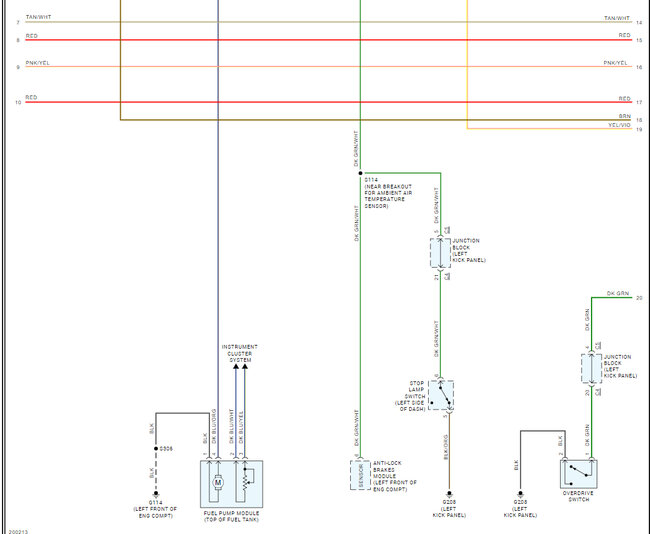

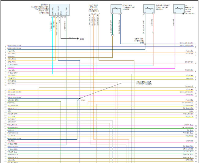

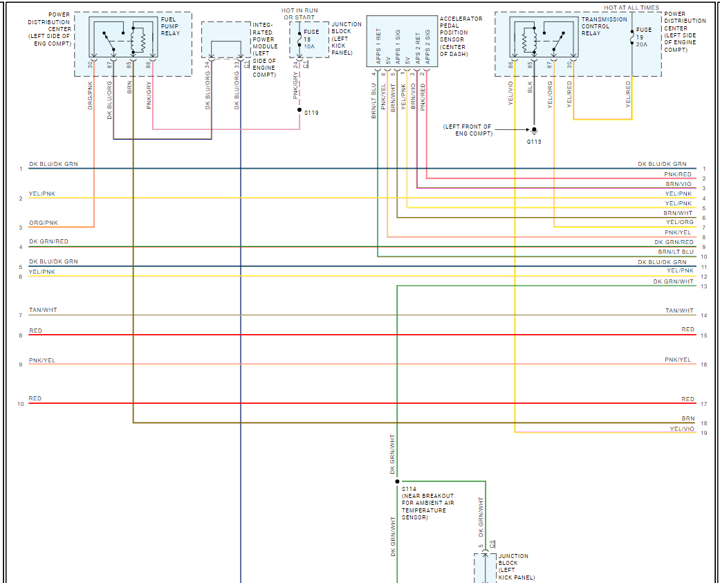

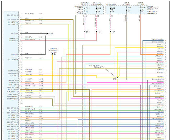

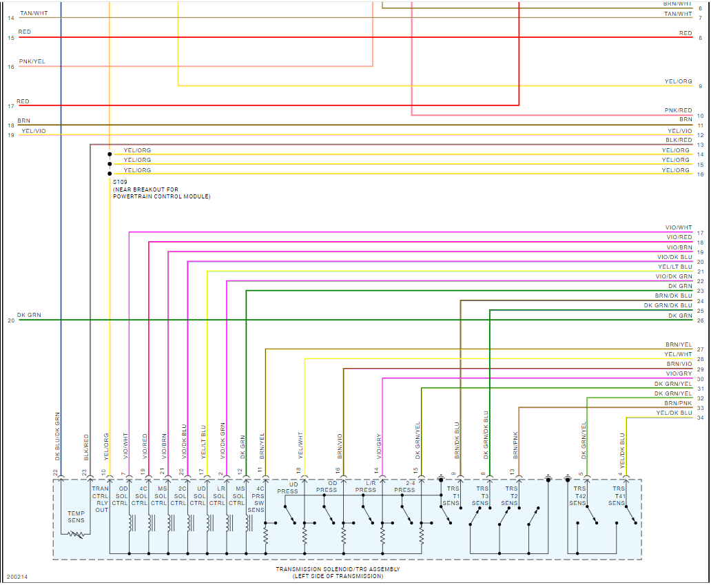

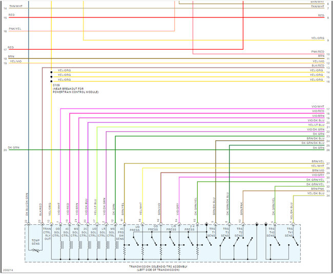

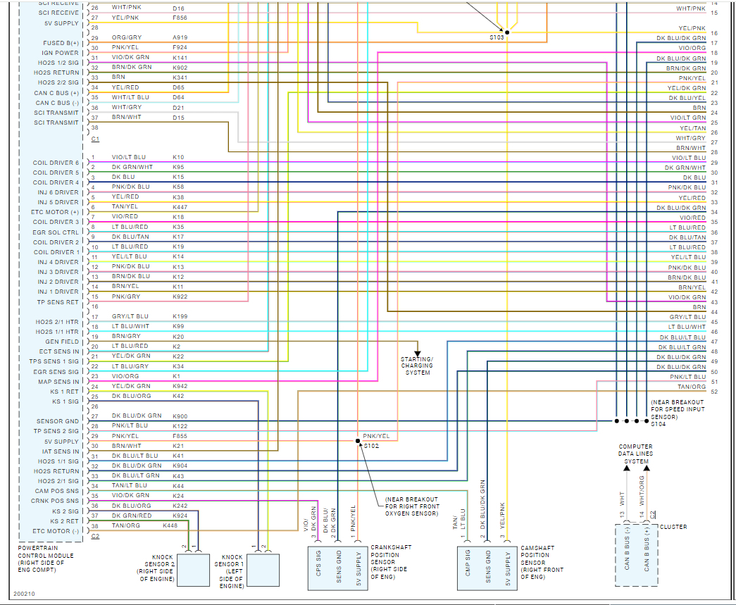

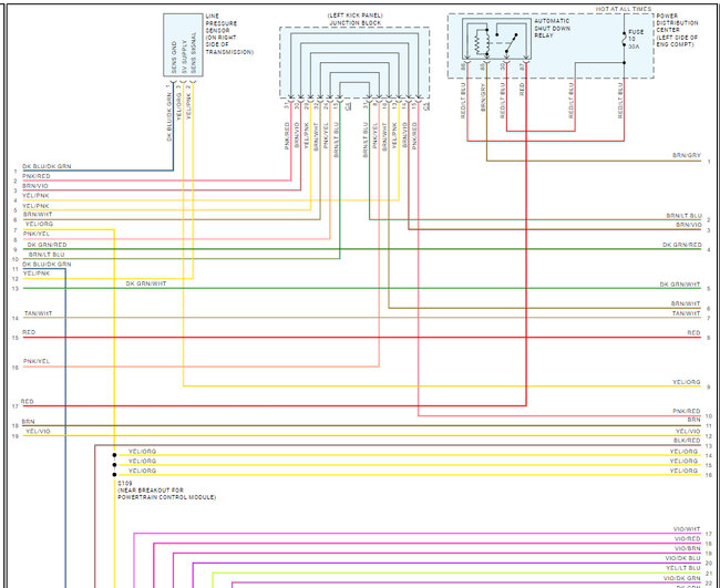

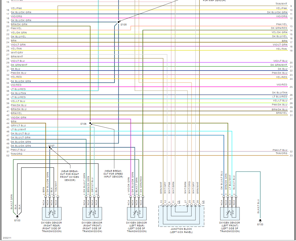

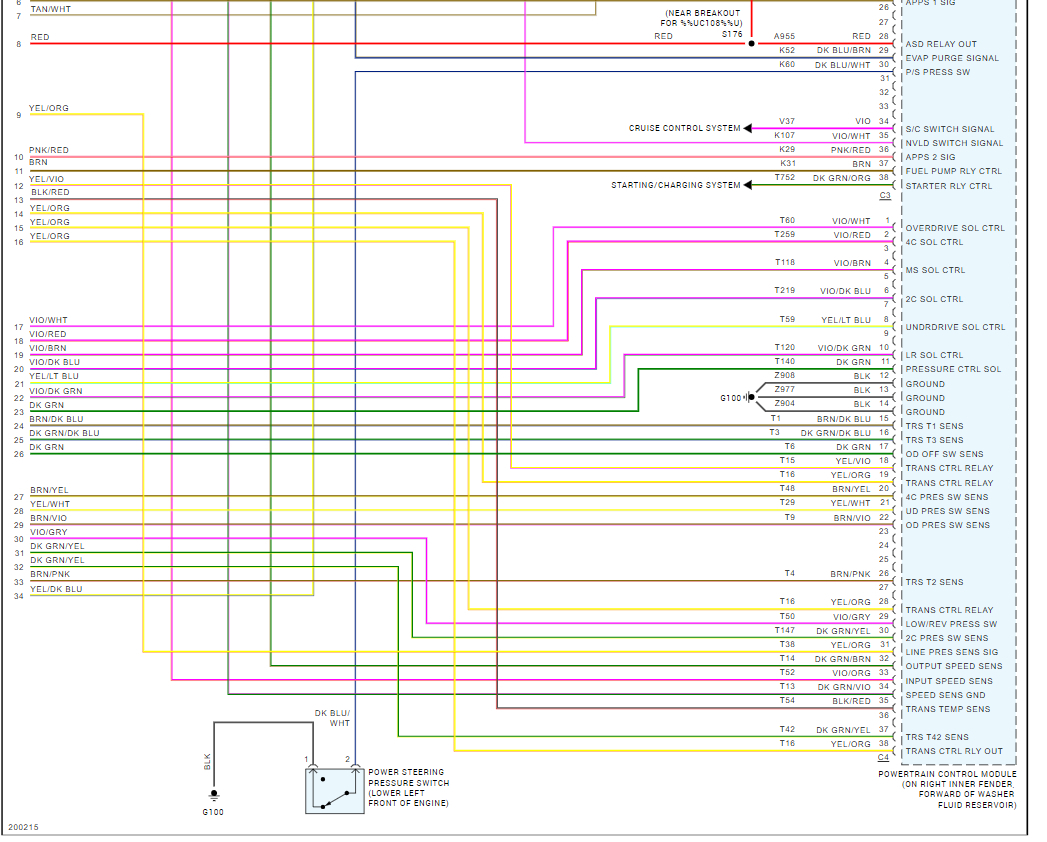

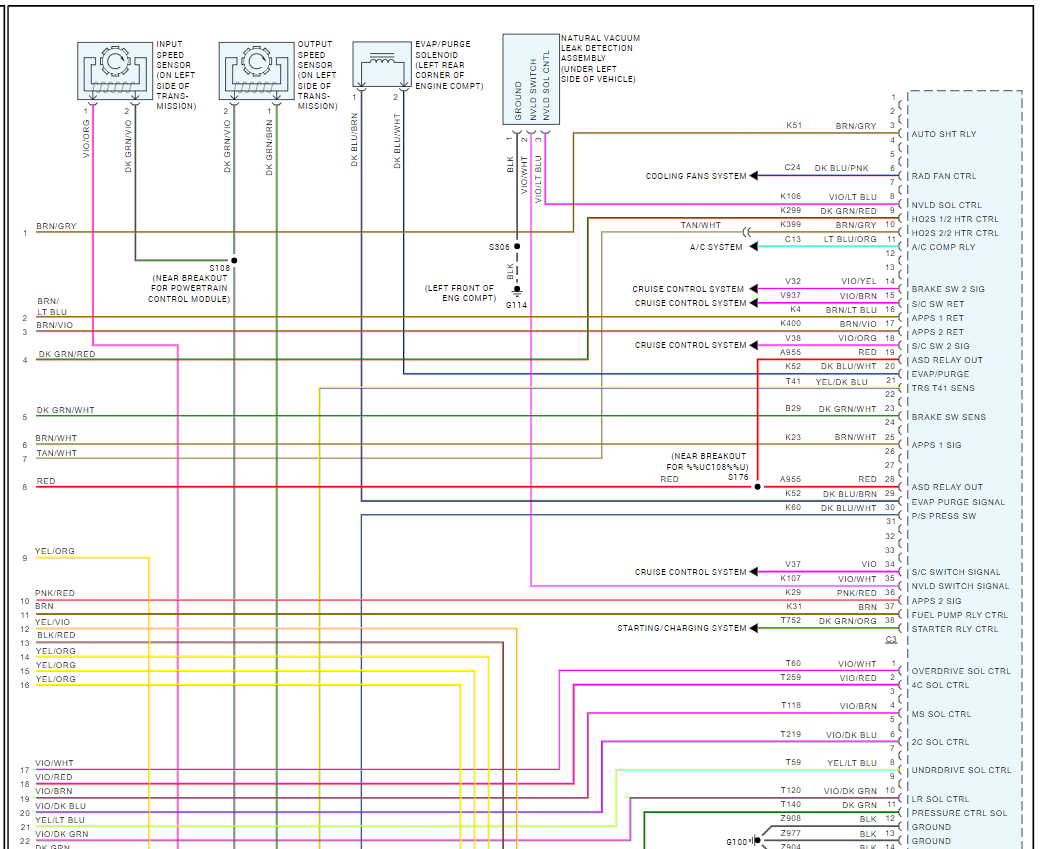

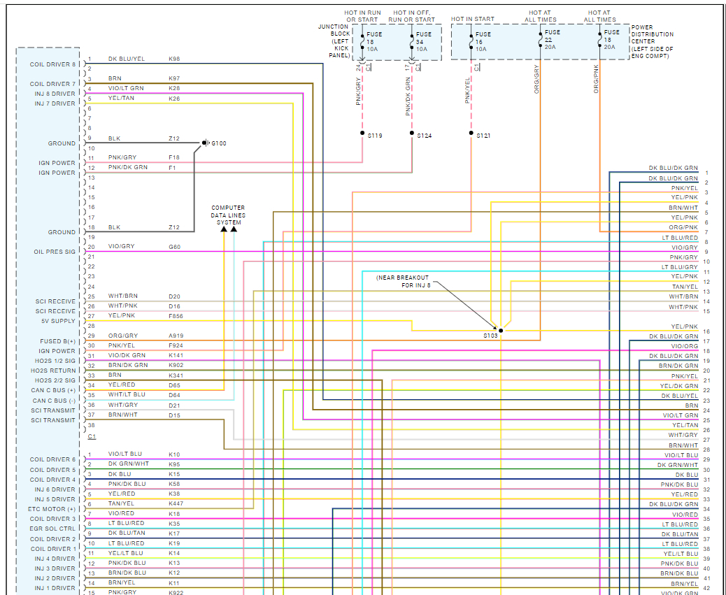

That is what I thought too but I checked twice, here are the engine wiring diagrams so you can see for yourself. Check out the images (below). Let us know if you need anything else.
Sep 15, 2024 at 2:49 AM
AEATON80
  • 6 POSTS
Well thanks Ken I appreciate it.
Sep 15, 2024 at 5:13 AM
AEATON80
  • 6 POSTS
Does it have a fuel pressure regulator?
Sep 15, 2024 at 5:14 AM
  • 55,710 POSTS
Our pleasure, the fuel pressure regulator is part of the fuel pump. If you are having an issue you need help with please start a new thread.
