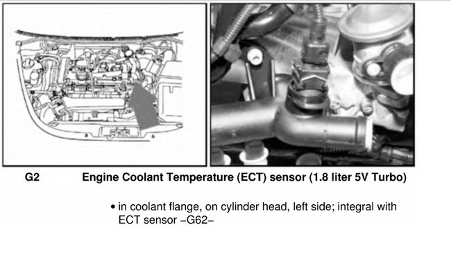

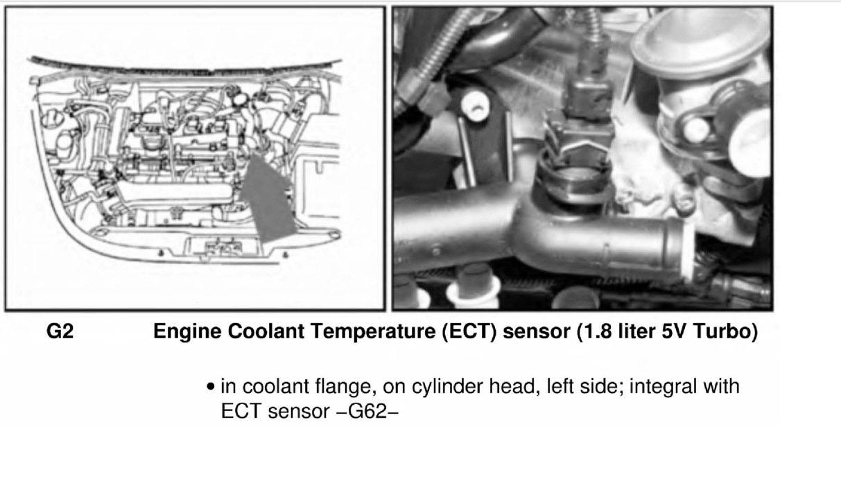

It almost sounds like it could be the engine coolant temperature sensor. It could be off but not enough to trigger a code.
Here is its location (below)
I would try a new sensor to see what happens
