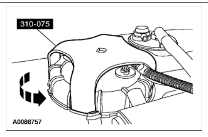

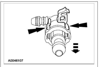

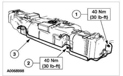

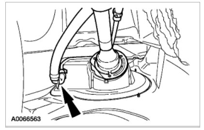

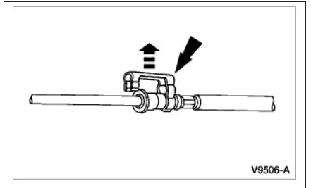

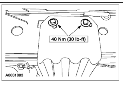

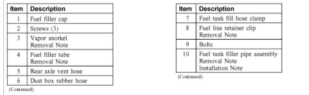

Where is the best place to install an inline fuel pump on this vehicle?
171,000 MILES • 4.0L • V6 • 2WD • AUTOMATIC
GUEROO
The OEM fuel pump stopped working, so i want to know where is the best spot to install one with the best results.
Aug 11, 2022 at 3:05 PM
  • 55,494 POSTS

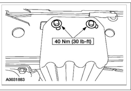

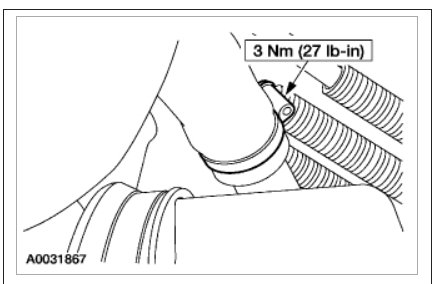

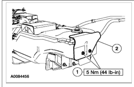

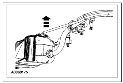

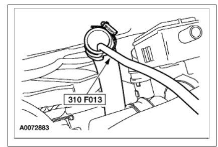

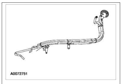

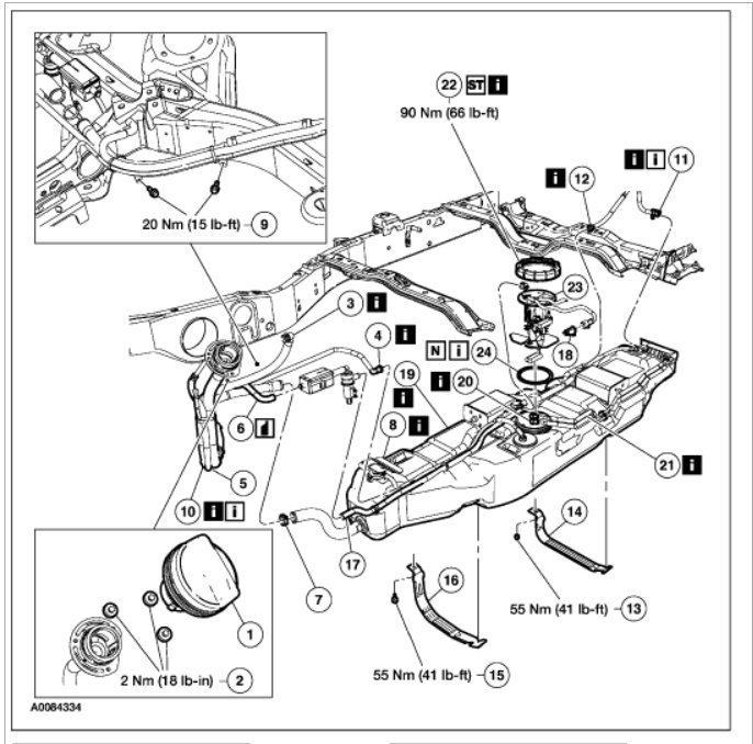

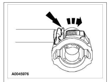

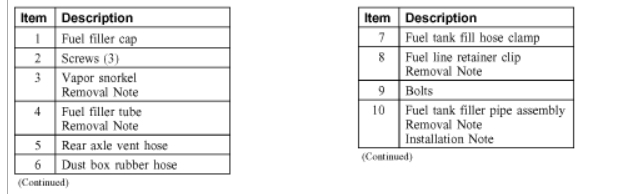

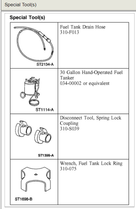

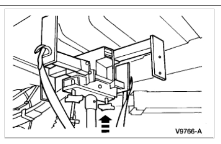

I don't think you can, you will need the inline pump to pull through the old pump in the tank, you will be better off replacing the pump inside the tank. Here are instructions on how to do it in the images below. This generic guide can help you see what you are in for when doing the job.
https://www.2carpros.com/articles/how-to-replace-an-electric-fuel-pump
