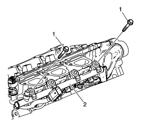

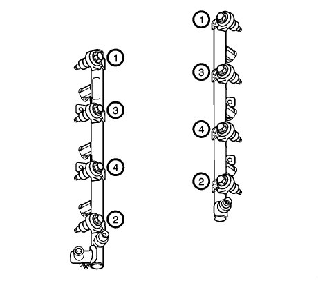

The car hesitates, (stop and go) and does not seem like there is not enough fuel getting to the engine.

Hi and thanks for using 2CarPros.com. Based on your post, it does sound fuel related. I would recommend checking fuel pressure to determine if it is within the manufacturer's specifications. Here are general directions for checking pressure:

Now the problem. You listed it as a 2008. They did not start production until 2010. Therefore, I will provide information for the 2010. If that is incorrect, please let me know. Additionally, there are two different engine options, a four cylinder and a six. I will provide information for both.
Starting with the 2.4L four cylinder:
Fuel pressure key on engine off: (40-65 psi).
3.0L V6 pressure is the same.
I attached two pictures of a fuel rail. That is what supplies fuel to the injectors. You will see at the end of the rail, there is a port (schrader valve). That is where you will attach a fuel pressure gauge. Most parts stores will lend you a gauge. Allow the vehicle to set for approximately two hours so fuel pressure drops in the system. When you attach the gauge, wrap a shop towel around the connection to capture any fuel that is released. Also, I suggest wearing eye protection. If the pressure is less than the specifications, the pump may be weak or you could have a clogged fuel filter.
