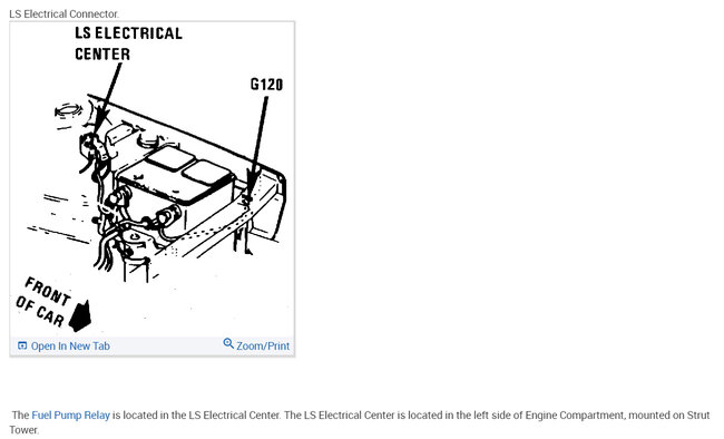

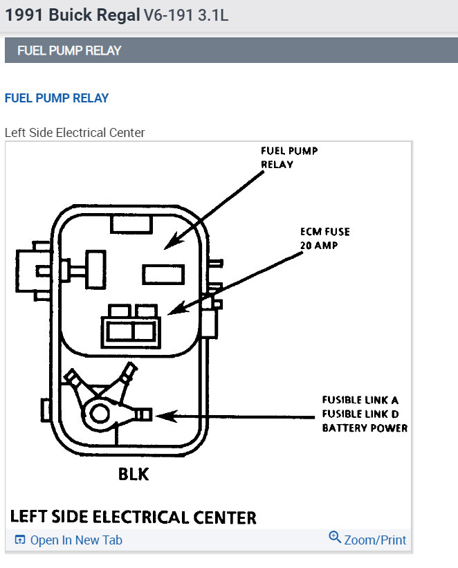

Engine shut off while driving, no fuel pressure pump was installed 3 months ago.
Sep 4, 2023 at 7:26 AM
  • 55,456 POSTS
It sounds like you have a defective fuel pump, but I would swap out the fuel pump relay. Here is the location. If that doesn't work replace the fuel pump.
