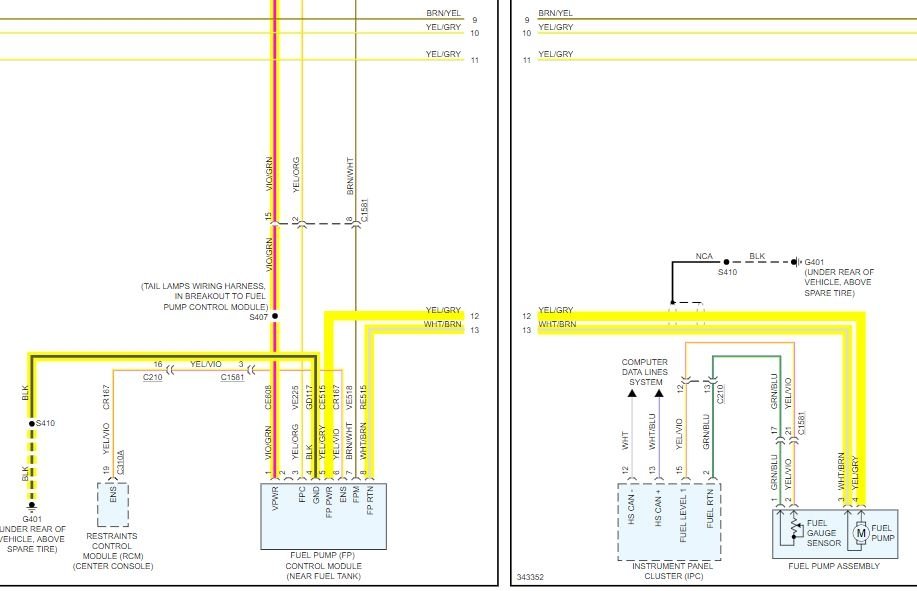

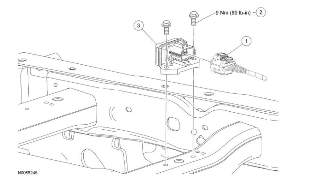

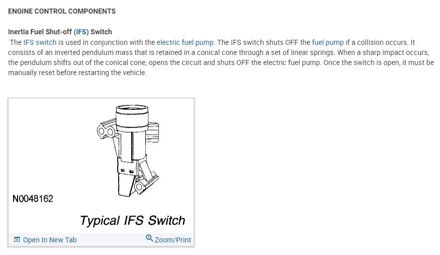

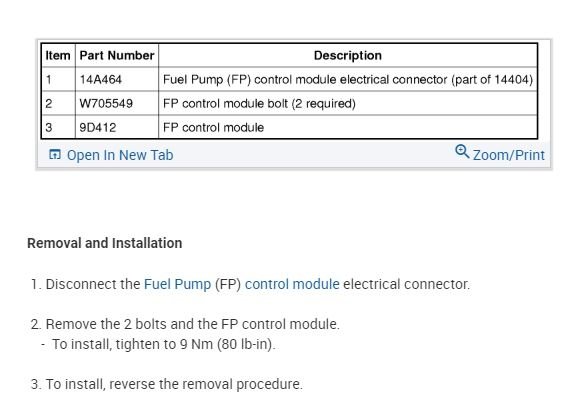

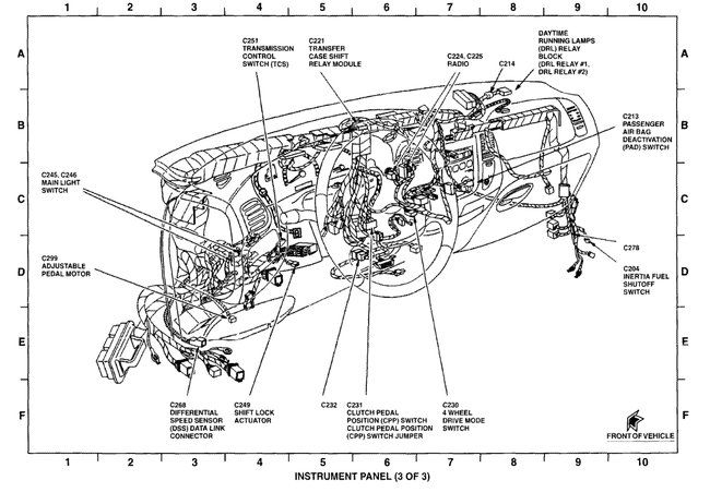

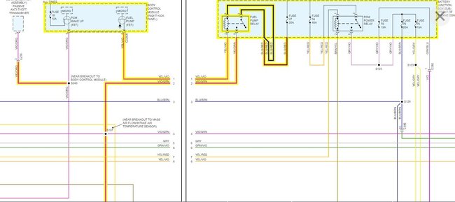

Hello, looking to find where the inertia shut off switch is located on the truck listed above flex fuel. the initial problem I am having is the truck cranks over but no start. When turning the key I do not here the pump turn on . Every thing else works in the truck but no start. I have read in the manual that is has fuel shut off and the procedure you do afterward which is turn to off and then on and repeat if necessary. I have tried many times with no result.. I have searched under dash for switch and cannot locate it.
Jan 9, 2020 at 8:55 AM
Good evening,
The switch is located at the right kick panel by the right front door. You should be able to see it at the top of the panel and you can push the reset as well.
Okay, a little glitch. The manual shows one at the location I told you.
The wiring diagram does not show it. There was a note that said if the switch is not there, the fuel pump control module is what controls the pump. It is back by the tank.

KRISTI RENYER
Also I have read some things about the fuel sensor module malfunctioning being common in an f150. Located near the spare tire, do you know anything about this?
Jan 18, 2021 at 9:41 AM (Merged)
HMAC300
  • 48,601 POSTS
I do not see any tips on this as normally if they go bad most mechanics put a tip in out manual with it. it would need to be scanned for codes by a mechanic to see if it is bad anyhow. If you spray choke cleaner into intake and truck starts it is probably a fuel problem but you would want it scanned prior to putting a module on it just to verify it. They cost anywhere from about $60 to 160 at rock auto, more at a dealer and a little more at a garage.

BMRFIXIT
  • 19,053 POSTS
Inertia Fuel Shut-Off Switch Located Under right side of dash # 7

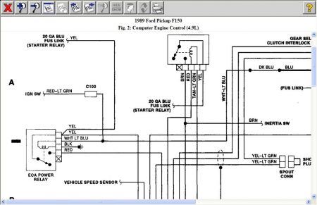

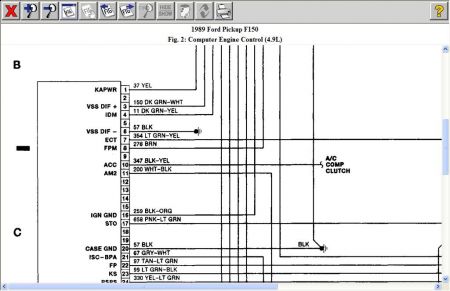

DALE8809
The truck will not start... When I turn the key on the fuel pumps run for a few seconds and then shut off. I tested voltage, grounds, and resistance at different pins on the EEC computer plug. Everything checked according to fordfuelinjection.com. When ground to the #6 pin of the EEC test plug the fuel pumps run nonstop. So, I replaced the EEC computer and am having the same result. The fuel pumps continue to shut off and I don't know what else the problem could be. Please advise. Thanks.
Jan 18, 2021 at 9:44 AM (Merged)
BLACKOP555
  • 10,386 POSTS
hthe fuel pump is only supposed to run for a few seconds and turn off.
it gets the pressure up and then turns off untill you get a response from the ignition ssytem to turn it back on.
is the fuel pressure building?
DALE8809
I say no because i can take the fuel line off on top of the tank and it still does the same thing. I read that with the fuel line off it should continue to pump, is that wrong?
BLACKOP555
  • 10,386 POSTS
well unles your vehicle has a sensor rigged on the fuel line for pressure that cuts out the relay then no there is no way disconecting the line will do that. it turns on primes the rail and turns off should turn off when you hear the relay click off. its located near the air cleaner box.
DALE8809
I dont think I was clear enough in my explanation earlier. The fuel pump is supposed to pump until proper pressure is built, no? So if you remove the fuel line, then the pressure cannot be built and pump should run and run, right? In oher words would the fuel pressure regulator still cut off pumps with fuel line disconnected? It still stops running.
Also, so long as I ground pin #6 on the EEC test connector, the pump will run all day.
We know the results of that test mean: I am getting power from EEC power relay to fuel pump relay coil, from the Fuse link at starter solenoid to fuel pump contacts common pin, from the ignition swith to EEC power relay coil, also that the fuel pump and EEC power relays are OK, Inertia swith is OK, selected fuel pump is ok, wiring and plugs are ok from fuel pump relay to pumps, ground for pumps is OK, and I am getting power from Ignition switch to EEC Power Relay Coil. Also, the test bypasses the EEC computer. That is why I replaced the EEC computer. So why does it work when grounding that pin only? (And could it be the Stater bad?)
BLACKOP555
  • 10,386 POSTS
when you bypass it it just turns on the system. the fuel should stop. and then turn back on when engine is cranked. if it keeps running. like in an accident and the relays and the pump still runs but the line is split it will keep pumping gas. which is a no no.
to find out if its good or not you need a fuel pressure check guage
  • 75,988 POSTS
Use a test light check for power before and after the blue fusible link 20ga at the starter relay if okay instead of pin 6 go to pin 20 and ground it and tell me what happened.
  • 75,988 POSTS
Sorry I cannot highlight the circuitry-not allowed

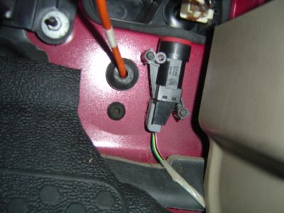

TOGATONY
Hi, I was driving down the highway and all of the sudden my truck died and it would crank over but not start. I have two gas tanks and switched to either...still would not start. I changed the fuel filter and now it will start and idle for a few minutes and die.Also, when I try to rev the engine it dies immediately. An auto parts store person told me he thought it was the ignition control module but I wanted to get your opinion.
Jun 1, 2021 at 3:00 AM (Merged)
RACEFAN966
  • 5,029 POSTS
The inertia switch is behind the right (passenger) side kick panel. As for the computer I have only replaced about 2 computer on a Ford in more then 20 yrs of doing this. If the switch is not causing this then I would like to check the fuel tank switching valve next. Here is a pic of what you are looking for and what you do is just push the red button this resets it and see if it will start. Let me know how that goes.
https://images.2carpros.com/forum/automotive_pictures/249564_DSC01070_1.jpg
TOGATONY
I found the inertia switch and the red button was pushed in. There was a slot that was to the side of the button and when I put a screwdriver in it the button popped up. I tried pushing it in again but this did not help. I even tried starting it with the inertia button up but I couldn't even get it to start in that position. So I guess we are off to the next item. let me know how to check the fuel tank switching valve (location would help also). I don't know if this helps or not but the truck will start and run longer on the rear tank than the front tank. neither will stay running however.
RACEFAN966
  • 5,029 POSTS
Ok remind me how old is the fuel filter? As for the switching valve it under the truck on the frame or crossover. You will need to check the red wire with the yellow stripe and make it has power to it and then you need to check the red wire to the front tank for power when on front tank and the brown wire with the white stipe on the rear tank when rear tank is selected. Now you still should check the fuel pump relay to make sure it is working as this will also affect both tanks. Let me know what you find.
TOGATONY
The tank switch seems to be working fine. I replaced the fuel filter and I replaced the fuel relay. These helped the situation thank you.
