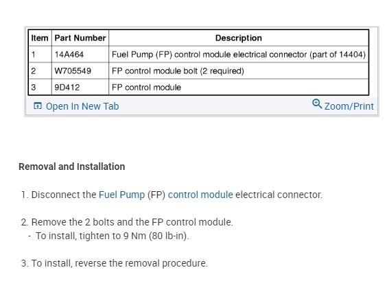

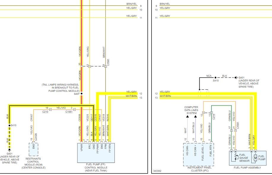

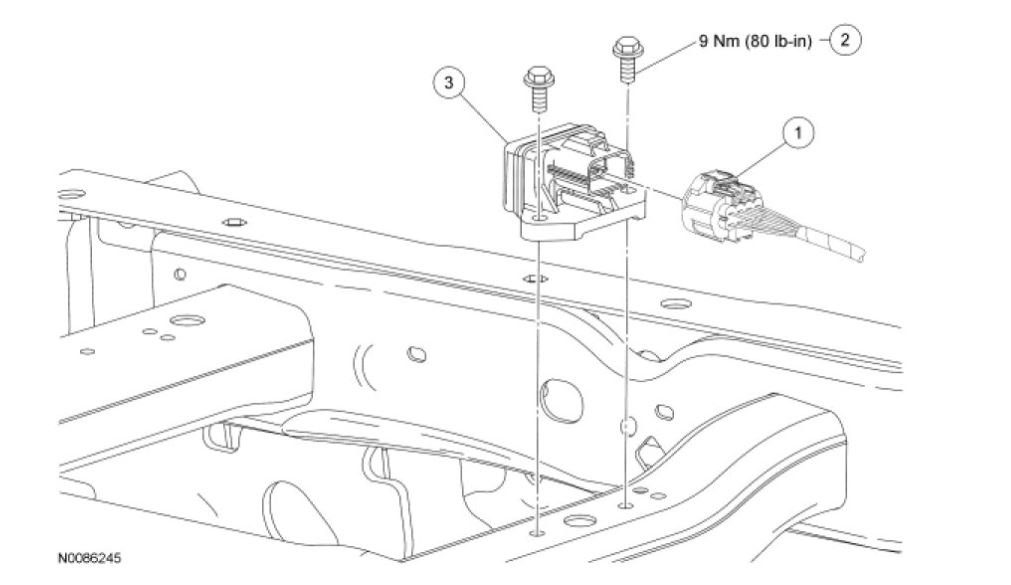

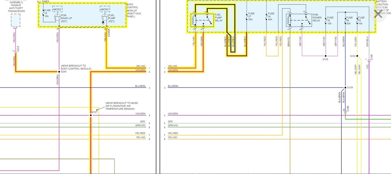

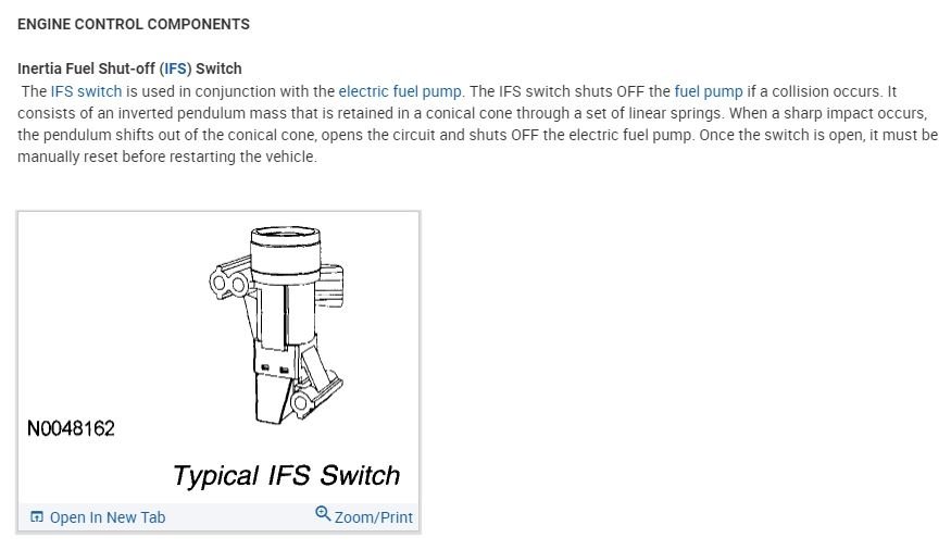

Hello, looking to find where the inertia shut off switch is located on the truck listed above flex fuel. the initial problem I am having is the truck cranks over but no start. When turning the key I do not here the pump turn on . Every thing else works in the truck but no start. I have read in the manual that is has fuel shut off and the procedure you do afterward which is turn to off and then on and repeat if necessary. I have tried many times with no result.. I have searched under dash for switch and cannot locate it.
Jan 9, 2020 at 4:55 PM
Good evening,
The switch is located at the right kick panel by the right front door. You should be able to see it at the top of the panel and you can push the reset as well.
Okay, a little glitch. The manual shows one at the location I told you.
The wiring diagram does not show it. There was a note that said if the switch is not there, the fuel pump control module is what controls the pump. It is back by the tank.

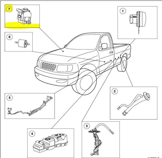

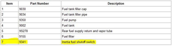

TULEGRL
fuel injection reset switch for a 2002
f150
Jan 18, 2021 at 5:42 PM (Merged)
BMRFIXIT
  • 19,053 POSTS

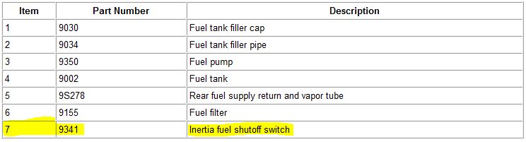

Inertia Fuel Shut-Off Switch Located Under right side of dash # 7

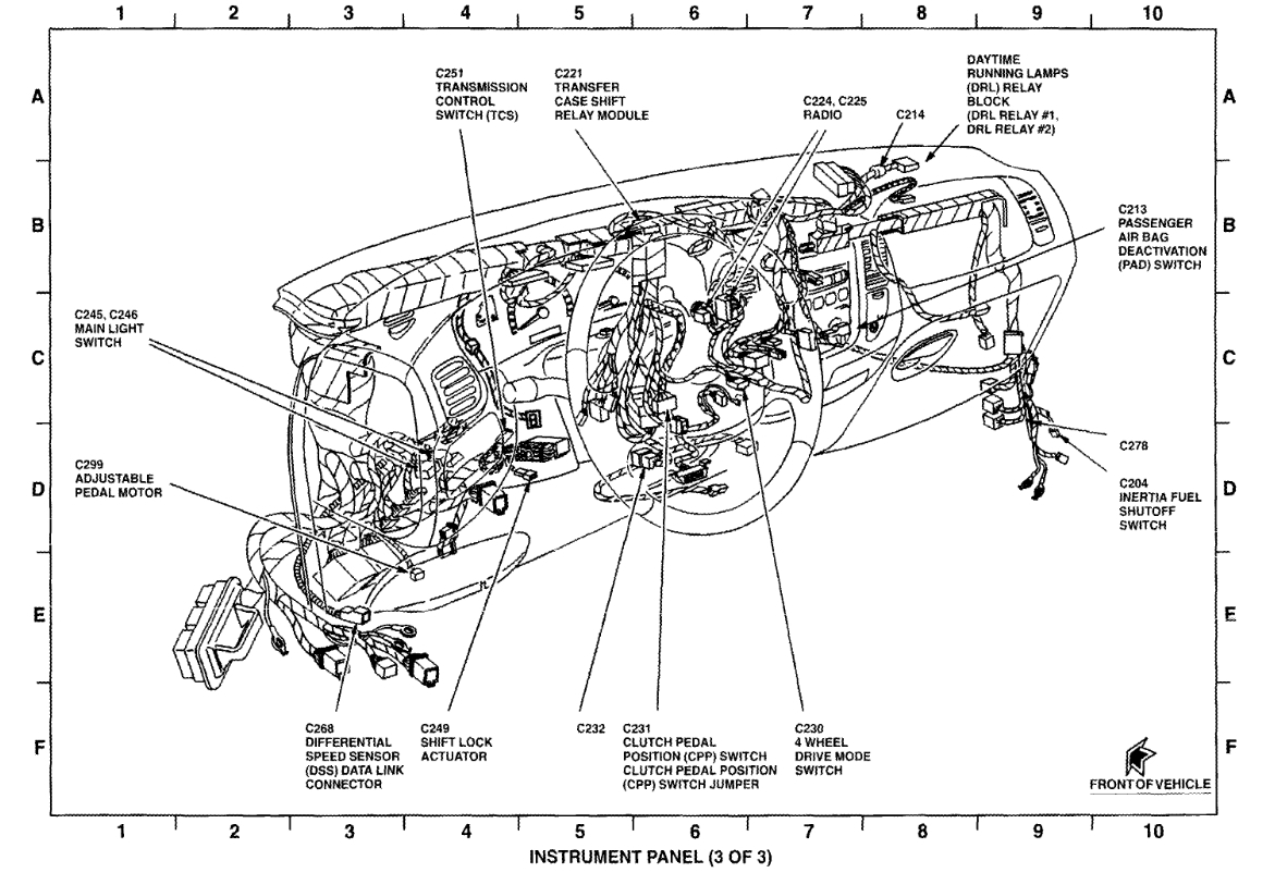

The inertia switch is located near the passengers side kick panel. Check out the diagrams (Below). Please let us know if you need anything else to get the problem fixed.

In the passenger compartment, on the passenger side, below the dash, behind the right kickpanel.
So if you are sitting in the paseenger seat and take your right ankle and move it to the right you'll be kicking the kick panel that you need to remove.

If you have a console in the truck, it will be on one side or the other forward nexe to the firewall. If no console, it in the kick panel on on side or the other up next to the firewall.
