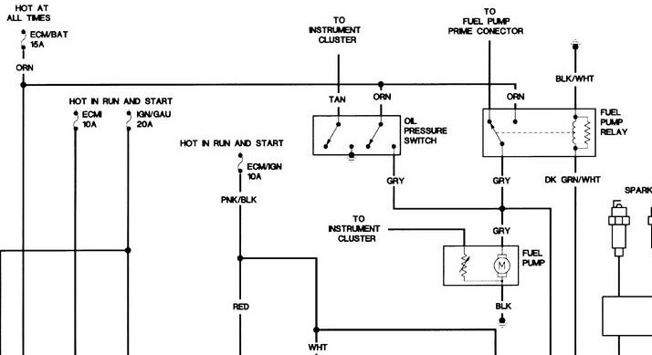

My truck will run fine when it wants to, then it just shuts off like it is starving for fuel. Start it and play with the accelerator for a while and it will do good for a few minutes days, or miles. I have already replaced the fuel filter and pump and still, at an inopportune moment it shuts off. Would the fuel pressure sensor act like this or if it were bad would the truck just not run? There are no codes entered in the OBC other than weak "spark knock sensor" and that was also an on/off thing not in conjunction with the engine shutting off.

How long since over-all tune-up? If you think a fuel issue, did you check fuel pressure? With TBI the pressure is usually around 9-13 psi. Can you see the fuel injector/s spray pattern?

I put in new plugs and wires at the same time I changed the fuel filter (about two hundred miles ago). I had a friend test the pressure and he said it was at 11.5. That was with the old fuel pump, but he said he did not think that would matter because it was running good just before he tested it. he has have told me and I have read that the original fuel pumps in the S-10's were not the best. so I connected a wire from the tank to the frame to ensure a good ground, and when that did not work I put in the new fuel pump. It has the throttle body Injection and I am thinking of replacing the relay next, but I do not like spending money.

Talking about the fuel issue, there is an oil pressure switch in the fuel pump circuit. It is just a redundant power supply to the pump. As long as that switch is functional and has voltage, the pump will run, even without the fuel pump relay.
