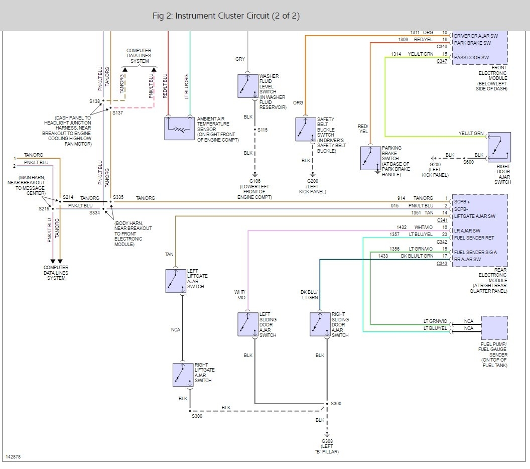

The fuel gauge does not work and the seatbelt light does not go off.
Jan 1, 2017 at 9:50 AM
  • 55,721 POSTS
Hey DARRON,

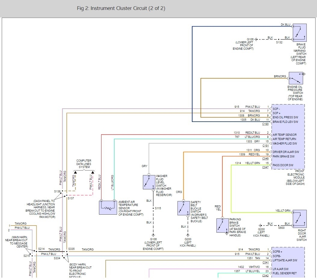

It looks like you have a front or rear electronic model that has gone out, check all fuses first though, here is a wiring diagram so you can see how they are related.
Please run some tests and get back to us so we can continue helping you.
Best, Ken
