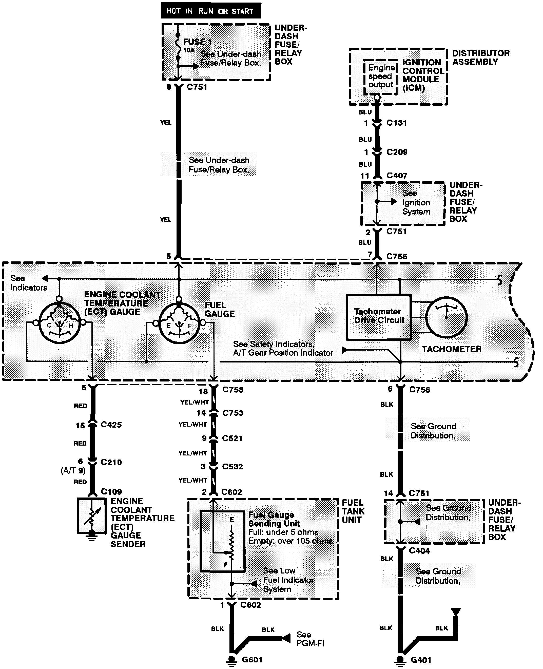

My fuel and temperature gauge stopped working so I am wiring aftermarket ones. What is the sending wire to tie into for the fuel sending unit and what are the ohms empty and full so I can set my gauge?

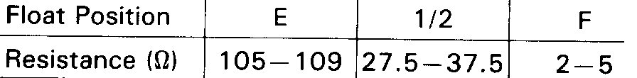

I have attached two pictures for you to see. The first one is a wiring schematic for the system. It looks like you will need to find a yellow/white wire. The second picture shows the ohms of resistance based on fuel level.
Let me know if this is what you needed or if you have other questions.

Okay, I thought mine was 240 E and 33 F as far as the wiring diagram I cannot tell from that I have tried the yellow and white wire but got no reading when I try the yell and red wire I get a reading but does not look correct for ohms? I will try setting the gauge for them readings tomorrow and see what happens.

I tapped into the yellow/white wire and I get an ohm reading 33-240, but once I cut the car on it stops reading . My aftermarket will not read on any setting but the factory gauge says half a tank. I also tried other wires with no luck not sure what to do. If I get aftermarket fuel level sending unit I have to modify it to fit. The factory gauge is fixing to go out I have had it go out before and I refuse to keep paying that crazy price for that chip it actually burnt up last time.

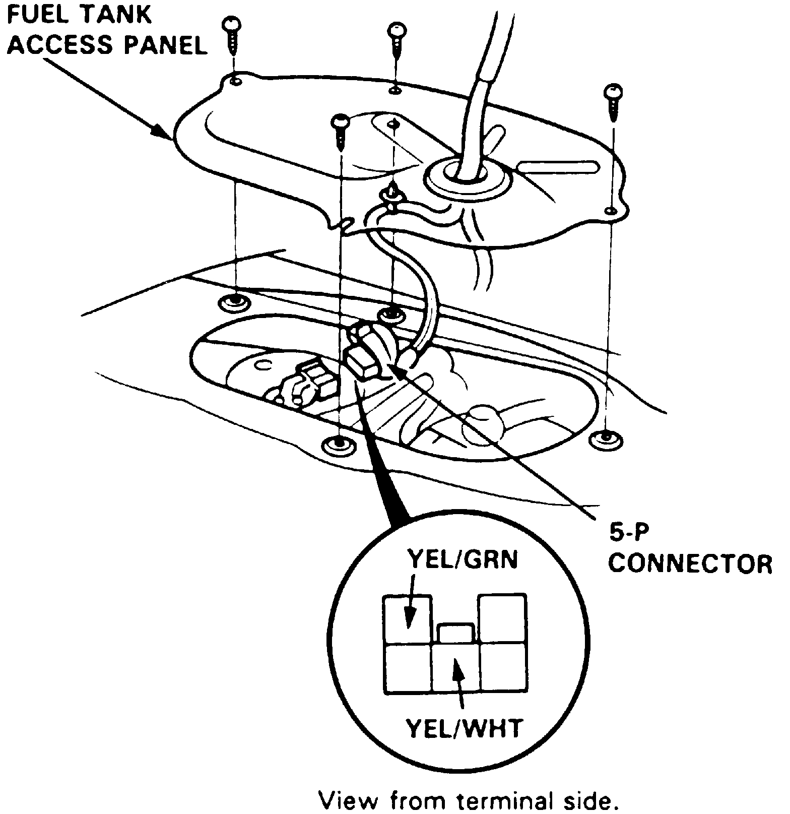

The gauge you purchased requires a supply and ground. Is that correct? If so, I am starting to question a ground issue. Do me a favor, at the 5 pin connector, perform this test.
COMPONENT TESTS AND GENERAL DIAGNOSTICS
1. Check No. 13 (10A) fuse in under dash fuse/relay box before testing.
2. Disconnect 5-P connector from fuel gauge sending unit.
Fig. 5 Fuel Gauge Sending Unit (See pic 1)
3. Connect voltmeter positive probe to yellow/green terminal and negative probe to ground, then turn ignition switch to On position, Fig. 5.
4. Voltage should be between 5-8 volts.
5. If voltage is not as specified, check the following:
a. Check open yellow or yellow/green wire.
b. Check blown fuse or poor ground.
6. Turn ignition switch On, then check as pointer of fuel gauge starts moving toward F mark. Turn ignition switch to Off before pointer reaches F mark on gauge dial. Failure to do so may damage fuel gauge.
7. If pointer of fuel gauge does not move, replace gauge.
8. If gauge is satisfactory, inspect fuel gauge and sending unit.
_____________________
Let me know what you find.
