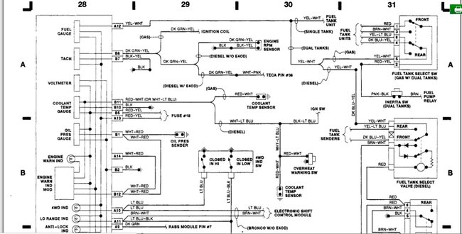

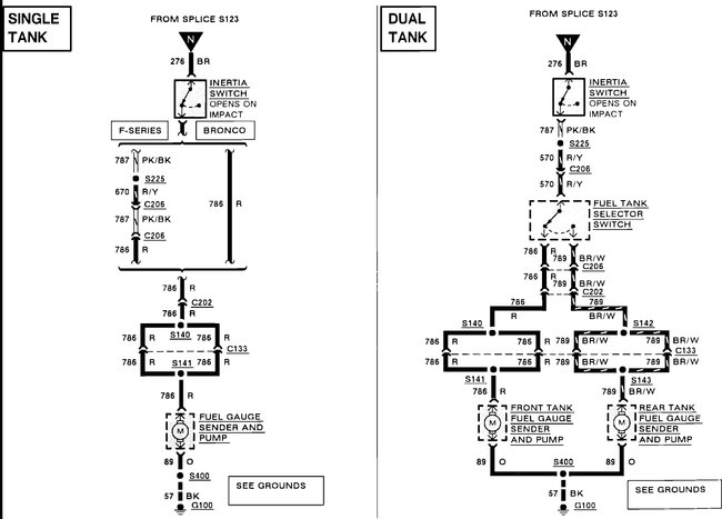

I am trying to wire my front fuel pump sending unit. I have a red wire, black wire, orange wire, and green/white wire. I do not which wire goes where.
Do you have a diagram that I can go buy?

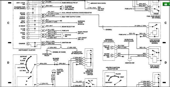

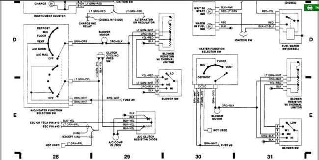

Got this from "Prodemand"
Had to make three screenshots
This is one diagram, in three pieces, I insured the pieces overlapped.
Let me know if this is what you need.
First stacks on top of second, second stacks on top of third.
Keep us posted on progress!

Here you go.
