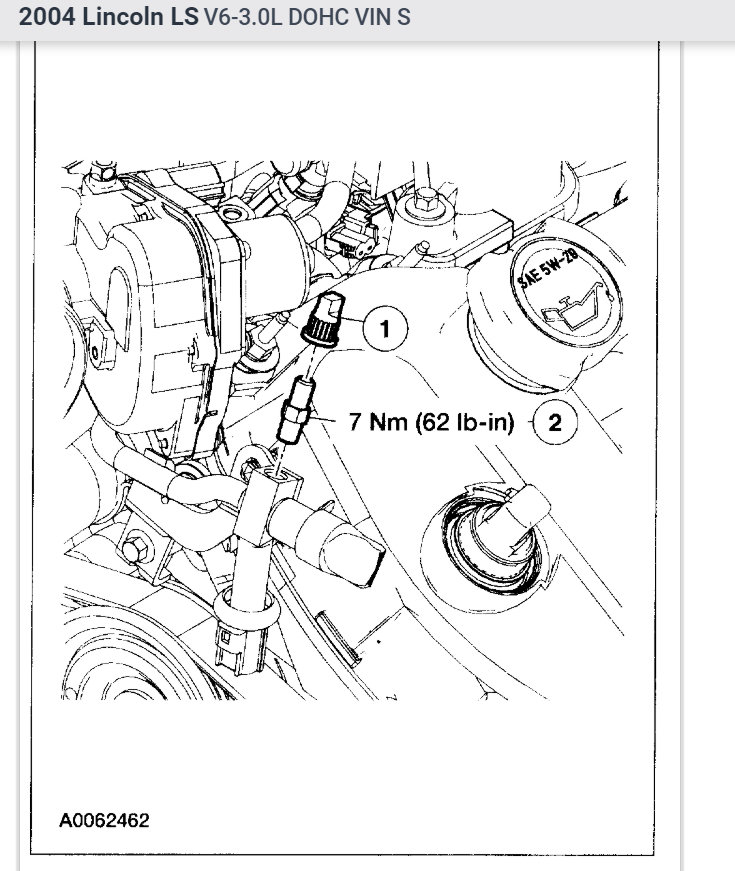

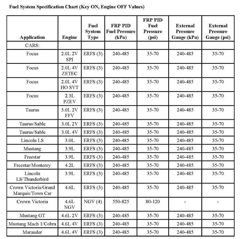

Replaced pump, fuel pressure regulator, filter, starts then stalls. need to know how to check the fuel pump sender on the driver side?

It sounds like you want to check the fuel pressure? This guide will help with the location of the pressure port in the diagrams below:
