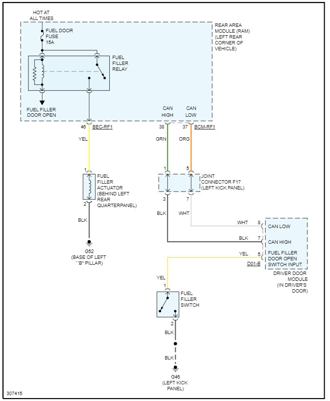

The interior button that releases the fuel door for refueling has broken. We cannot find a replacement part. It has literally fallen down inside the door. We can use the manual release pull in the trunk, but it's kind of inconvenient. LOL

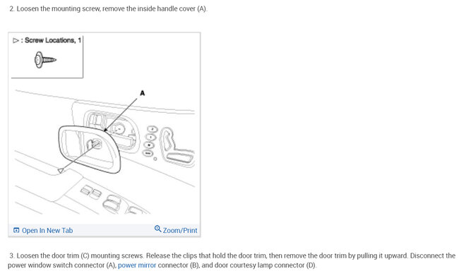

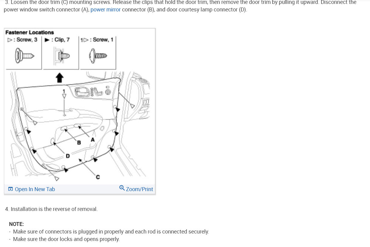

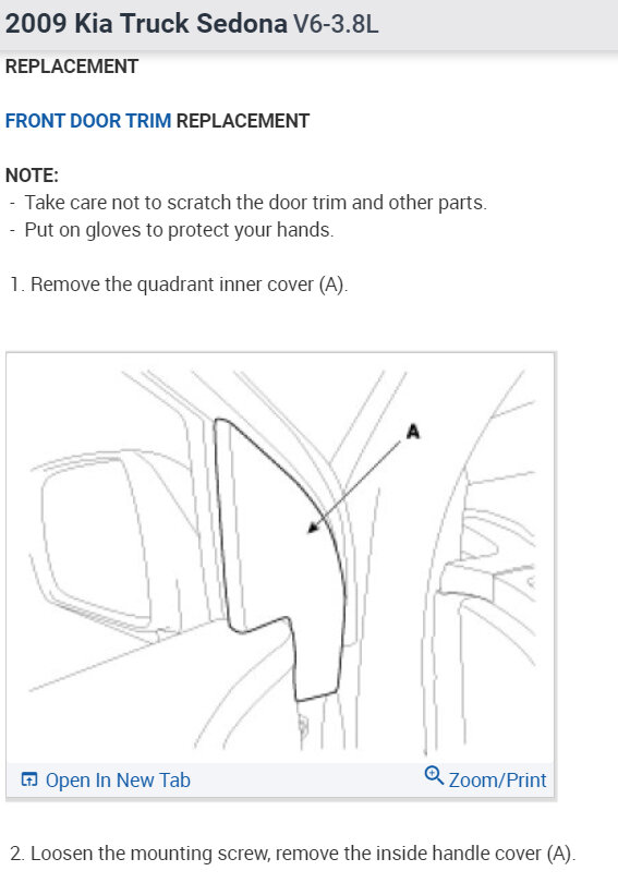

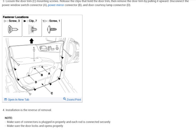

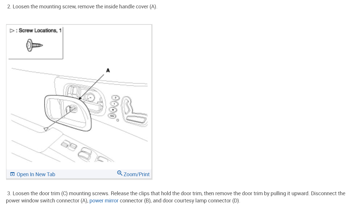

The button is a simple ground connection so you can touch the yellow wire of the switch to ground, and it will open the gas door, or you can remove the door panel to fix it correctly. Here is how, Check out the images (below). Please let us know if you need anything else to get the problem fixed.
