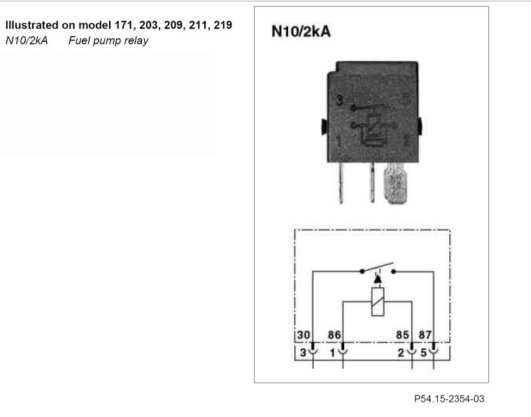

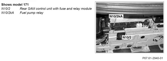

Where is the fuel relay located?
Jul 31, 2017 at 11:10 AM
Experienced Mechanic
55,560 POSTS
Here is a guide and a diagram that will help you get back on the road.
and
The relay is in the trunk next to the SAM module (below)
