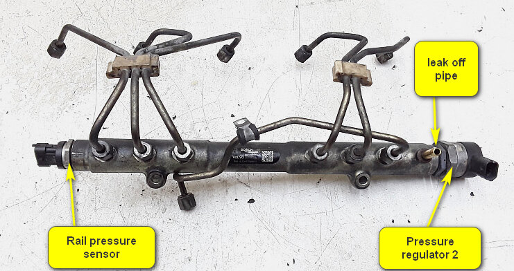

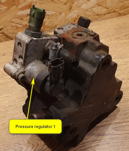

P0090 - fuel pressure regulator 1
The fuel pressure regulator is located at the back of the high-pressure diesel pump.
See image 2 below.
This fault usually sets if the rail pressure is lower than desired.
The rail pressure is sent by the rail pressure sensor to the ECM.
At cranking we should see rail pressure of more than 200 Bar, 2900psi.
This you can check using a suitable diagnostic tool, it will show actual and desired pressure.
Also check that fuel pressure regulator 2 is shut while cranking, this you can checked by removing the leak off pipe at the rail. Ensure no fuel leaks out while cranking.
See image 1 below.

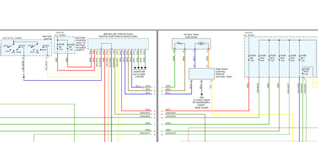

I have volvo v70 d5 automatic diesel got new fuel pump put in but relay not going Sent away Got it fixed put back in car now the fuel pump Not working and no fuel getting to engine at all Trying to find exactly what and where fuses are is my nightmare.

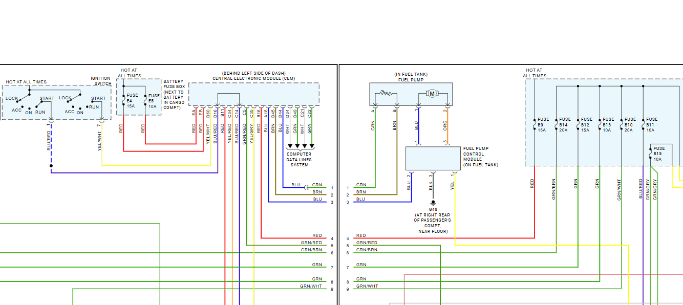

It looks like there is a fuel pump control module that runs the fuel system which I have seen go out. Here is the wiring diagrams so you can see what I am talking about. Check out the images (below). Please let us know what happens.

Okay thanks, will look tomorrow someone said PEM might need replacing nightmare to find still looking think I need to drop fuel tank as plastic one and be on top will keep you posted.
