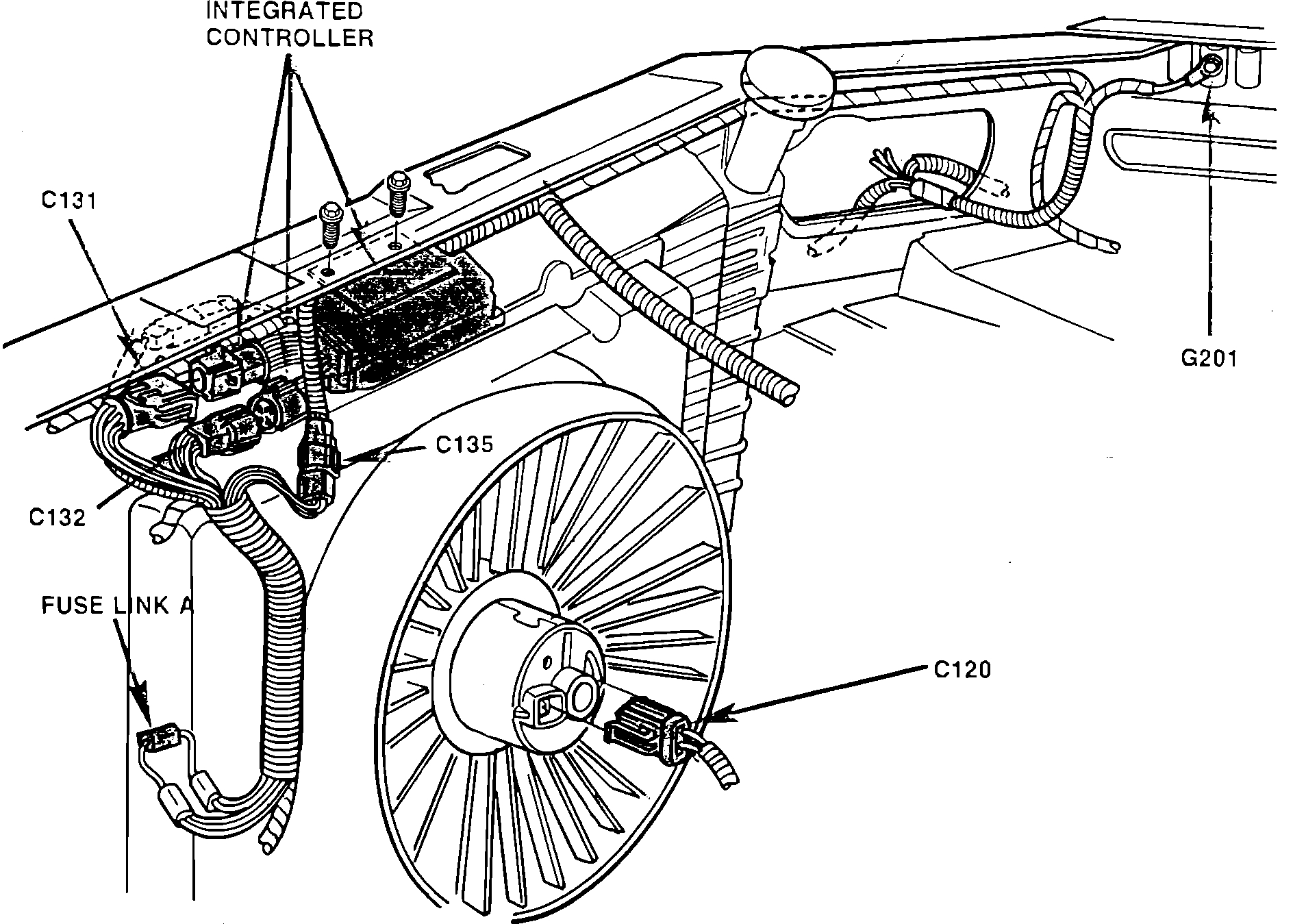

Where is fuel relay located on my car listed above? It has a 3.0 liter engine.
Sep 12, 2018 at 8:42 AM
  • 110,244 POSTS
The fuel pump relay is not a typical relay that can be replaced. It is part of the Integrated Control Relay Module and is located at the front of the engine compartment, on the upper radiator support. I attached a picture of its location.

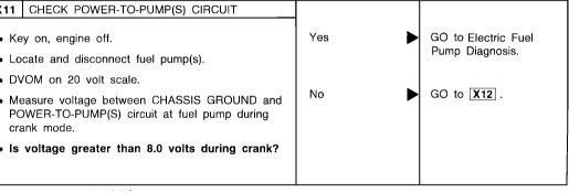

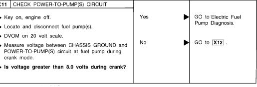

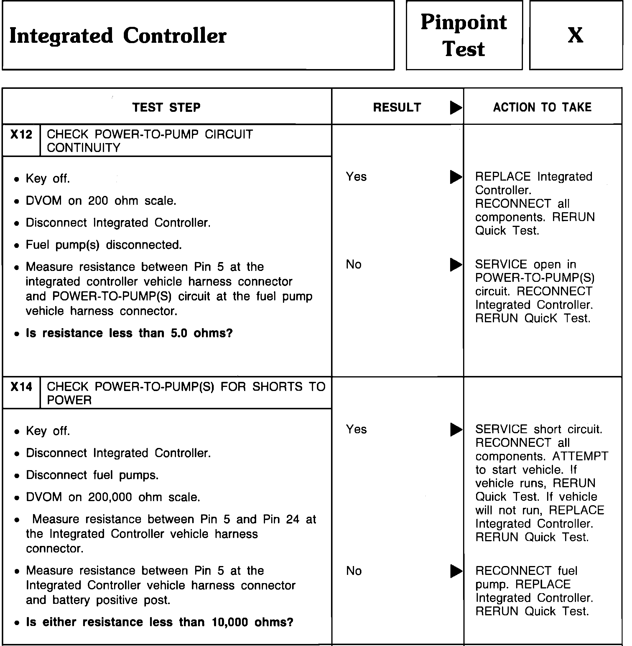

How can I test it to find out if it is causing fuel pump not to work? I cut the fuel shut off wires and spiced them together. Put test light on wires and got nothing. So as far as I can tell I do not have power to that point.
Sep 12, 2018 at 12:55 PM
  • 110,244 POSTS
Here are the diagnostic procedures for testing the relay module. See pictures.
Let me know if it helps.

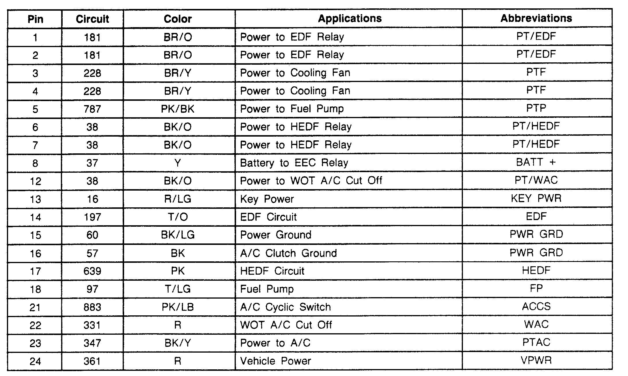

Thank you so much for your time on this issue. Could you please send a picture. That is not blurry I cannot read anything on the picture.
Sep 12, 2018 at 7:21 PM
  • 110,244 POSTS
Hi again. I will try again. I am not sure what happened, but they are clear on my end. Let me know if this is better. You may need to copy and paste it into a paint or word document so it can be enlarged.

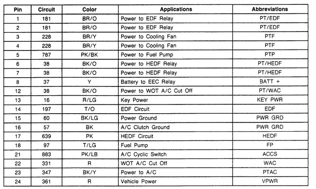

Five wires that go into fuel tank. Which one do I jump to test fuel pump?
Sep 19, 2018 at 8:43 AM
  • 110,244 POSTS
Hi again. The power supply should be a pink and black wire. See the attached table for wire designations and colors.
