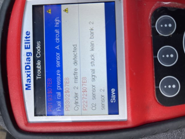

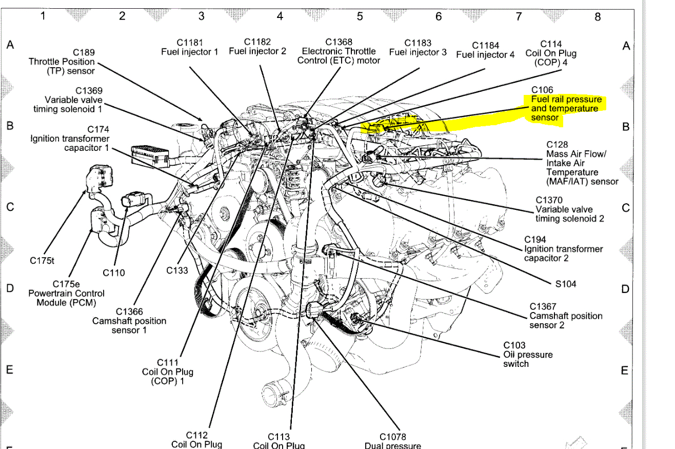

Have these codes. Car runs and drives but i can tell something isn't right, the intermittent is most likely from the coil but the fuel sensor is that common on these? And where is it located?
Sep 28, 2021 at 5:21 PM
DIVIDES
  • 903 POSTS
Here it is, help with which o2 as well will be appreciated.
Sep 28, 2021 at 5:29 PM
  • 110,194 POSTS

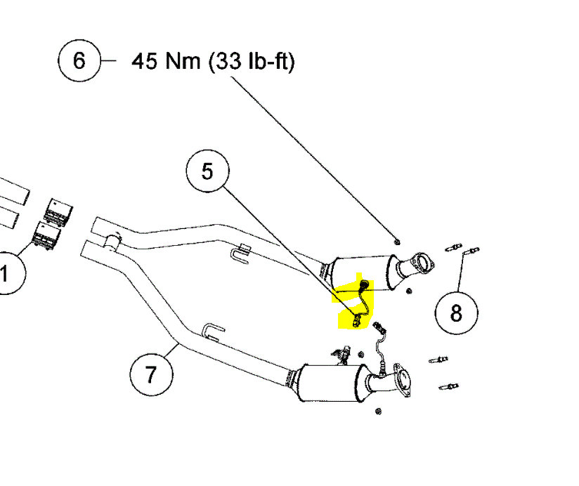

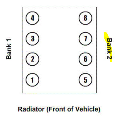

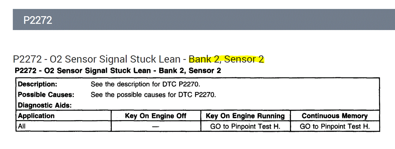

The oxygen sensor (bank 2 sensor 2) will be on the driver's side. See pics 1 to 3 below.
Now, the idea that it is stuck lean could mean a few things. However, the first thing I would check for is either low fuel pressure or an engine vacuum leak. A leak or low pressure can be the cause of the misfire code as well.

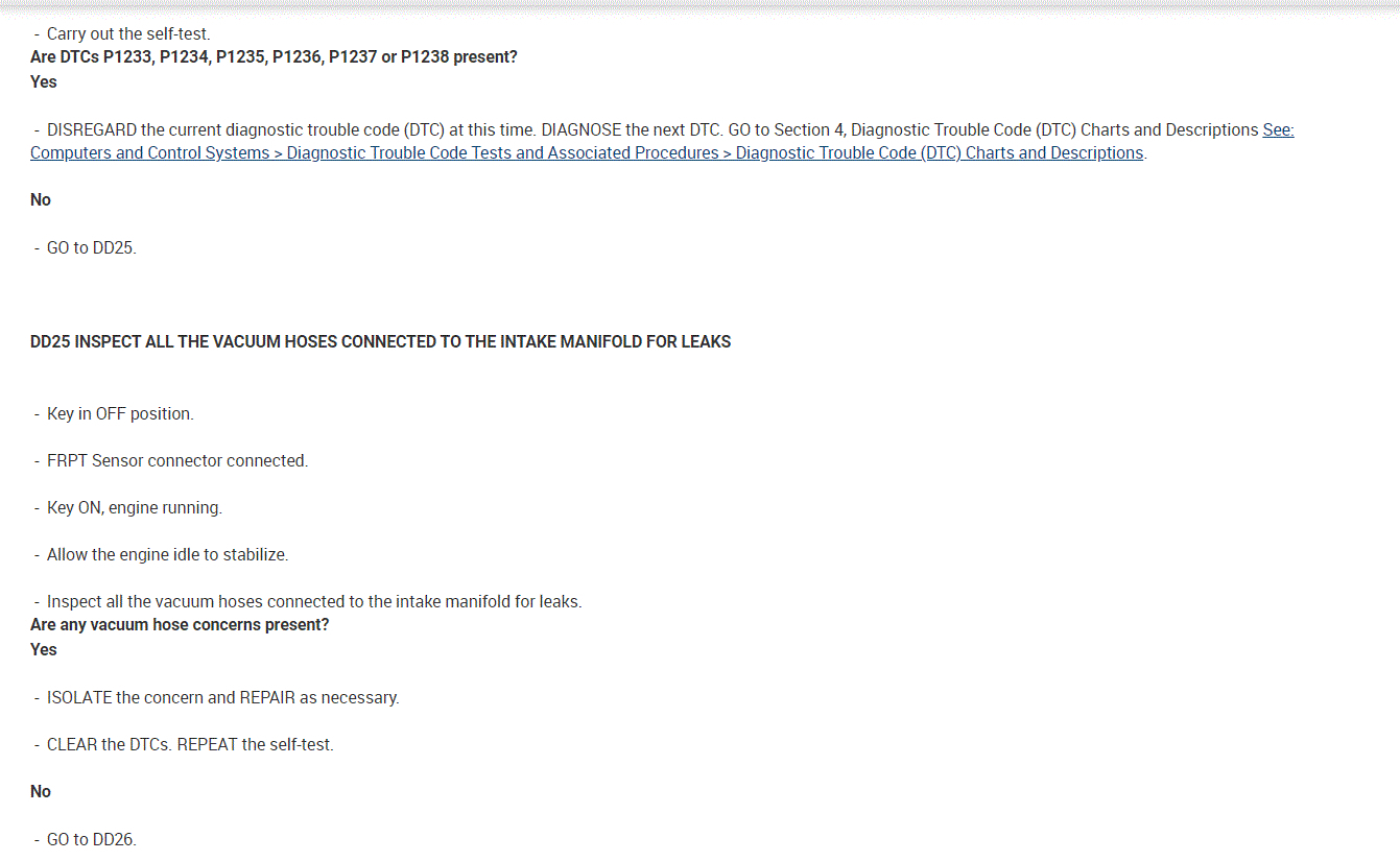

Here is what to do: First, we need to check for vacuum leaks. If there is one, it could be the cause of the lean fuel mixture.
Here is a link that explains how it's done. Let's do this first before we move on to anything different.
Let me know what you find. Your findings will determine what we check next or if there is a need to check anything else.

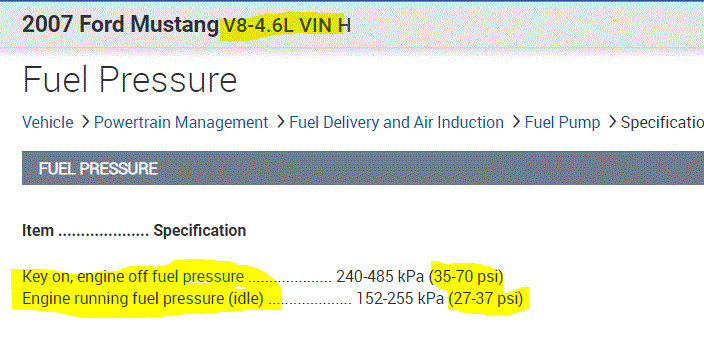

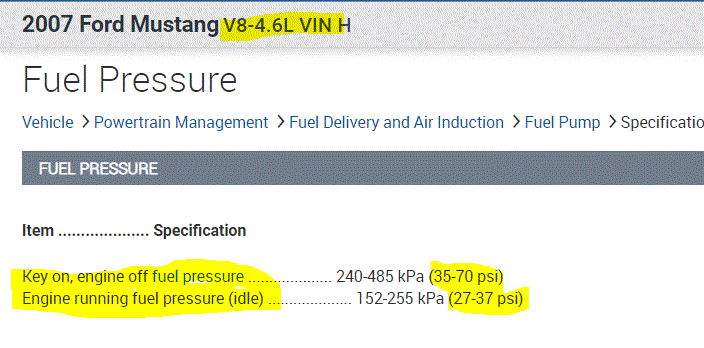

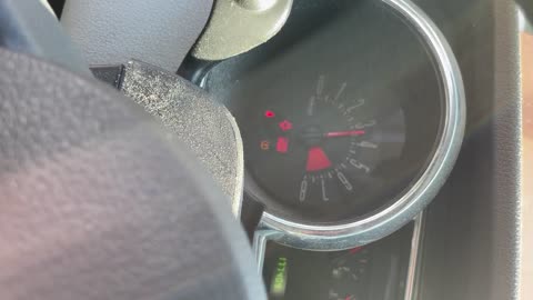

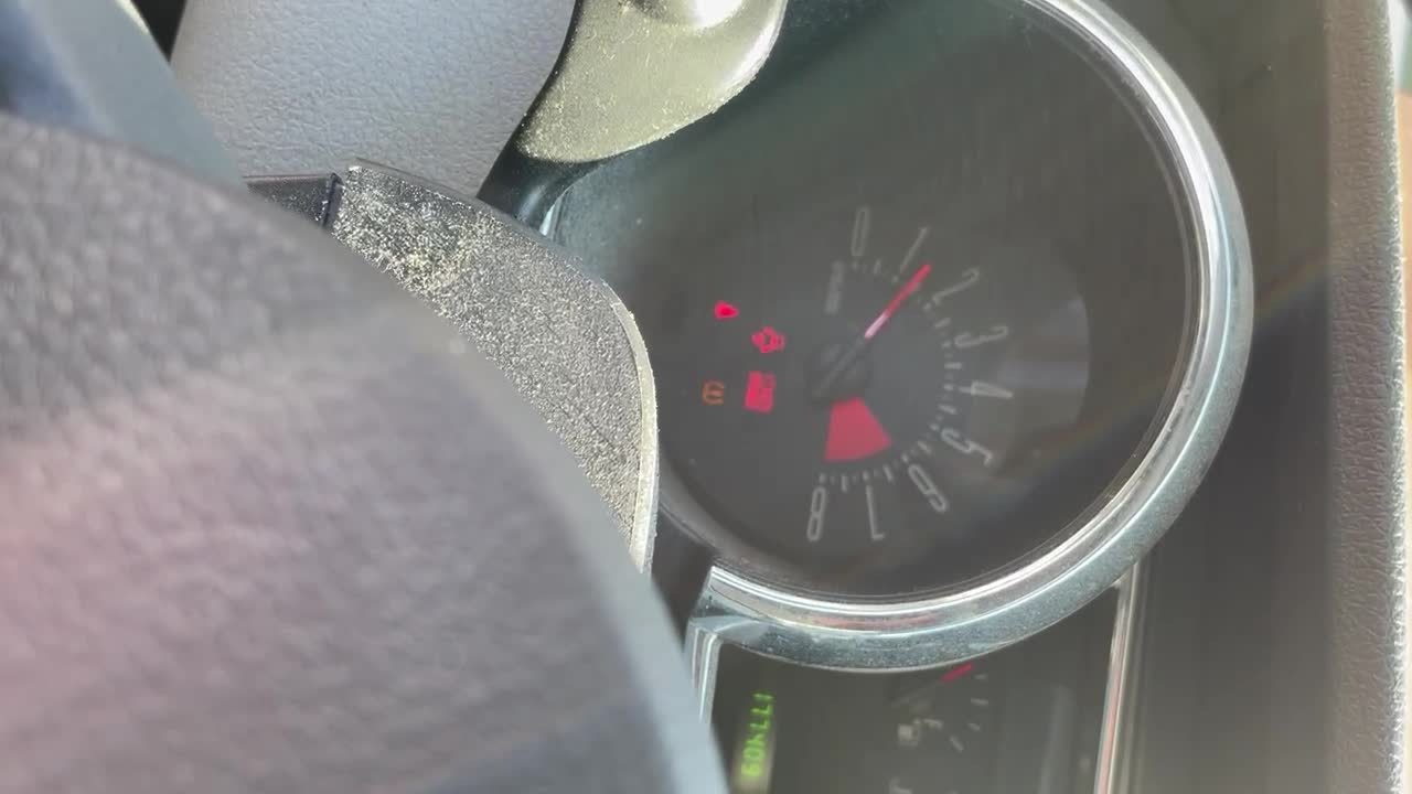

Do you know what the normal range fuel pressure should be? No vacuum leaks. Changed coil and code is gone, but it still does this in the video when i hit the pedal fully, not gradually, as if it's out of fuel.
Oct 4, 2021 at 10:10 AM
  • 110,194 POSTS
As far as the fuel pressure, I attached the manufacturer's specs below. Note I highlighted a 4.6L V8. If you have the 5.4L, the pressure is the same.

If possible, place the phone near the exhaust so I can clearly hear what it's doing when you hit the throttle. I tried listening several times, but the sound quality on a computer limits what I hear. Hopefully, placing the recorder closer to the exhaust will help.
I also noticed the engine has some slight backfires when the throttle was released. Are there exhaust leaks? If so, are they before the catalytic converters?

Pressure via obd is 39 with engine off, when running also 38-39, fuel rail pressure volts 2.74.
Oct 5, 2021 at 2:32 PM

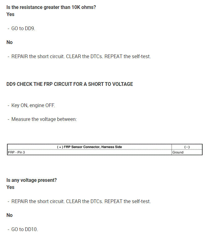

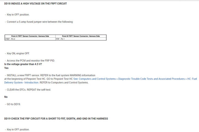

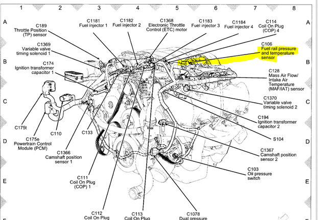

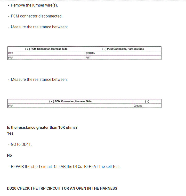

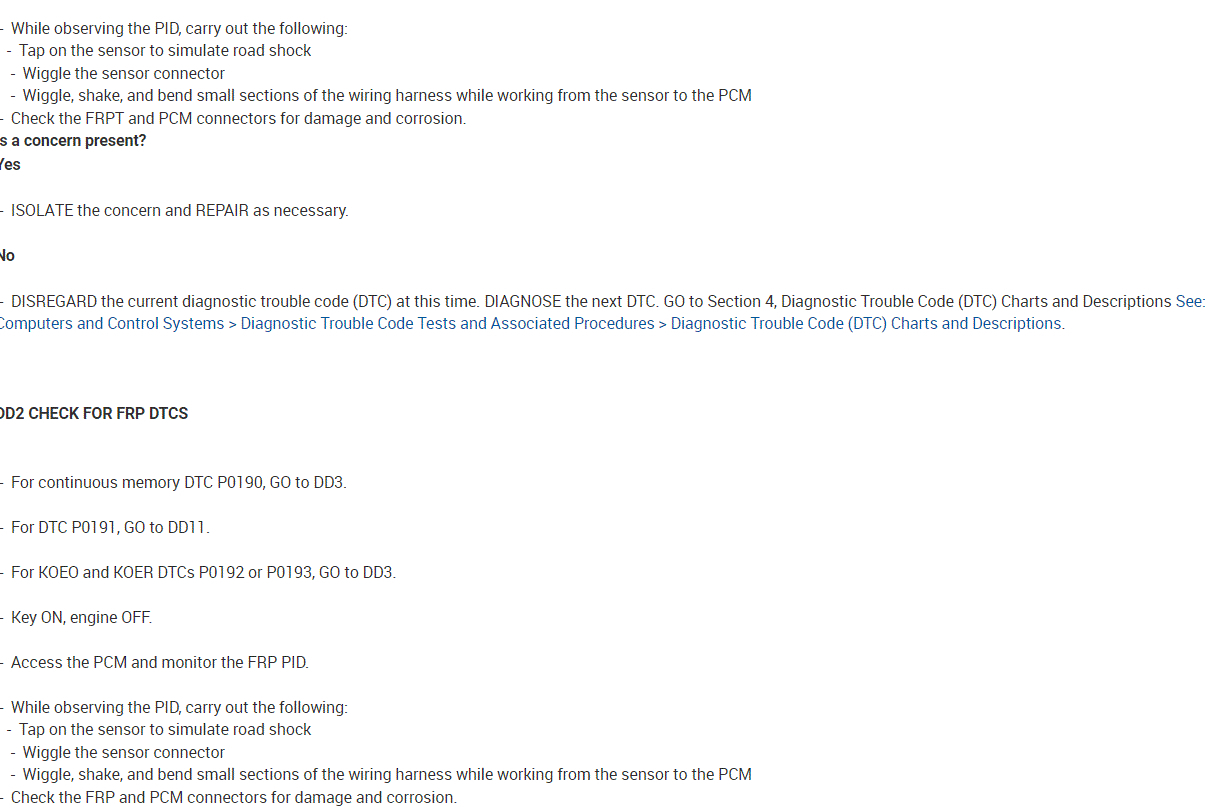

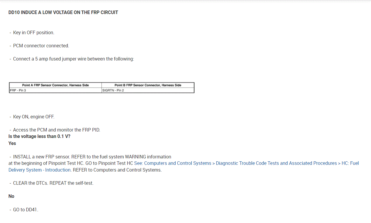

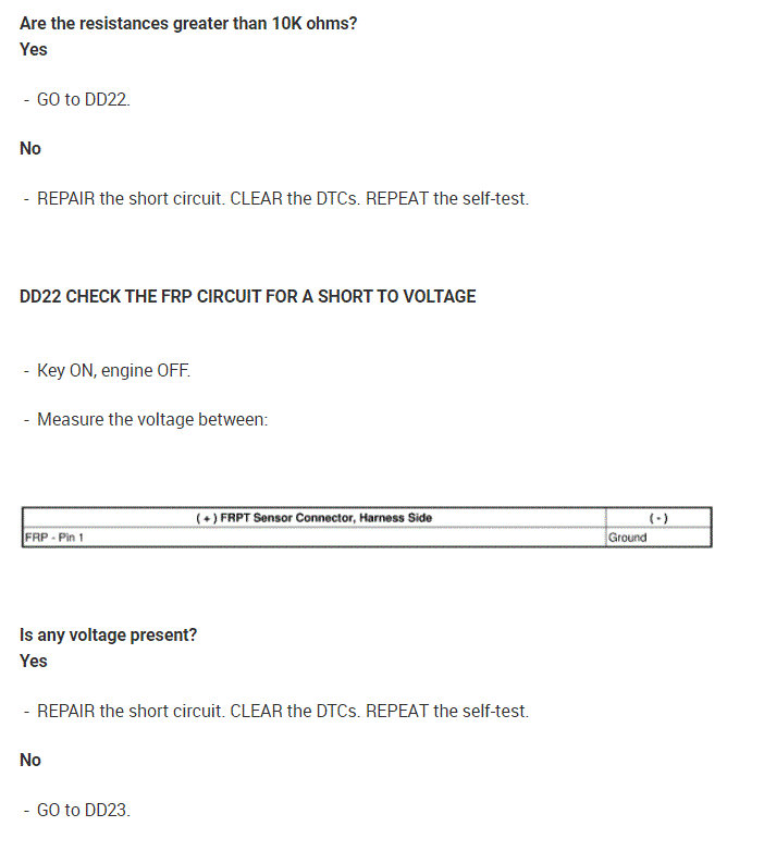

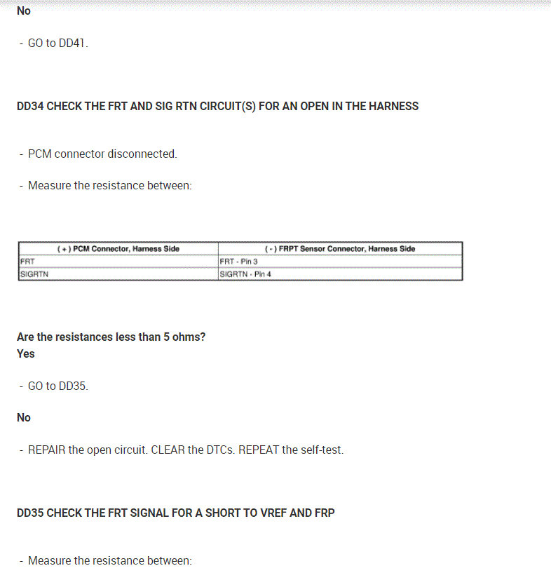

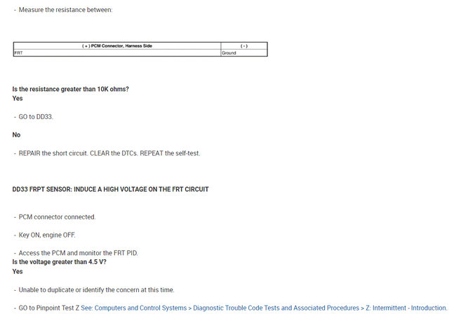

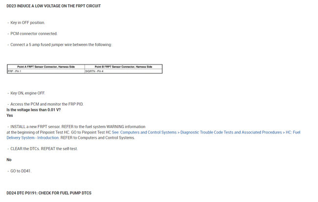

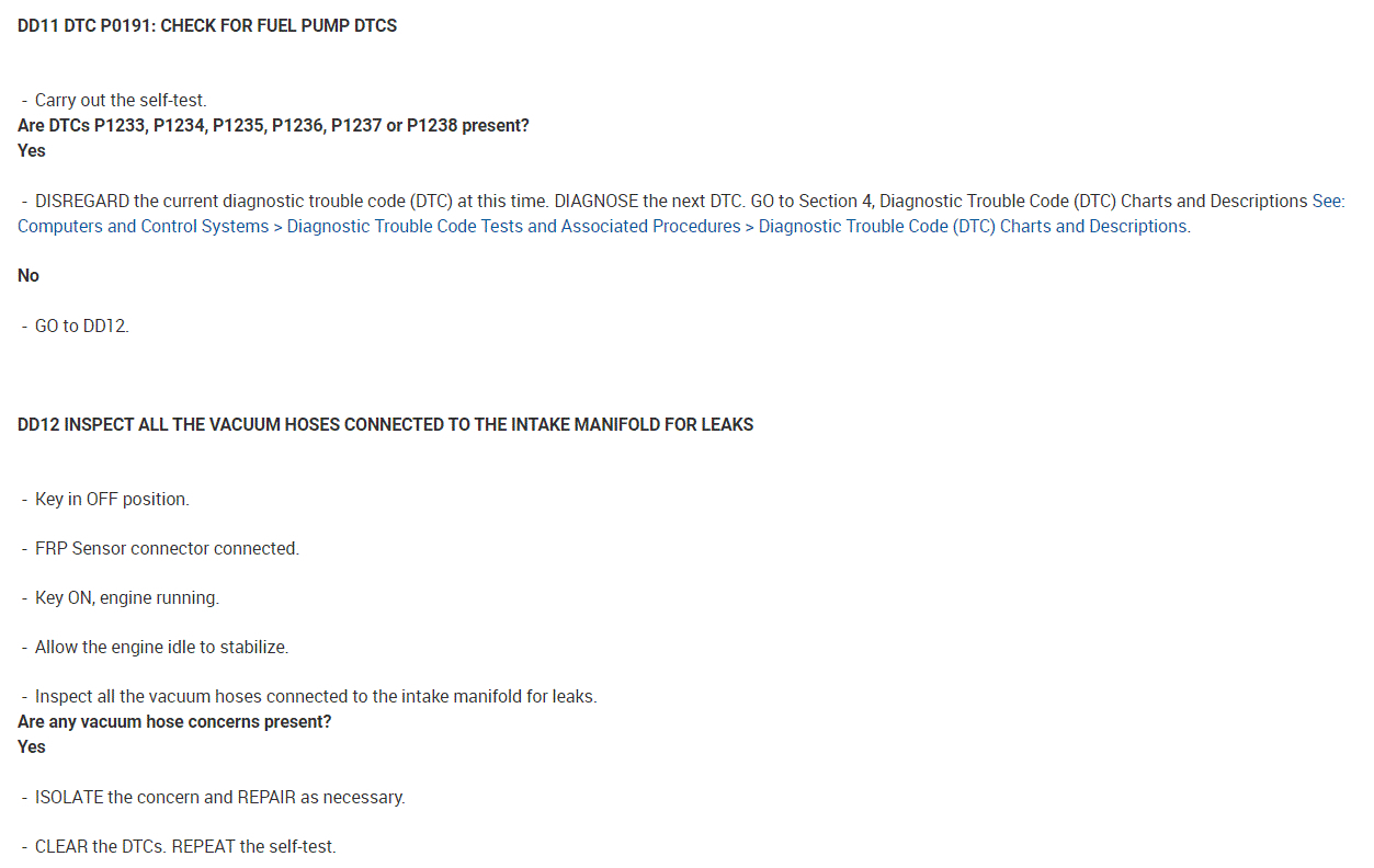

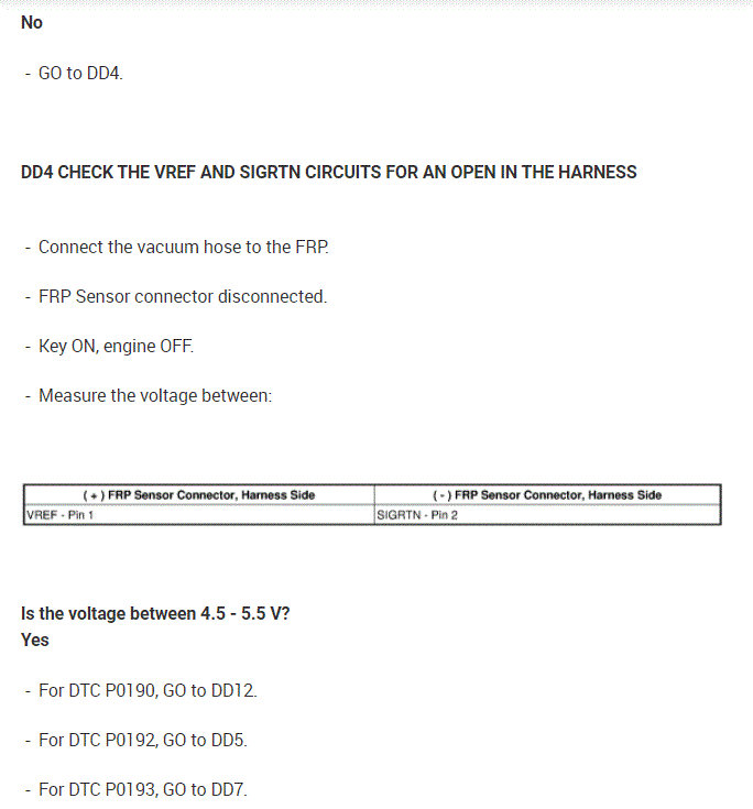

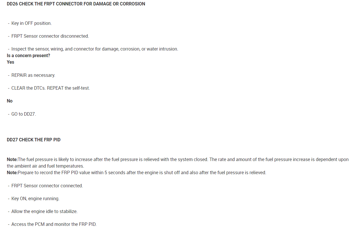

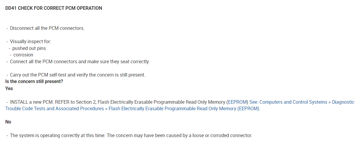

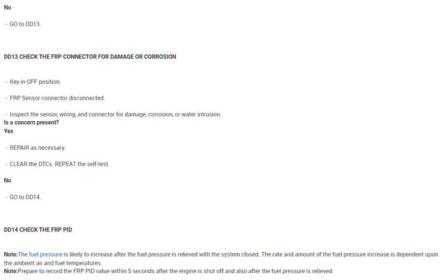

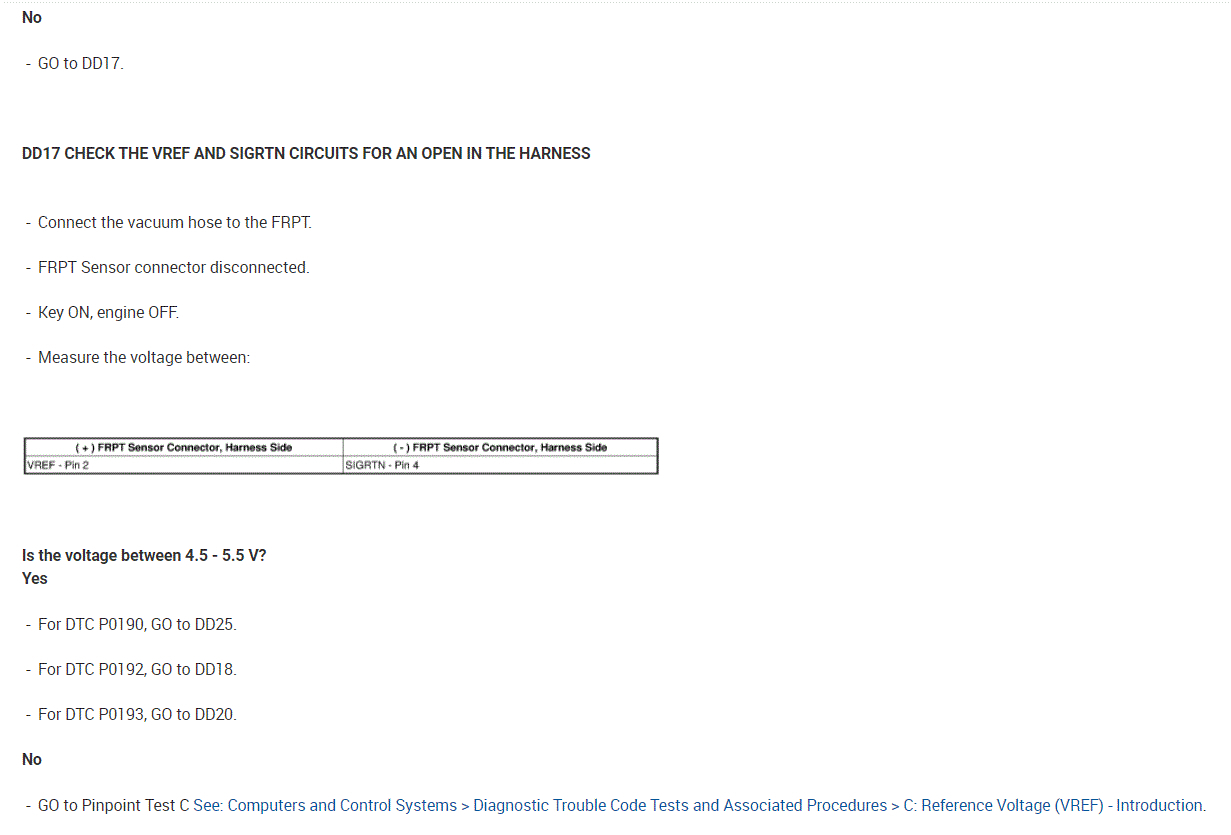

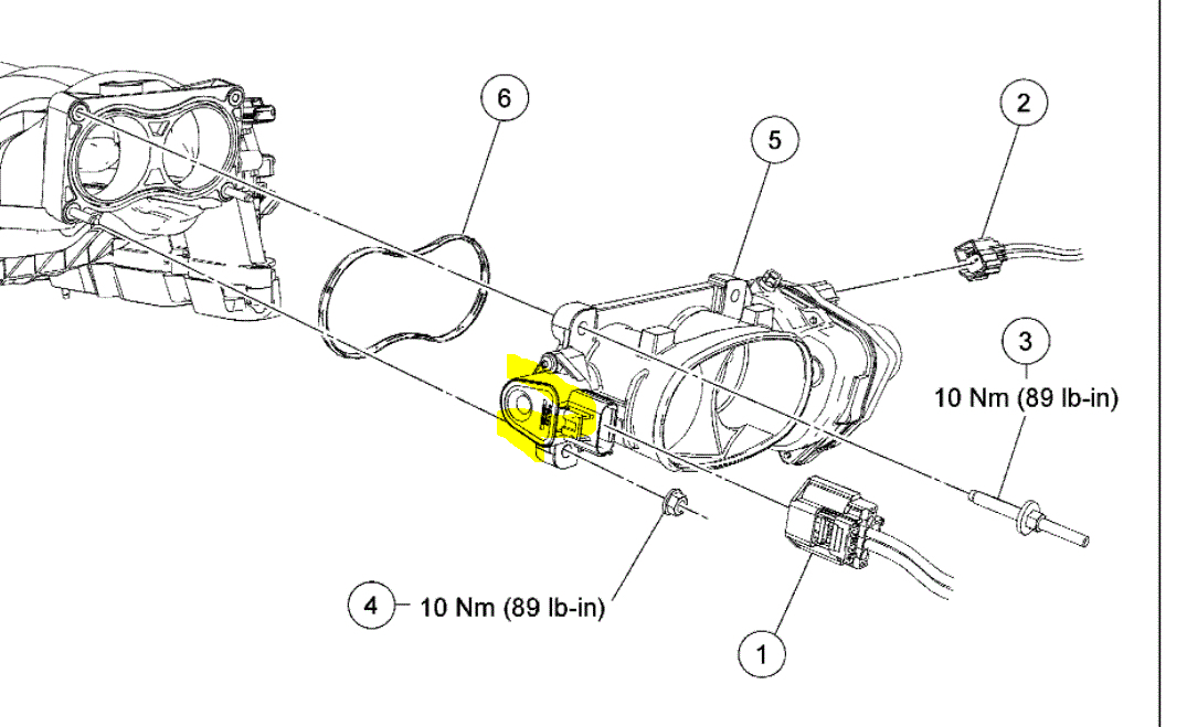

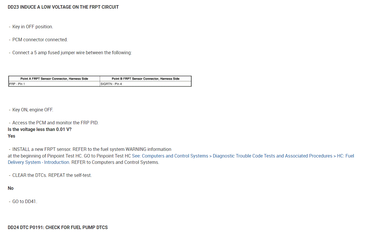

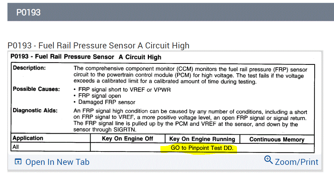

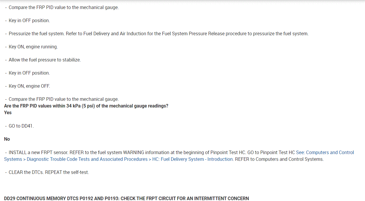

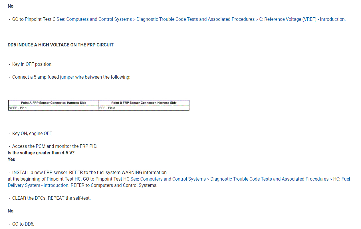

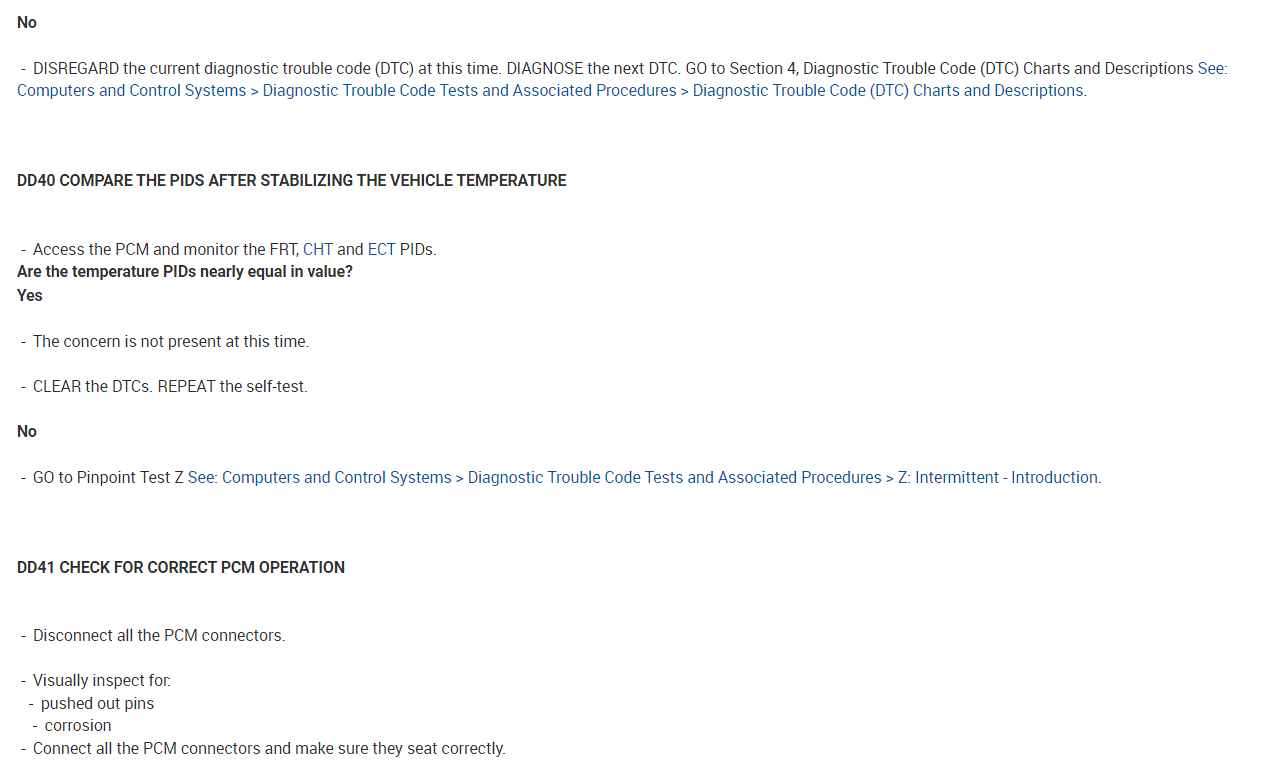

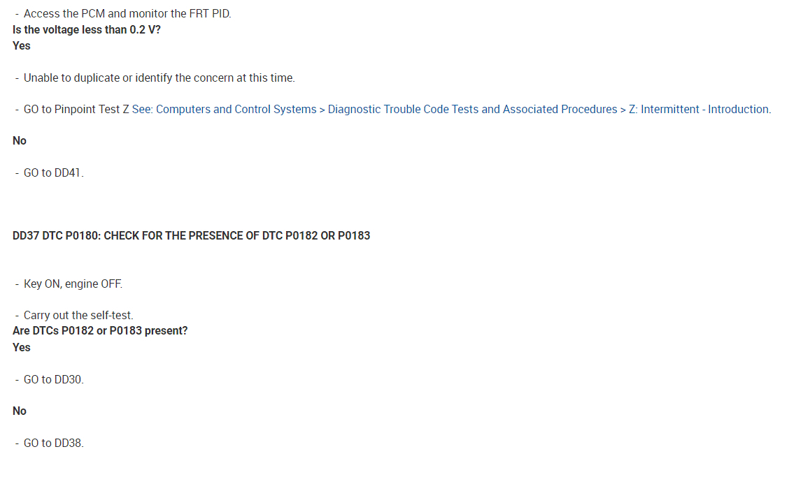

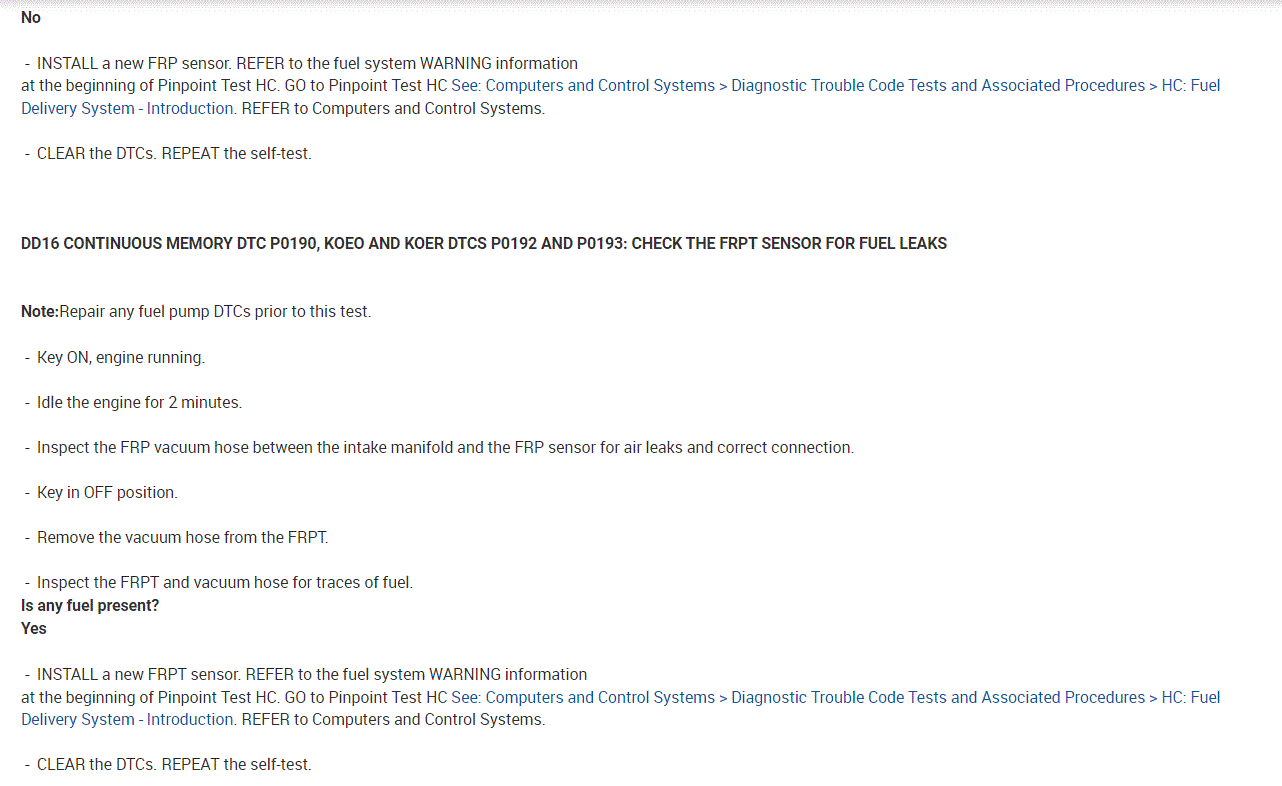

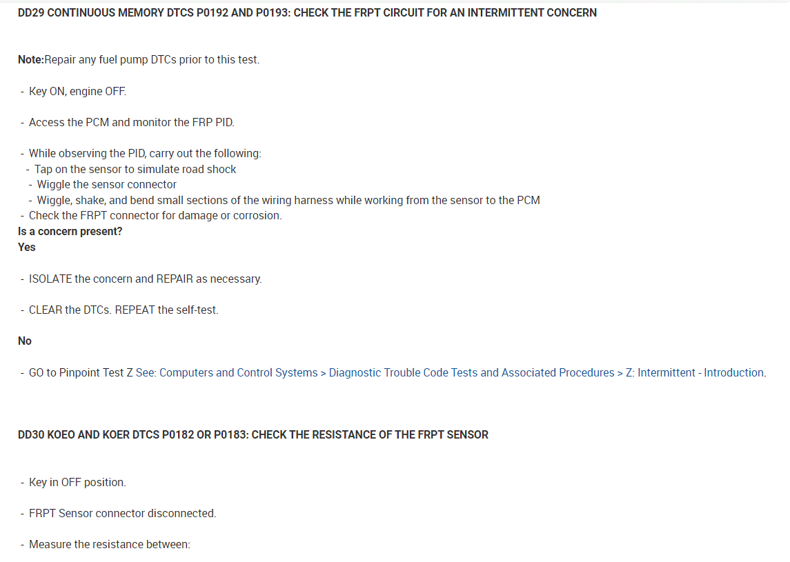

  • 110,194 POSTS
The pressure is perfect. Also, the FRPS voltage seems fine as well.

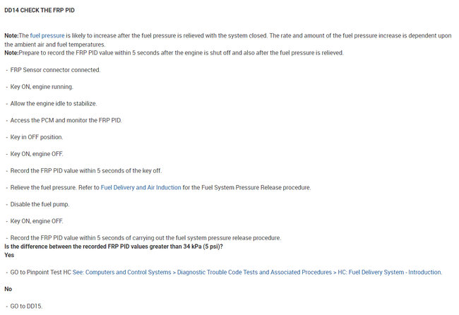

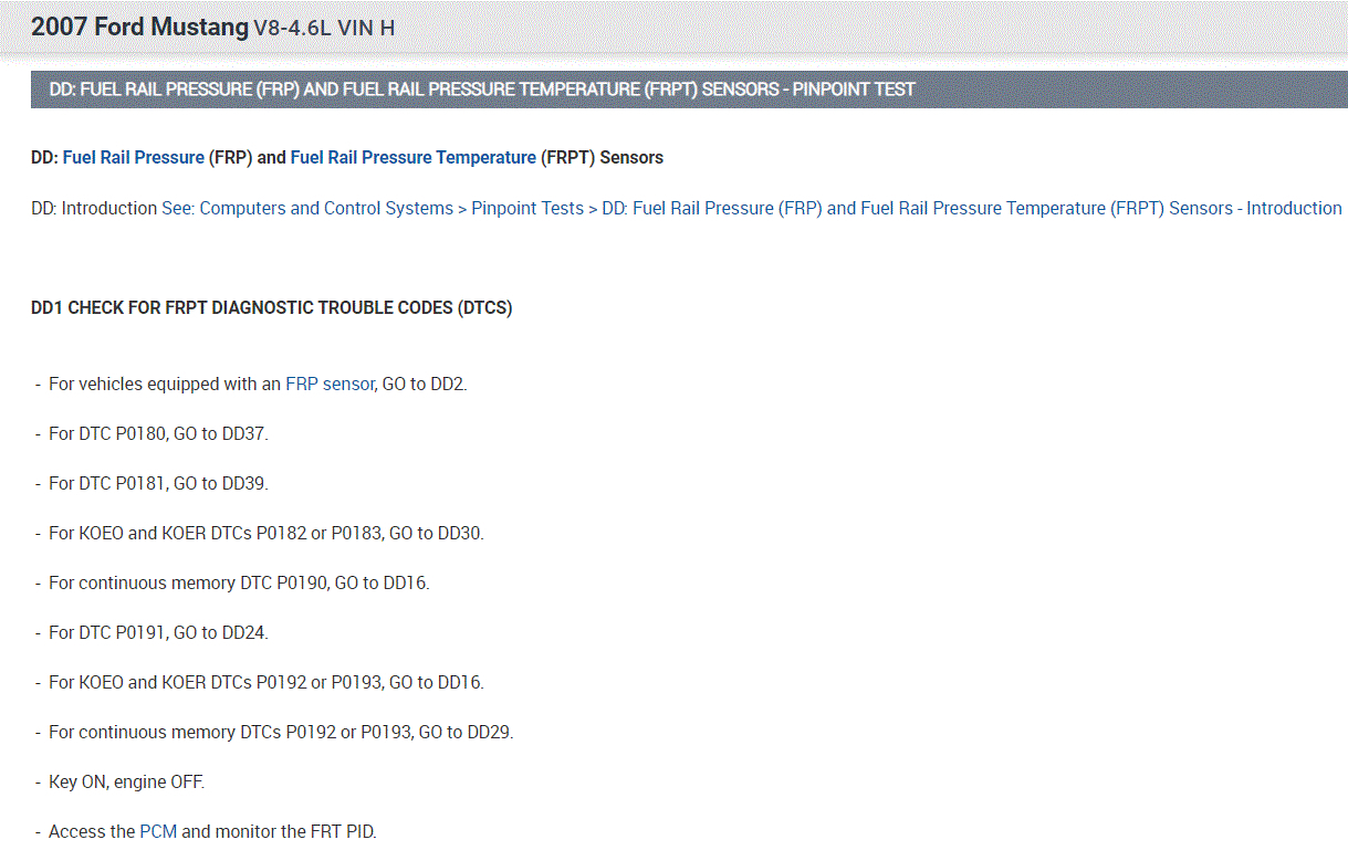

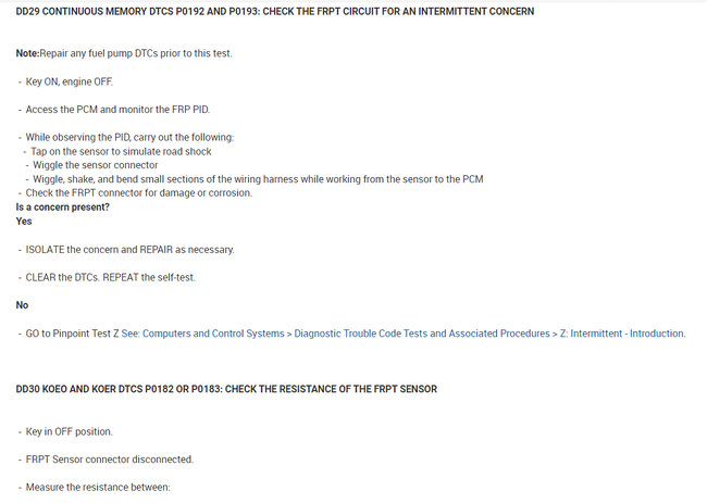

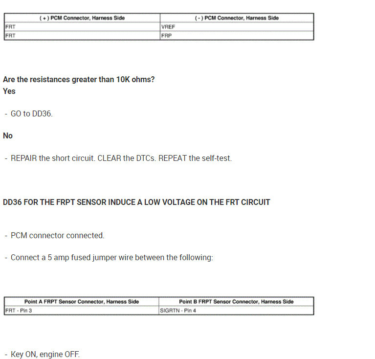

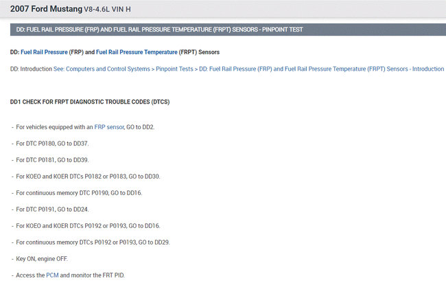

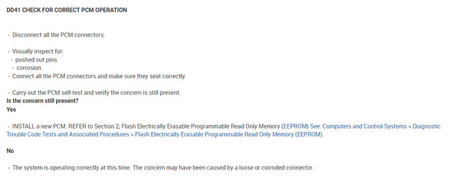

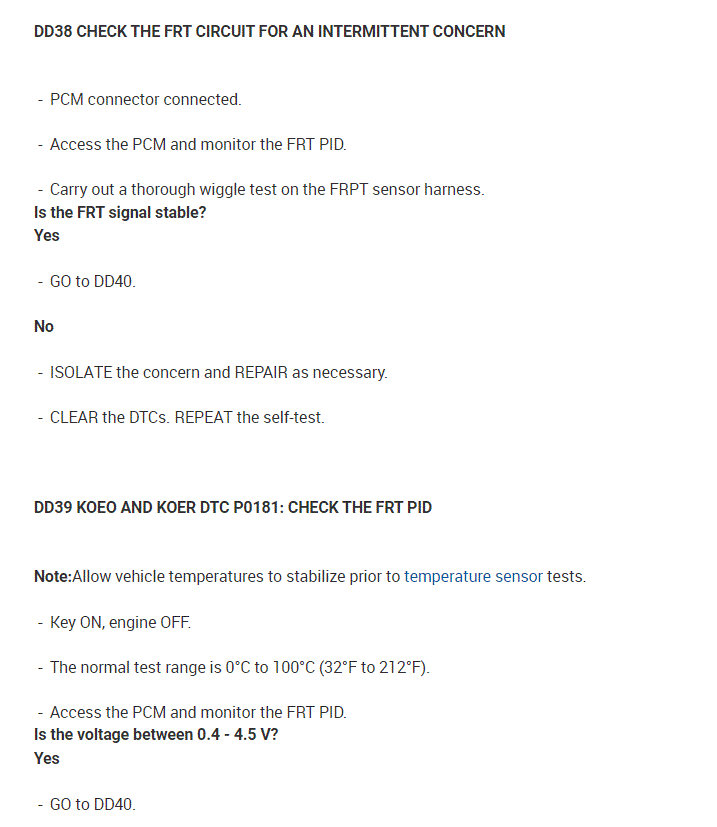

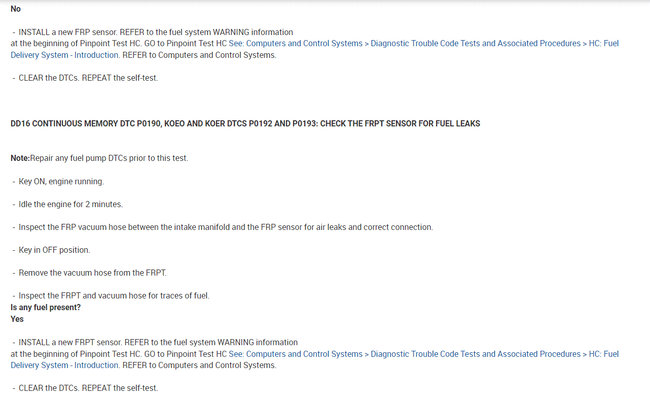

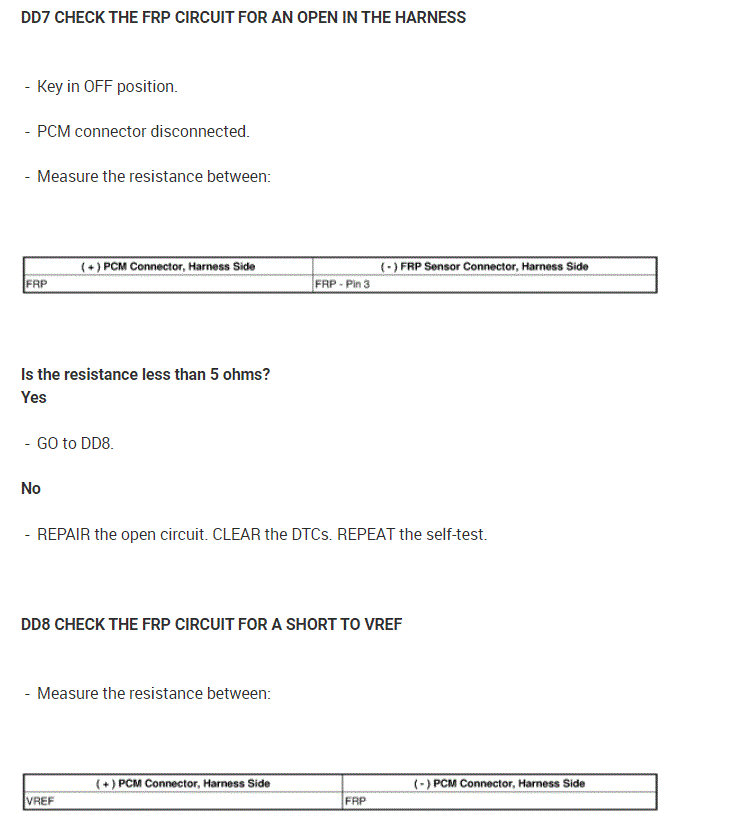

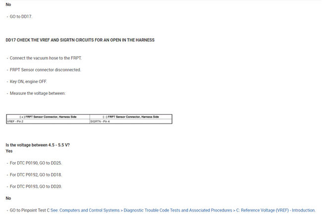

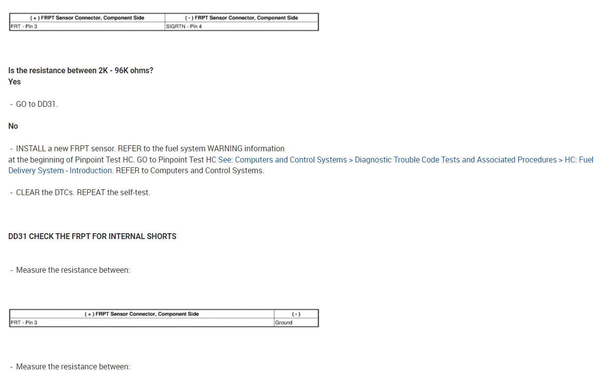

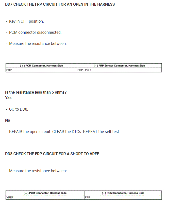

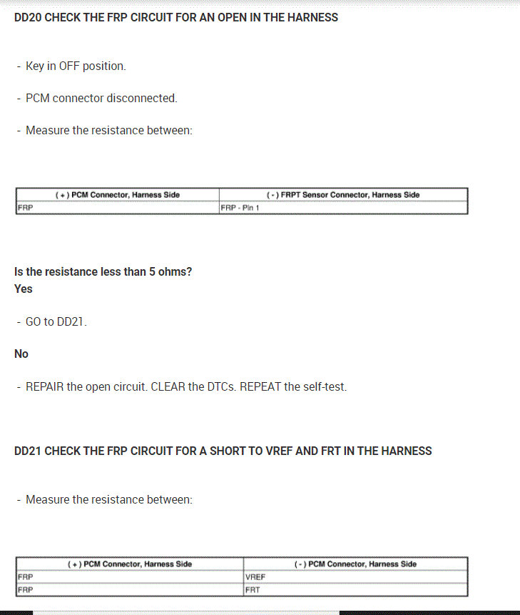

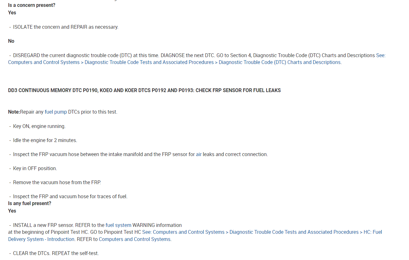

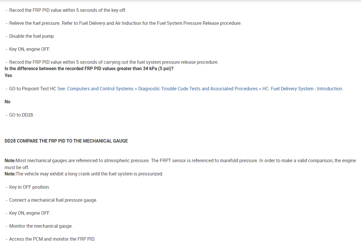

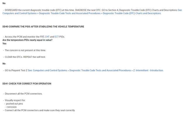

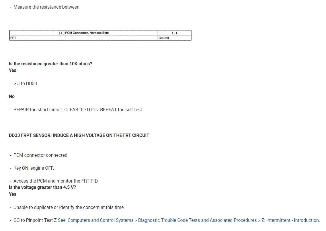

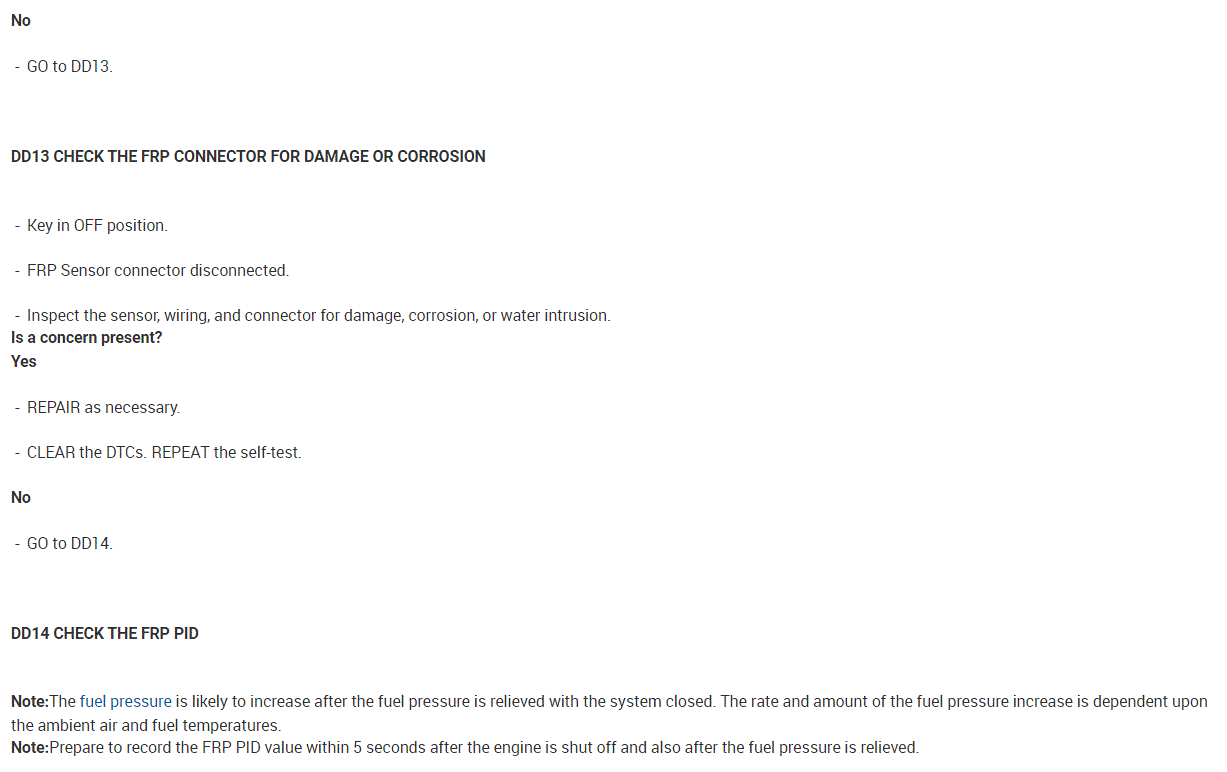

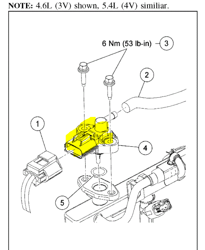

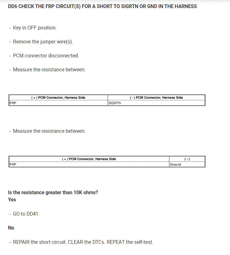

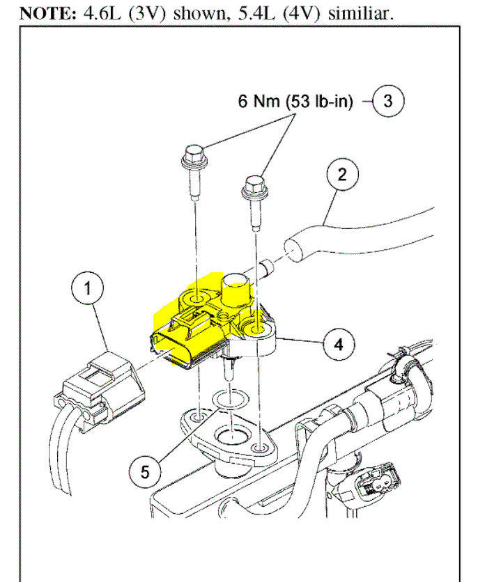

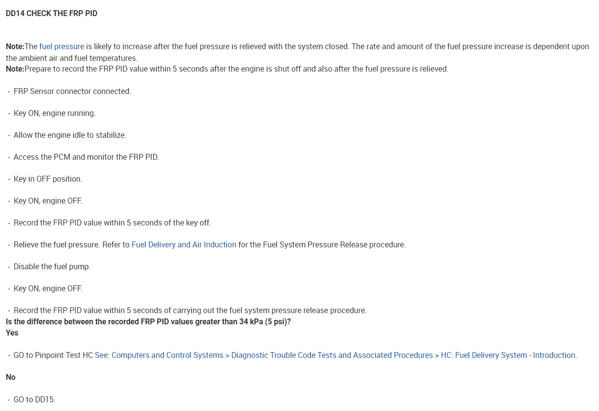

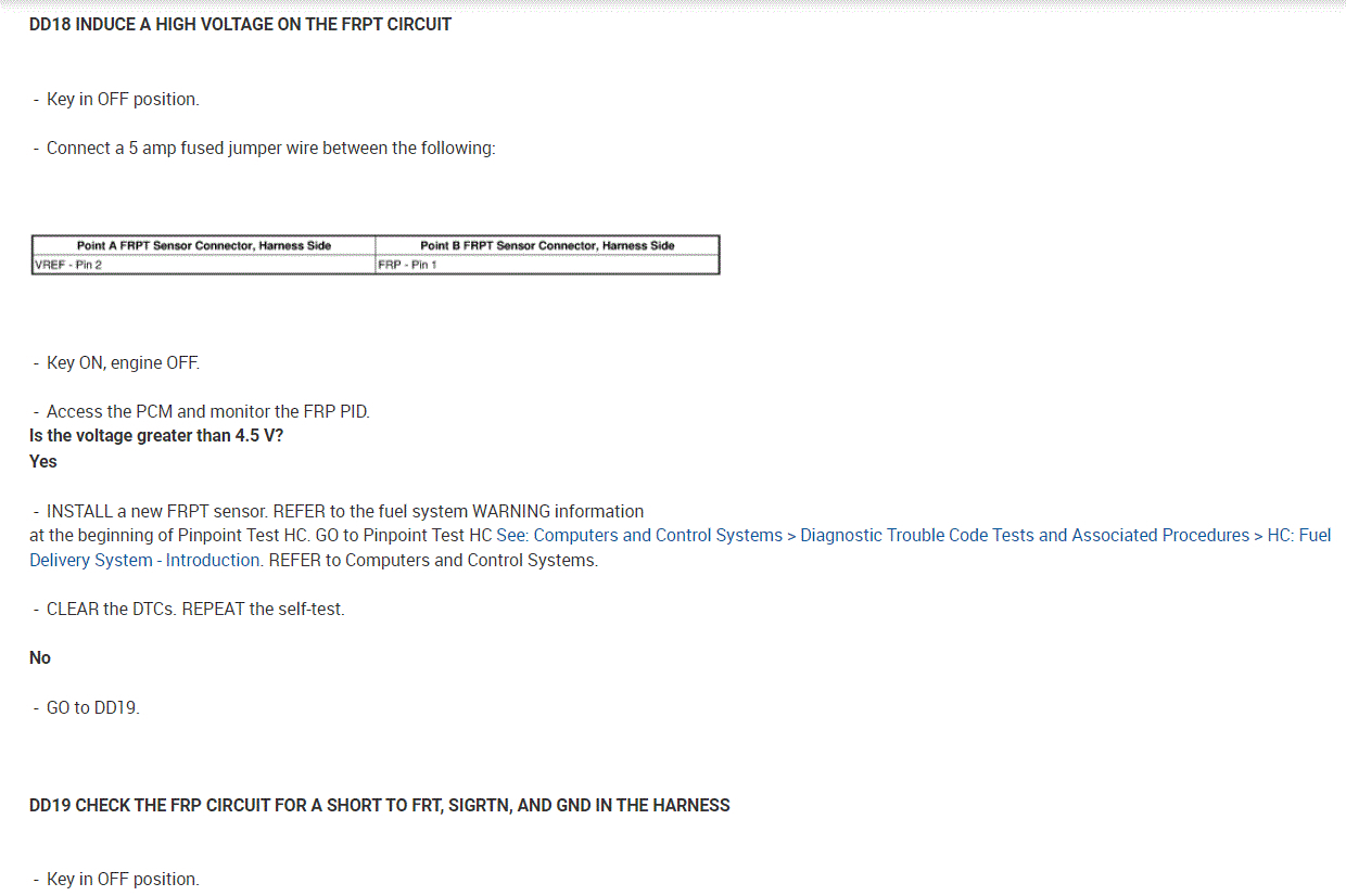

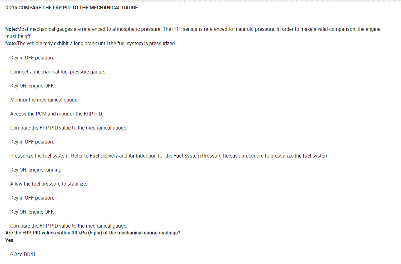

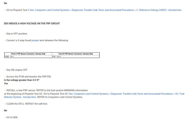

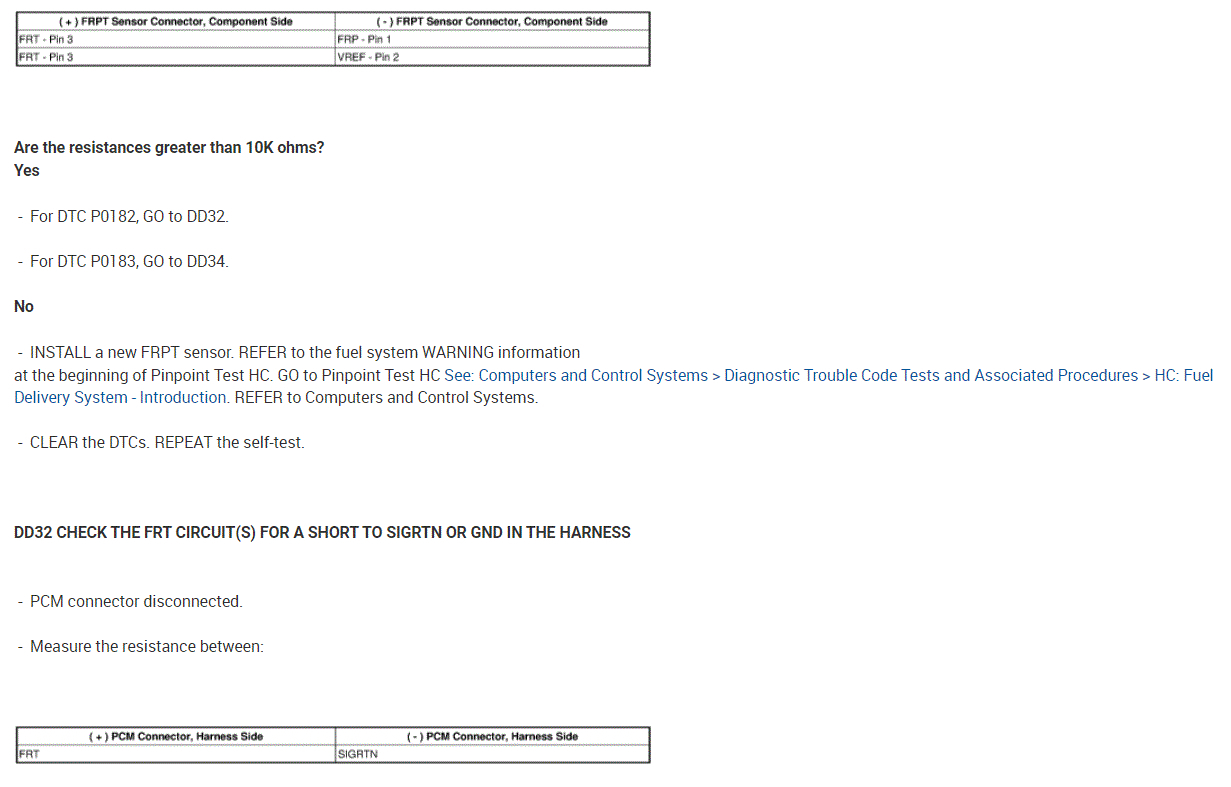

I dug around a little with regards to the P0193. See pic 1 below. If you look at pics 2 and 3, they provide the location of the FRPS.
In pic 1, the manual indicates to use pinpoint test DD. I attached that diagnostic list for you as well. However, it is very extensive. Take a look at it and let me know if this is something you feel comfortable doing.
Before attempting the diagnostics, make sure the connector at the sensor is in good condition, free of damage and corrosion.
Let me know,
Oct 5, 2021 at 7:21 PM

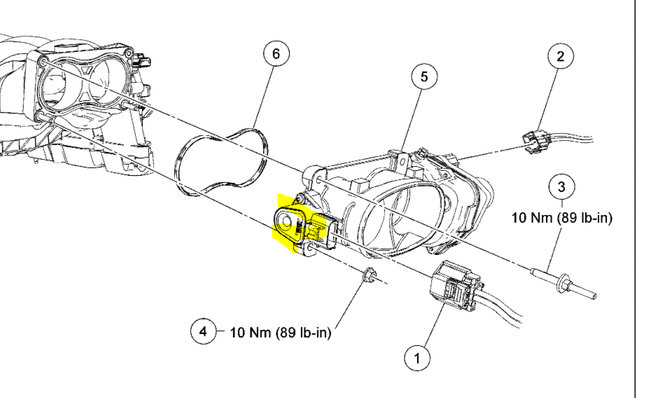

The idle air control valve (IAC) is responsible for maintaining the idle speed. However, based on what you experience, it could be an engine vacuum leak as well.
If you look below, I attached a pic of the IAC. Make sure the connection is good and make sure the throttle plate fully closes. If everything looks good, try servicing the IAC. Here is a link explaining how it's done:
https://www.2carpros.com/articles/idle-air-control-valve-service
Before jumping right into the IAC, confirm there are no vacuum leaks. If nothing is found, then go to the IAC.
See pic below.

Thanks. The picture is showing the throttle body and the sensor on the left of it. I cleaned the throttle body but the sensor on the left is not something that can be cleaned, I removed it and it looks like a flathead screw driver that just sits inside this sensor, I also cleaned the map, so far so good, thanks.

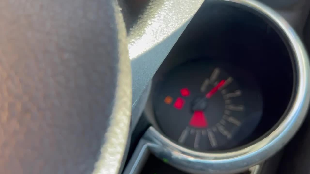

Only thing that is strange is the way it revs, i have not owned a GT in a while but i assume this isn't right. In the video you see how the RPMs respond? If i floor the pedal all of a sudden i get this hesitation, more in the exhaust than the engine itself. If i slowly hit the gas pedal and steady it does not happen, possibly the fuel filter? And no issues while driving, i just cannot floor it while driving yet before i change the clutch as its shot.
Oct 13, 2021 at 8:42 AM
  • 110,194 POSTS
It sounds like a misfire. Have you gotten any misfire codes?

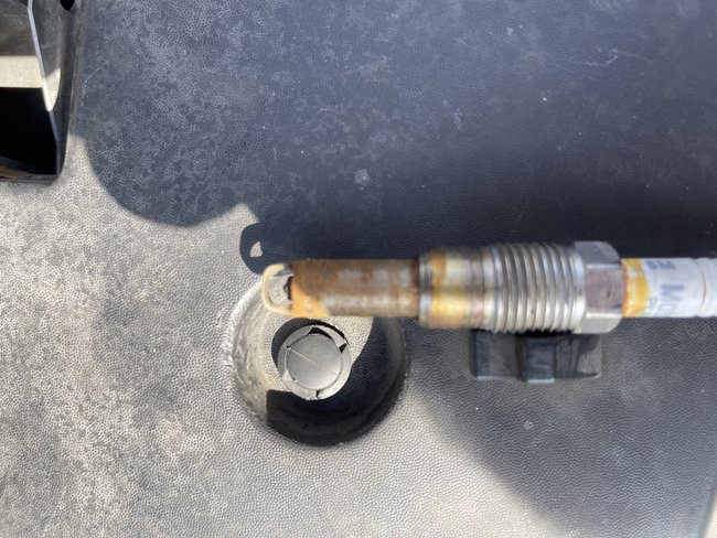

DIVIDES
  • 903 POSTS

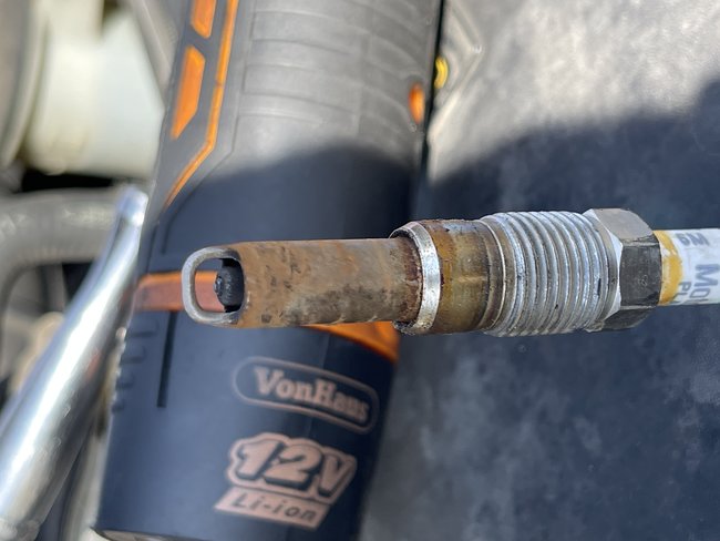

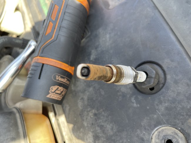

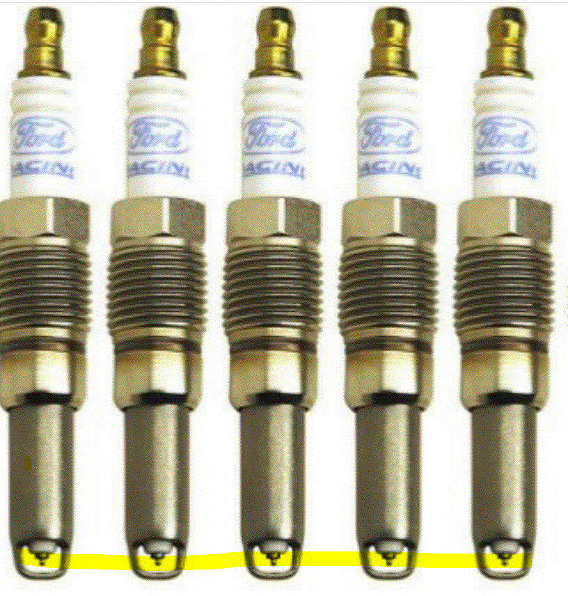

Never seen these plugs before and don't even know what to look for.
Oct 14, 2021 at 8:50 AM
  • 110,194 POSTS

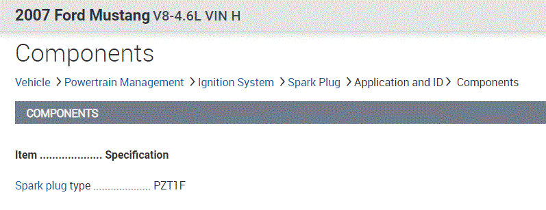

I think you're right. They look original. There is basically nothing left to the electrode. I looked in my manual and attached the plug specs below. Also, I found a pic of what the electrode should look like.
These aren't going to be cheap. If I had to guess, I would think they will be around 10.00 a plug or more. I could be wrong. Let me know what the part number is on the plug and if it matches pic 1 below. Pic 2 shows what they should look like.
This could have a lot to do with the issue you're having.

After changing the plugs with OEM Motorcraft, the difference is unreal! Thanks guys
Oct 15, 2021 at 10:03 AM
  • 110,194 POSTS
Wow! That sounds perfect now. Did you get the power back in addition to the response?
The plugs you showed me have to be original. I've never seen a spark plug that worn out. LOL Now, the ignition can burn the fuel when you nail the throttle. That's what it needed. The poor thing was misfiring with all the fuel introduced.
