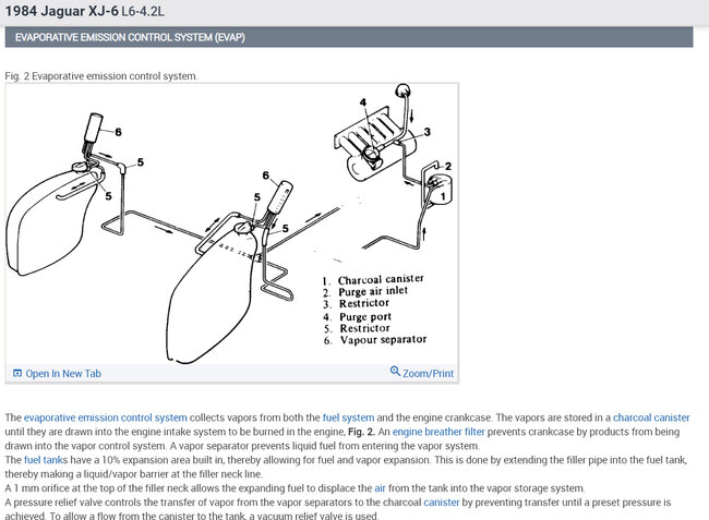

When reassembling the injection system, I encountered a problem. I forgot to mark two vacuum hoses!
1. A very long hose was connected to the fuel regulator at the front of the fuel rail. I did not mark the other end.
2. Also, two short (maybe 4"?) vacuum hoses were connected to the two fittings on the "Cold Start Injector" (Orange in color) mounted on the underside of the fuel rail. One of the hose fittings was on the side of the unit and the other was on the bottom of the fitting. One of the short hoses was still connected to the “side” fitting and the other end of that same hose ran down to the side of the block. The other short hose on that injector was just hanging there. I had not marked that end of the short hose either.
Back to the long hose connected to the fuel regulator; when I stretched it out to its full length trying to find to where it might connect, I saw that it was just long enough to connect to the bottom fitting of the cold start injector.
I then removed that short hose and pushed the long hose from the regulator in its place.
The car did start again (see my above paragraph mentioning 2,000 RPMs) but bogged down after five minutes running when I lowered the rpm to idle.

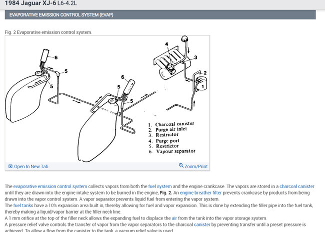

Can you please upload some pictures of what you are talking about? This is the only vacuum line diagram they show us for this old of a car. My dad had Jaguars so I think I can help you get it running. Does the engine have spark? will it run on starting fluid? Please go over these guides to help us fix the problem:
https://www.2carpros.com/articles/car-not-running-advanced
and
https://www.2carpros.com/articles/how-to-check-for-ignition-spark
